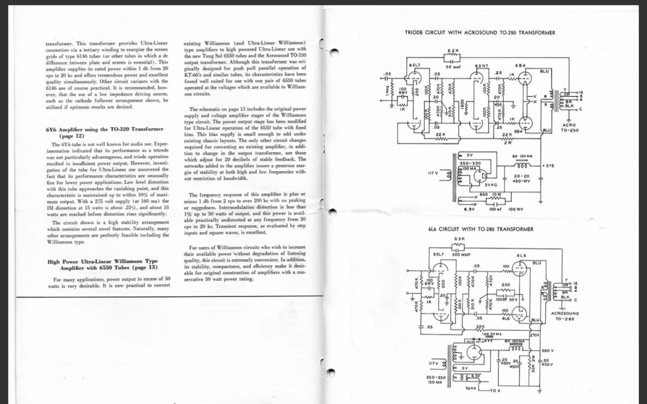

Hello, I'd like to undertake the construction of my third diy amplifier.
Can someone provides me schematics of a truly hi-fi (really wide frequency response, lowest possible distortion (minimum 1%) at high wattage, minimum 10W output, 6L6 triode tube for output stage in SE or PP and triode (6SL7, 6SN7 ecc.) tubes for preampfification stage?
I have found an old schematic from the Acrosound company but the amplifier seems a modification of the one ("Triode circuit with Acrosound T250 transformer) offered in its catalogue (see page 7 in the catalogue) - any thoughts about the two schematics would be very appreciated).
Moreover I was wondering if one should use a phono preamplifier are two preampfification stages in the power amplifier redundant? (so another requirement would be a single preampfification stage like the schematic "6L6 circuit with TO280 transformer" always at page 7").

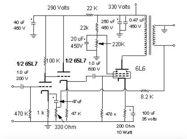

I really don't like that phase splitter style...
Easy design and simple build if going triode output stage. 6SL7 concertina feeding 6L6 should work fine, although the 12AT7 will have an easier time driving the output grids. No need for three stages if going triode with a strong enough driver.

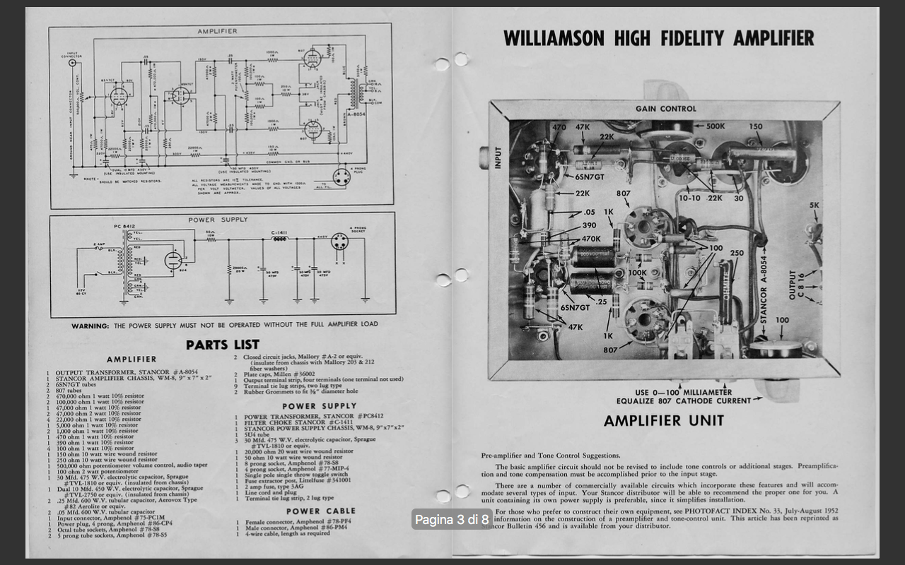

Thank you so much for the reply. I'm intended to built a mono unit so no problem referring to the 5Y3 issue.
Regarding the Phono preampfification stage I'd like to try to build it in the same chassis (not binding), also no problem if I have to use a filter choke.
Would you be so kind to provide me the model of the amp you are suggesting so I can try to search more information about it (i.e. frequency response, distortion, if it is in PP or SE configuration, etc.)?
Well, its sort of a generic push pull design, as old as tubes themselves. As far as distortion, it should be well under 1% at average listening levels. Frequency response is consistently flat through the audio band.
Looking at specific names, a Williamson type or Mullard 5-20 might fit your needs, but since they are iconic and generic amps, there are thousands of variations on them. It's easy enough to swap out different output tubes for the most part, so long as the relevant supporting circuitry is modified to suit, and the front end is up to par.

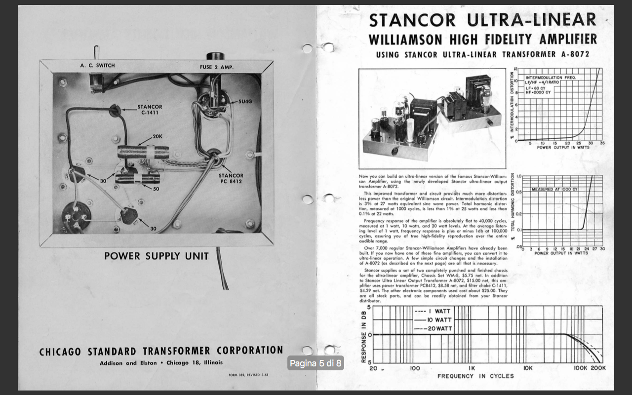

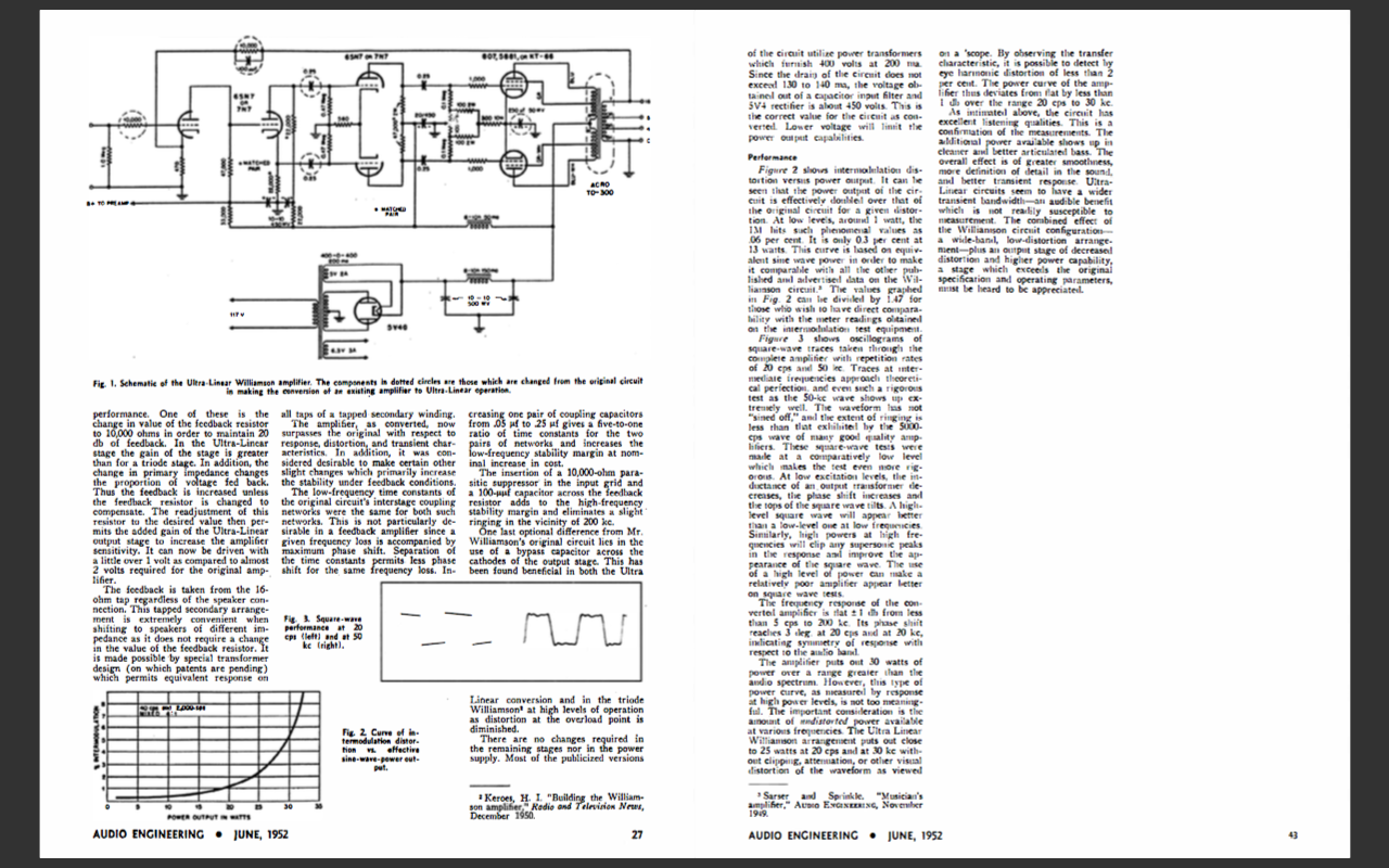

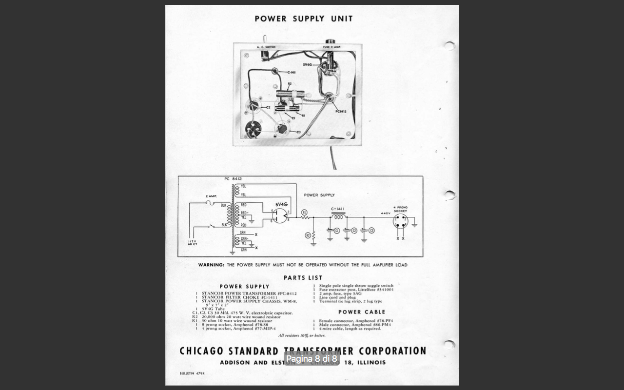

Very interesting suggestion to look at the Williamson or Mullard 5-20 typology! Found some very interesting schematics especially of the Williamson (all triode). What do you think? Probably I should avoid the ones with the cut of 50k in the frequency response.
What modifications need to be done in order to use 6L6 with the "Stancor ultra linear" schematic on page 7?
Moreover why there are two jacks between the power output tubes?

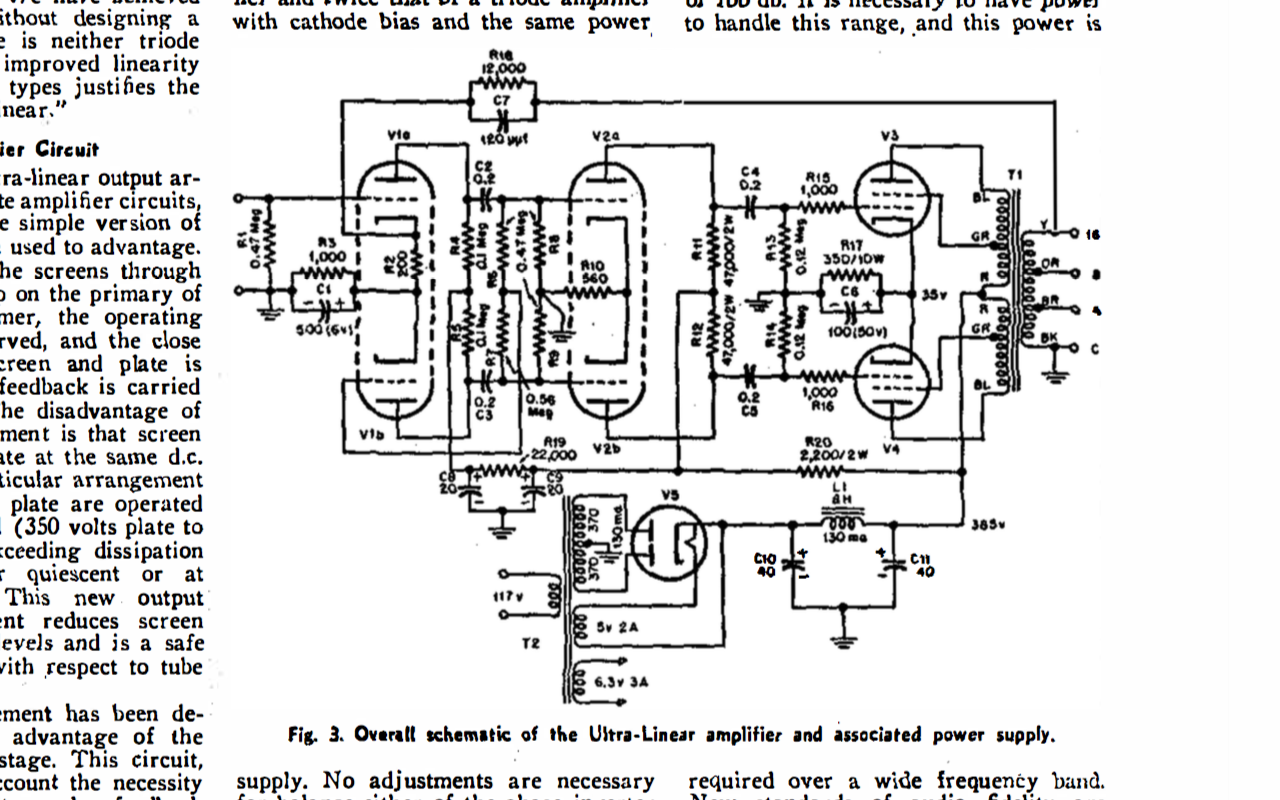

I agree with Lingwendil (post #2):
This is why I do not like "serial phase splitting" (or whatever it is named).
The second grid (bottom grid in the schematic) of the 6SL7 is driven by 470k and 560k in parallel.
I estimate the gain of the 6SL7 triodes at about 35.
The plate to grid capacitance is about 1.5pF, and with the miller effect, about 50pF.
The 470k and 560k resistors and the 75 pf has a -3dB bandwidth of about 12 kHz (on the second 6SL7 grid).
That means for frequencies at and above 12kHz, the amp is effectively Single Ended.
Negative feedback does not fix that. The lower grid is always driven by -3 dB at 12kHz (and worse as frequencies go above that).

I also managed to find the article about the first schematic I posted in this topic. I just tested the PSU and the B+ produced (955V) does not match the B+ indicated (385V). Am I missing something? 😕
Full article here.

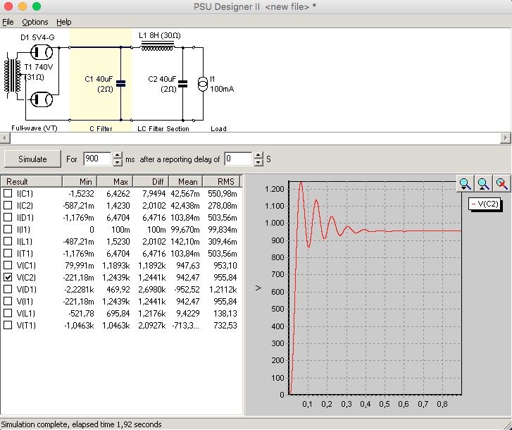

PSUDII wants the voltage from each HV phase to center tap, you input 740 which would be the end to end voltage, not end to center tap. Halve that to 370v (like in the schematic) and you should be fine.
