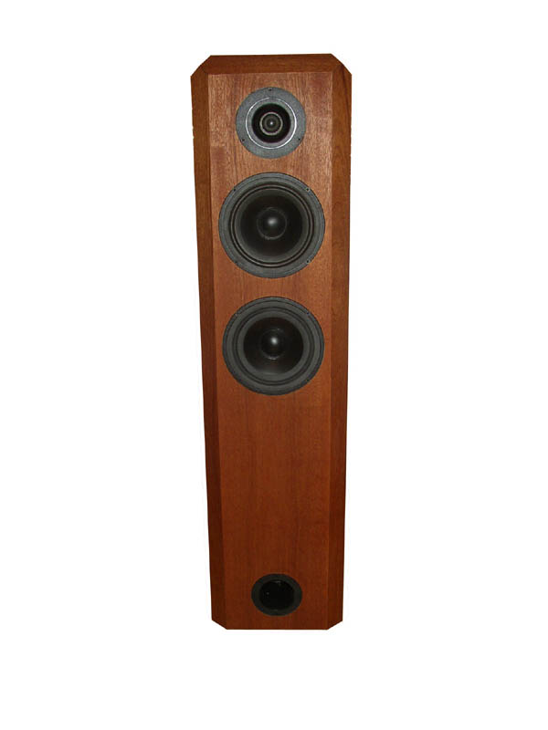

I've just "finished" my 3-way speakers. Here are some details:
-Bass: 6,5" Seas P17Rex in a bassreflex box (29Hz), 28 litres
-Mid: 6,5" Seas P17Rex in a closed box, 11 litres
-Treble: Dynaudio D-28.
xo freq: 400Hz and 5000Hz, first order.
Here is a picture of the speaker.
