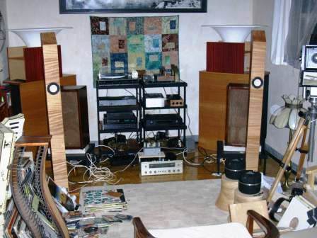

Hi Erwin,
“my room is around 12x20x10 feet, bloomy base with my 2 way speakers.”
It may be a result of room acoustics. With a single driver speakers you will get less bass so it will be less bloomy, but my BLH didn’t sound right until I put enough bass traps in the room.
http://www.imagebam.com/image/1bcae422397887
Marek
Marek

“is single driver is also a full range driver?”
In my case single Lowther is used unrestricted and delivers almost full range.
“ps: nice driver you got there. sorry for my ignorant. is that commercial speaker or diy? what that setup call? nice setup”
It is DIY, totally home made with handyman tools. I despise the commercialism on DIY forum. I only made one pair and broke the mold. I call the “setup”: back loaded, round, metal powder composite horn. It is a rather extreme approach. I do not want to dilute your thread with details, but if you ask I will gladly answer all questions.
Thanks for the complement.
Marek
Marek

Mssr. Bob Brines' technique perfectly nails it -- using PC-based digital EQ, starting with the inverse of the frequency response curve, then additional tweaks for baffle step and room bounce, whatever personal tweaks.
When heard at their best, they are amazing and have a unique, surreal 3D "palpability." It's not imaging, it's a different quality because you can hear it in mono. Someday, when I have a big room and a setup like Bob's, I will have Lowthers again.
Originally posted by chrisb Having heard a variety of [Lowthers] at several audio shows over the past 7yrs, I can definitely say that ...They are famously "love em or hate 'em" , and can certainly be hard to get right.
