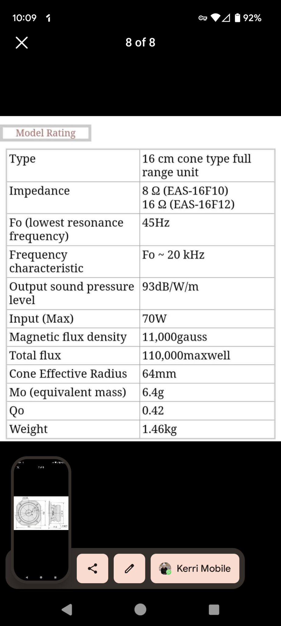

I can pick these up cheap, but was wondering what kind of enclosure would suit or even if they are any good! Steve
Unknown to me, but they look deacent.
Nice big magnet with vented pole piece.
Fo/Qo ratio is good for bass-reflex box.
