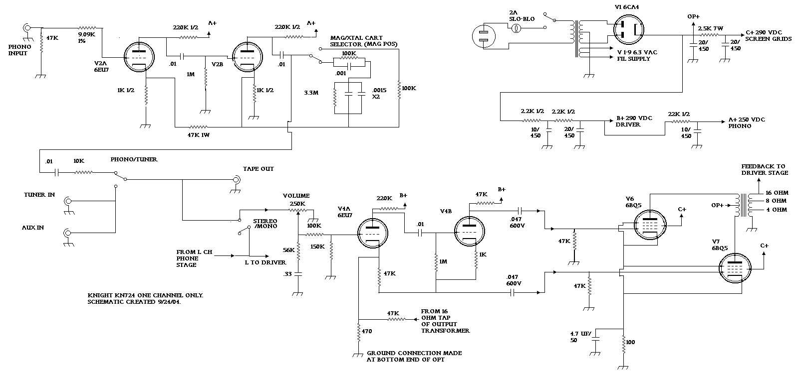

Howdy, planet10! This one's a KN924, which is PP 6BQ5. It seems there were a few variations on the circuit, among different models, so I'm just going to replace the components with the same values for now. What makes them tricky is, the schematics seem to be kinda hard to find, plus since many were kits assembled by the buyer, you never really "know" if they used the right values. 😕 😉 All my electrolytics are 10 uF for instance, in the multi-section cans, and I just don't know if that was intentional, or done for cost concerns. I hooked it up for awhile yesterday, & it actually sounds pretty good, so at least I know it works, before I get my paws inside. 😀

Before you go at it, you should sketch out the circuit. It will likely be a variation of one of a few schemes. A good place to start http://www.diyaudio.com/forums/tubes-valves/120307-very-low-output-knight-kn928-amp-6.html
Attached is a map i grabbed from one of the links.
