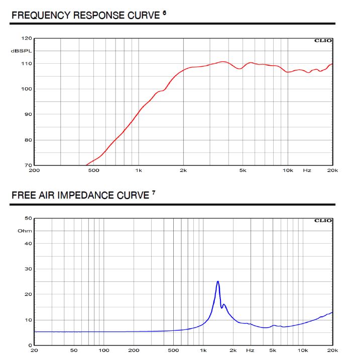

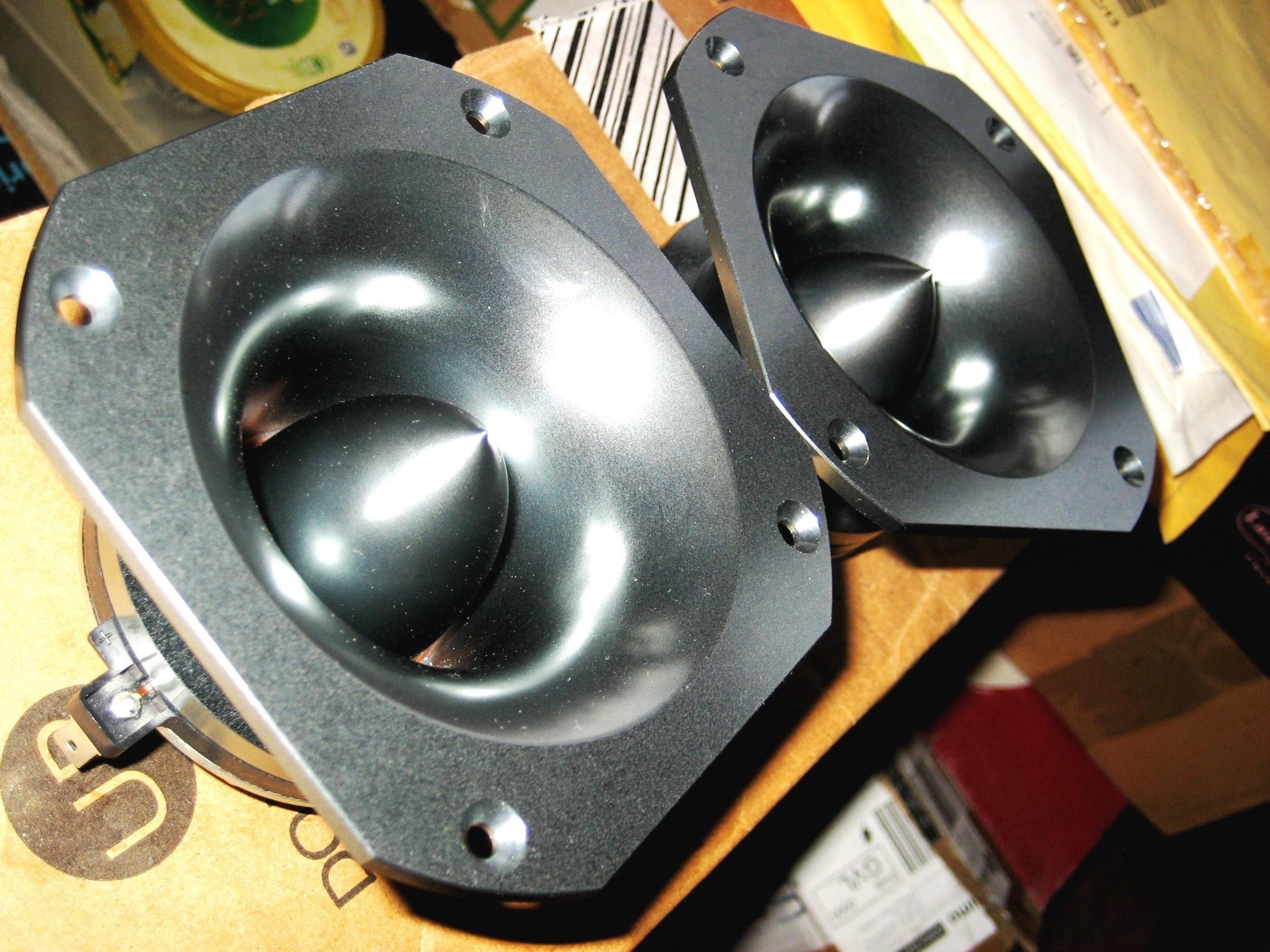

I need your advice about this CIARE tweeter, thanks.
Bad Request
This link works.
The highs have a downward tilt on-axis, this should be more so off-axis. If it does sound forward it should be equalisable. There may be some diffraction but could be nothing to worry about. The challenge might be where to cross.
