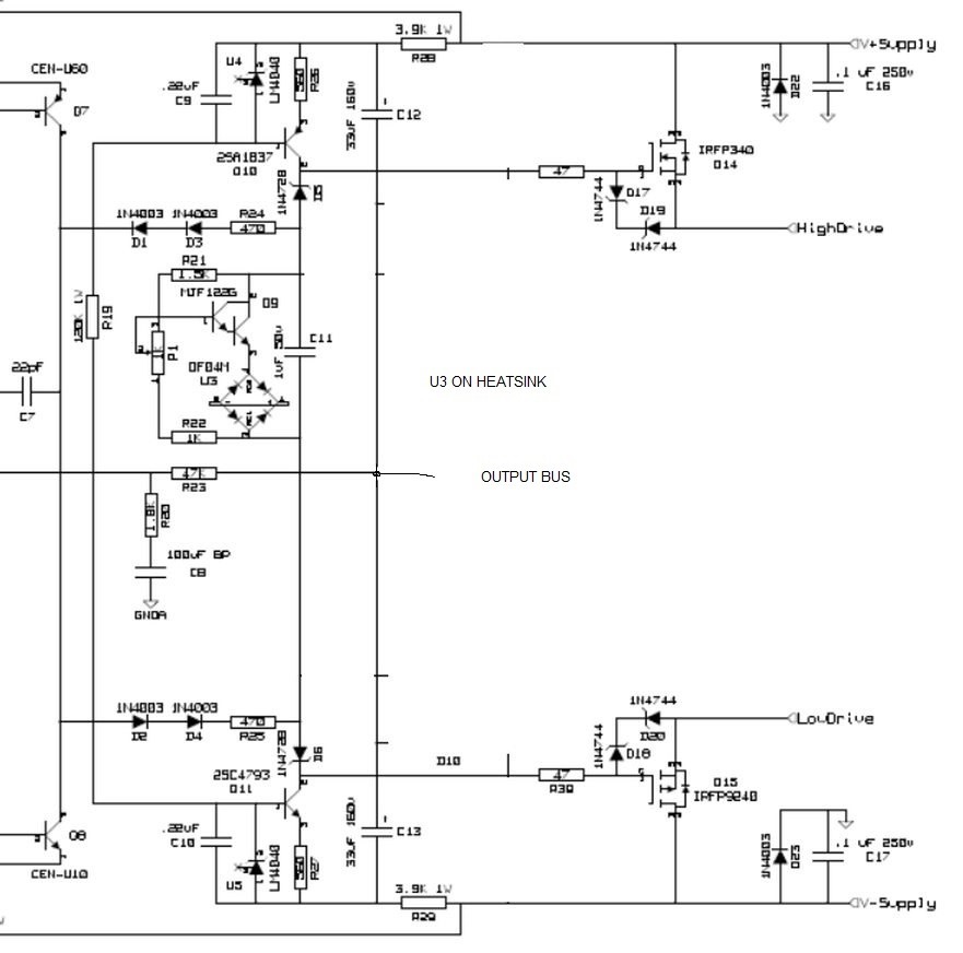

Attached is part of a schematic of an amp we designed in the 2000s. It shows the bias ladder used to obtain near rail to rail swing with HEXFET drivers. I deleted the complex output protection system. The bias ladder consists of 2 boot strapped current sources which can go beyond rails , zeners for the HEXFET gate threshold drop, and a VBE for output stage bias. The U3 bridge mounted on heat sink to sense temp. It doesn't need to be a bridge, but it was easier to mount to heat sink than round diodes. The "high drive" and "low drive" just went to the bases of 6 bipolar output pairs. Q7 , Q8 are the VAS. The VAS lifts this arrangement from the bottom, those diode connections are correct. We did try a version of this arrangement to direct drive 6 HEXFET pairs for output stage. The VAS for that test was Darlington for 100ma max current, and the current sources were set at 60 ma , that allowed over 60v/us slew rate. I thought the sonic signature was great, with exciting vocal and instrument presence , and tight bass that seemed to want to leap out of the speakers, But alas, the fact that the proprietary current protection circuits did not like HEXFET outputs, and the cost of hand matching HEXFETS led to just the drivers being HEXFETS. A lot of the HEXFET driver amps went into big clubs, mostly private labeled to the installers.
