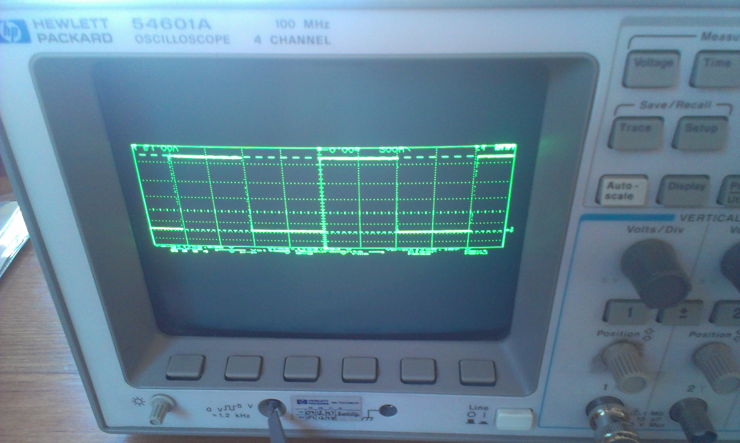

For one thing, it is inverted. And compressed vertically obviously.
This looks like an issue with the vertical part of the CRT driver circuits. The horizontal seems OK, it is full screen width and nice and linear. And the displayed waveform looks fine, so it looks functional. I am not a CRT guy so I can't really help.
Ouch... I can easily imagine how vertical compression could occur, but how do you get the image mirrored..? Perhaps someone tried to fix it and swapped a balanced line? As always, start by checking the supply voltages (with care, as dangerous voltages may be involved here).

Damn...if it seems to good to be true it probably is!
I'm not keen on frying myself on this, may be better if I try to find a HP tech in New Zealand and get it looked at??

The problem is probably easy to fix--perhaps nothing more than a bad resistor or cap. But to find the culprit might not be easy, unless you're familiar with the unit or have a good hand with the service manual. As noted first look at the power supply voltages--or even better, start with a visual check (burned parts etc.).

It may simply be an adjustment issue...you have the manuals from HP so systematically go through the setup adjustments.

The screen does not look inverted to me, just compressed.
The diplays of these scopes work with a crt, just like a monochrome TV. The TV monitor of these scopes looks like it is same OEM part from a Japanese manufacturer.

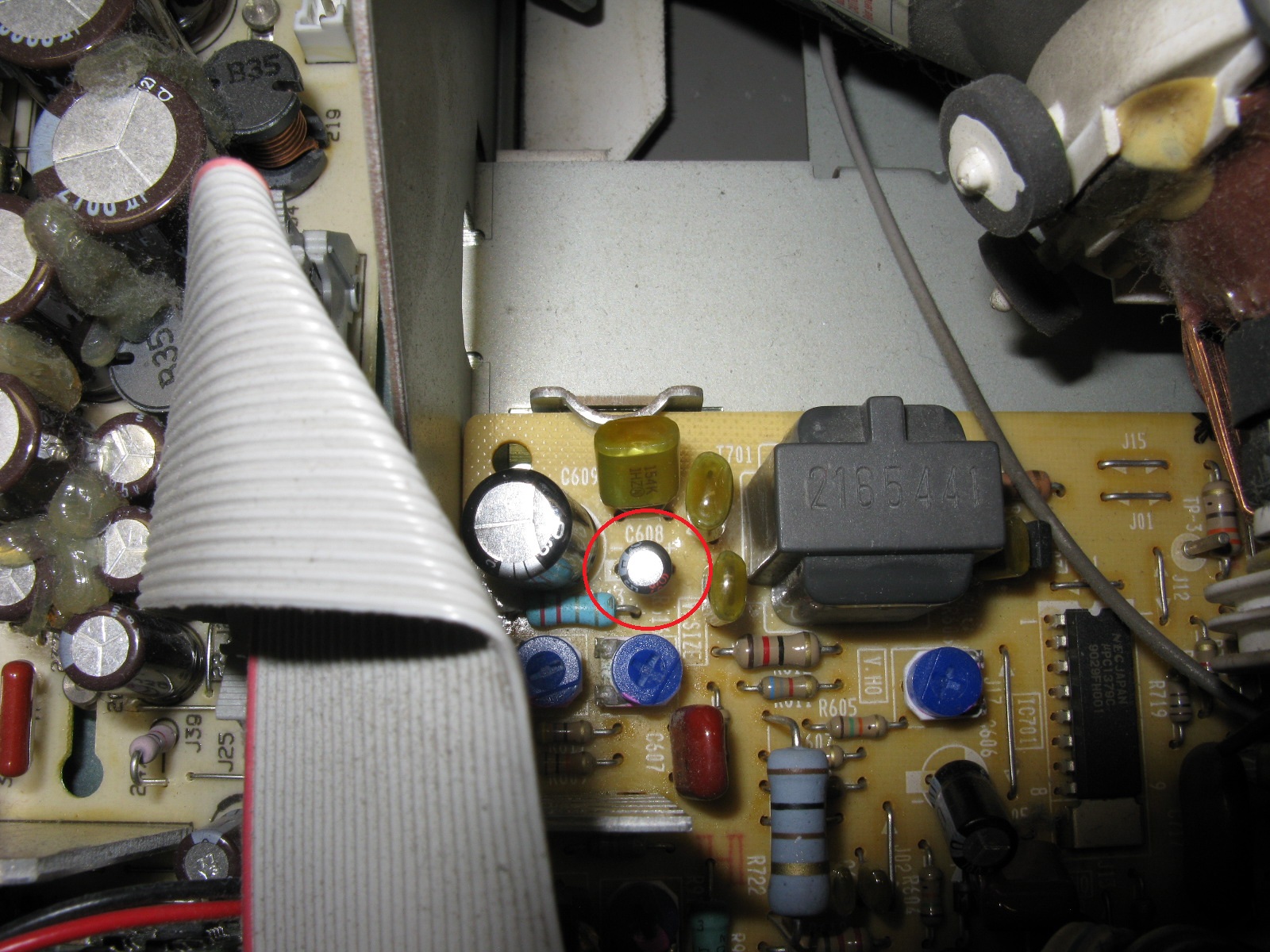

On my unit the vertical deflection was faulty. I downloaded the data sheet of the vertical chip and found a small electrolytic of 10 (or so) µF that dried out. Replaced it an all was fine.
A shame I cannot remember exactly the value or the ref (C#). It is still Sunday here in Europe.
When I get to work tomorrow I will take my lunch break to open the rear cover of the HP and take a picture of the capacitor in question. It is located on the monitor pcb, close to signal pcb and close to the front panel.
If you are not familiar with cathode ray monitors, be careful. The crt uses a voltage in the kV range. Never remove the high voltage plug from the picture tube and never touch the pcb with voltage applied.

But I did take the cover off on the weekend and had a quick look, nothing obvious!
I will have another look tonight at Cap 608

Thanks you so much Cap 608 was dead! changed a few other while I was at it and hey presto....she works 100% 🙂
