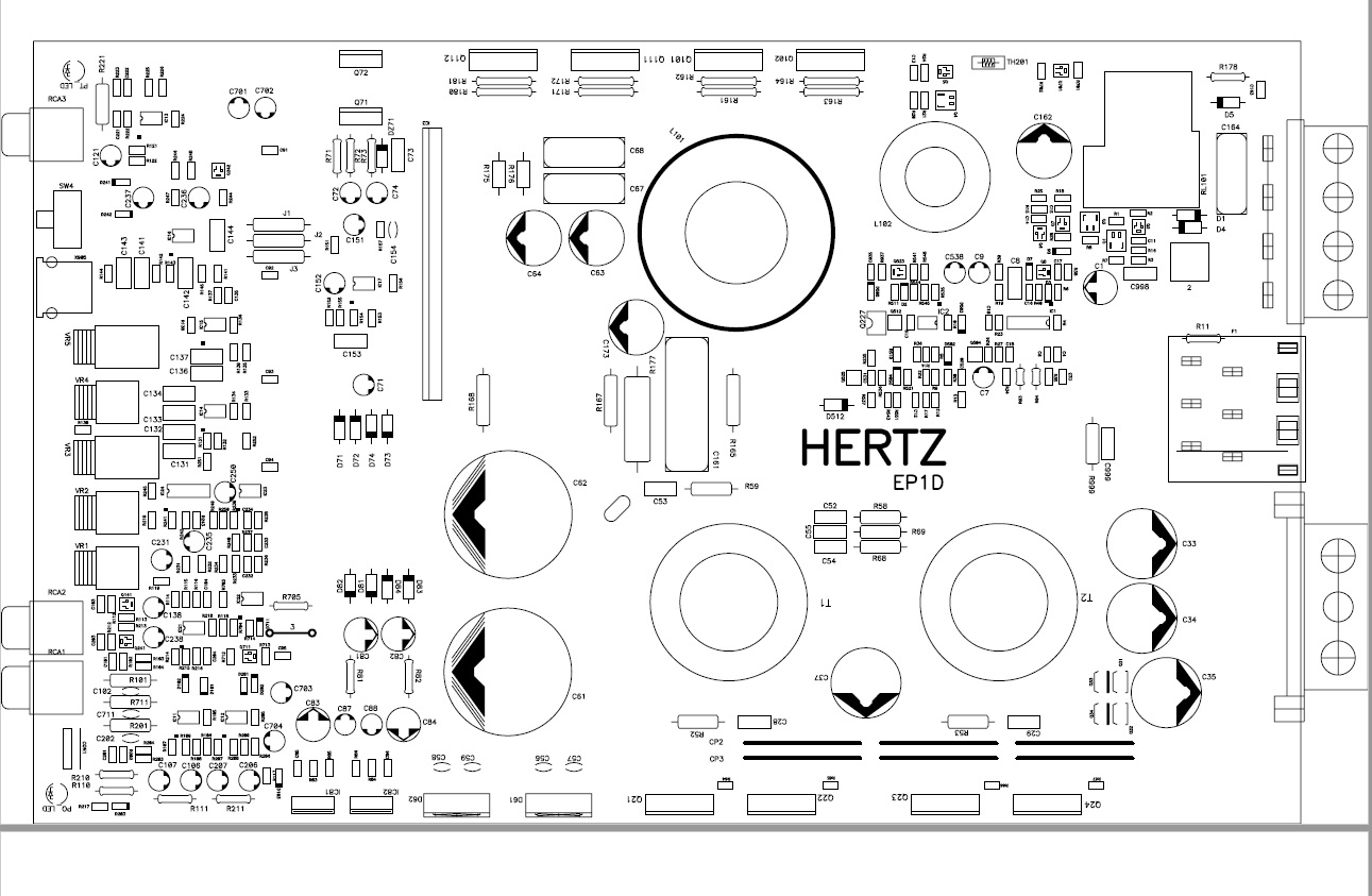

Have a hertz EP1D with R171 and R71 burnt. Outputs obviously shroted. With R71 shorted im thinking its damaged the driver board, but having a hard time following where it goes into the driver board (ic3) on the schematic. also whats a good replacement for the irfp264n?

thanks perry have that service manual, nothing really matches up with the pin numbers and what im measuring in the amp. pust be some goofy numbering system. and ic3 is 1-16 in the amp section, of the schematic, but 2 seperate 1-8 in the digital board section.
Post a photo of the entire board and another of the area of importance. I'll see if I can match it to something else.

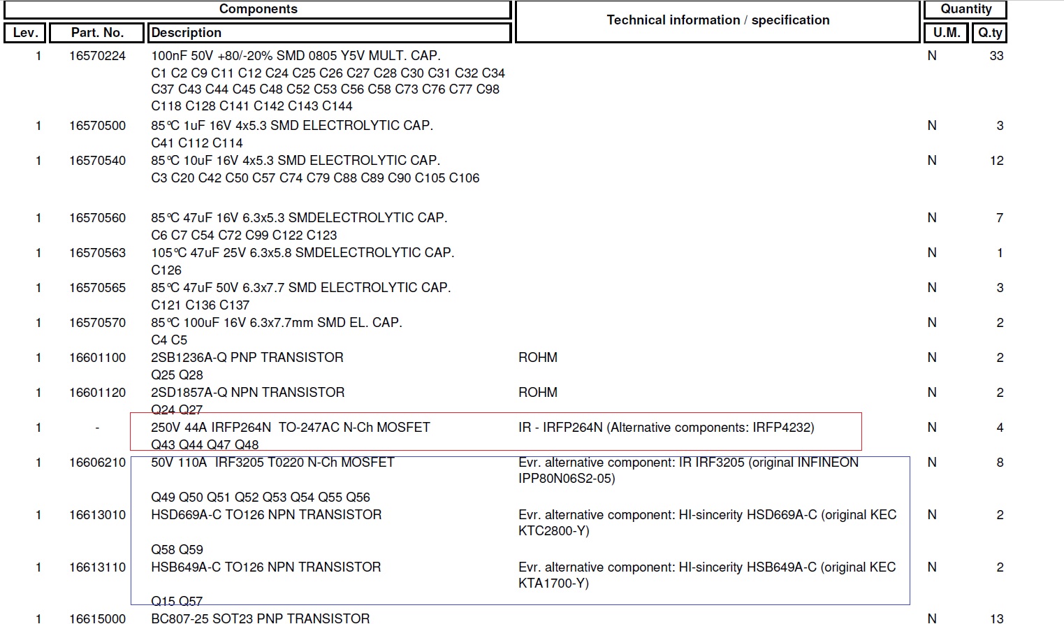

Finally got time to get back to this. Got the last brain fart figured out. Finally took the clamps off and have to exploded irfp064n in the power supply. Seems the entire output section is obsolete, original driver ic IR2184S, drive transistors 2SB1236A and 2SD1857A and the IRFP264N fets are all obsolete. not sure about the PS transistors KTA1023 and KTC1027 yet. Is there replacements that you know of for the obsolete stuff or should this just become yard art? Seems kind of sad that after 4 years a $700cad amp is garbage due to lack of parts
For the power supply drivers, the BD139 and BD140 should work.
For the audio drives, if there is enough space, the KSA1220A and the KSC2690A may work.
For the outputs, the IRFP4229 may work.
IR2184S is not obsolete.

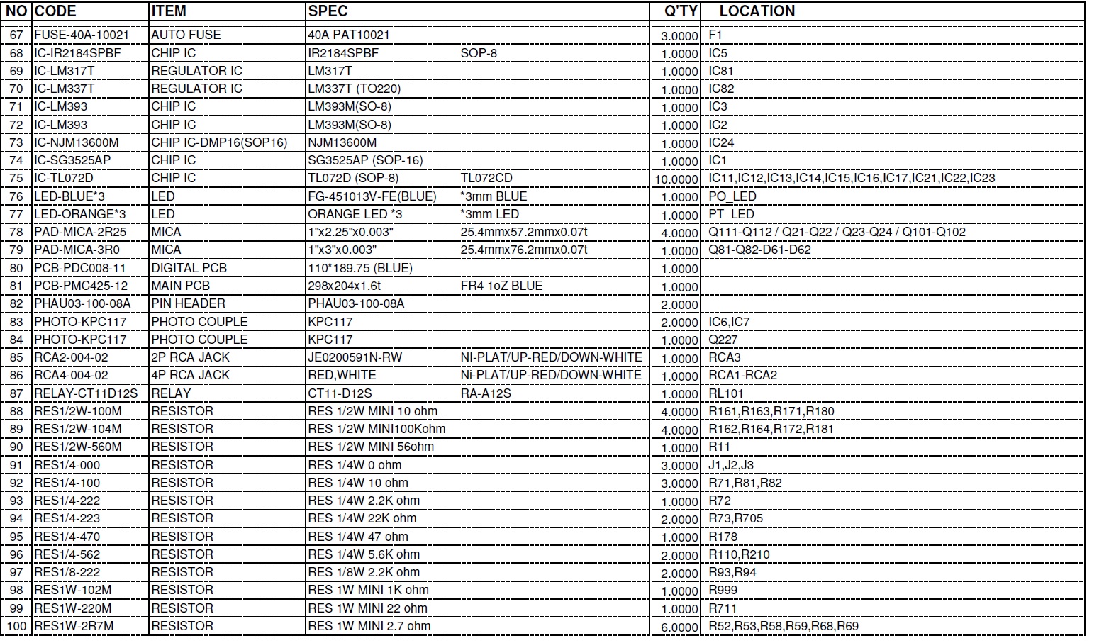

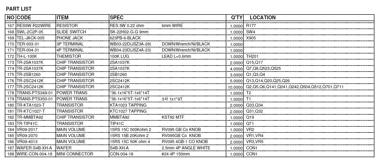

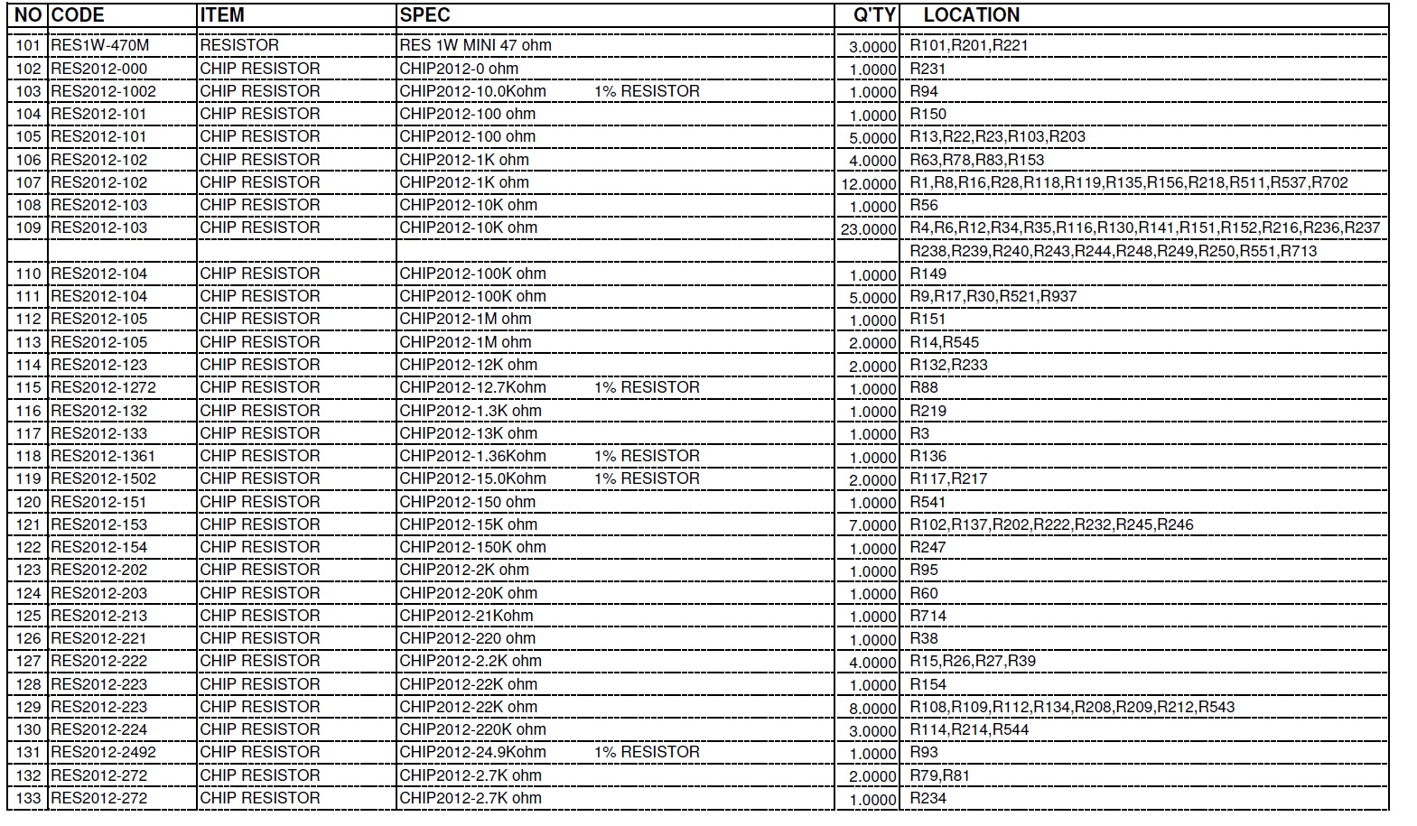

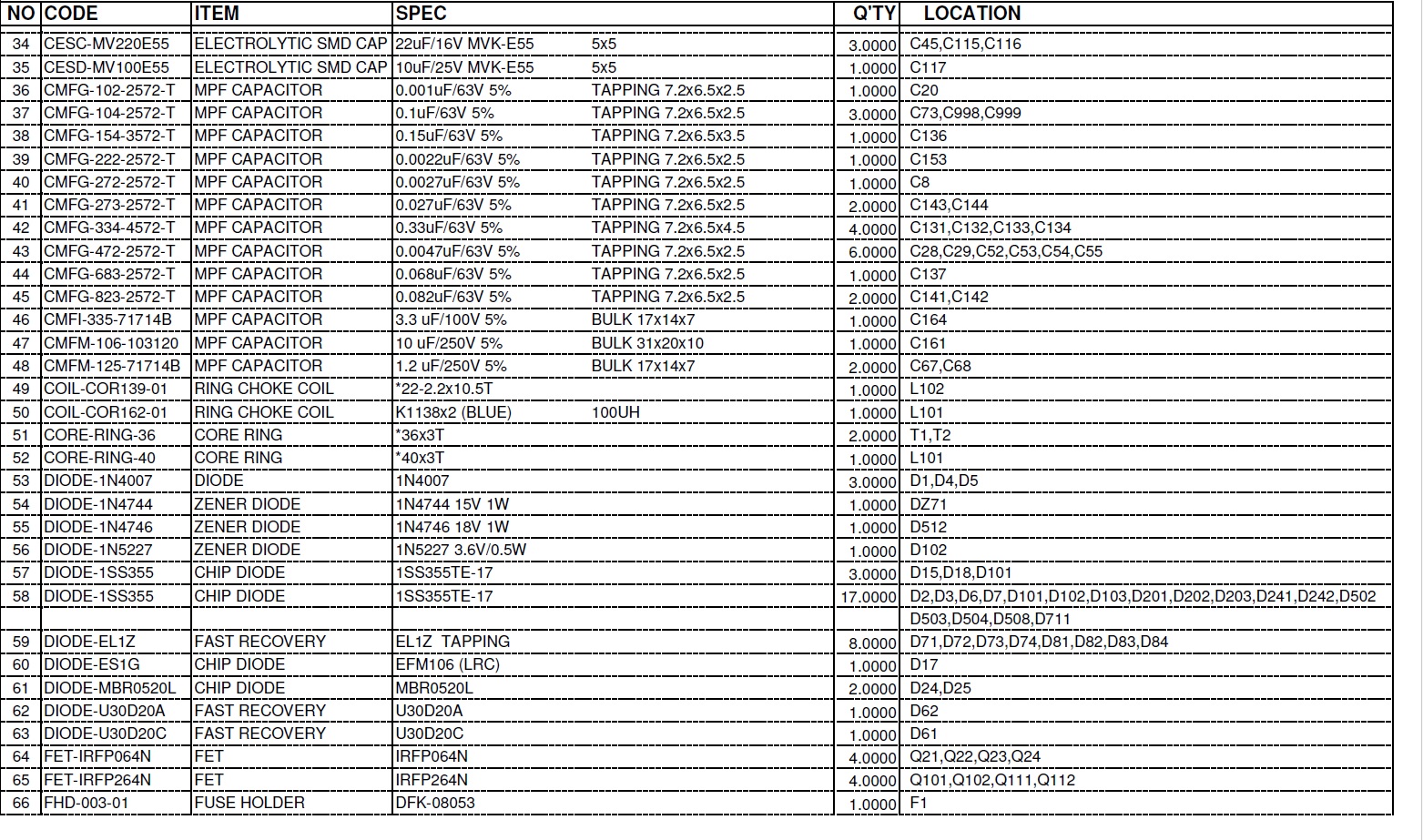

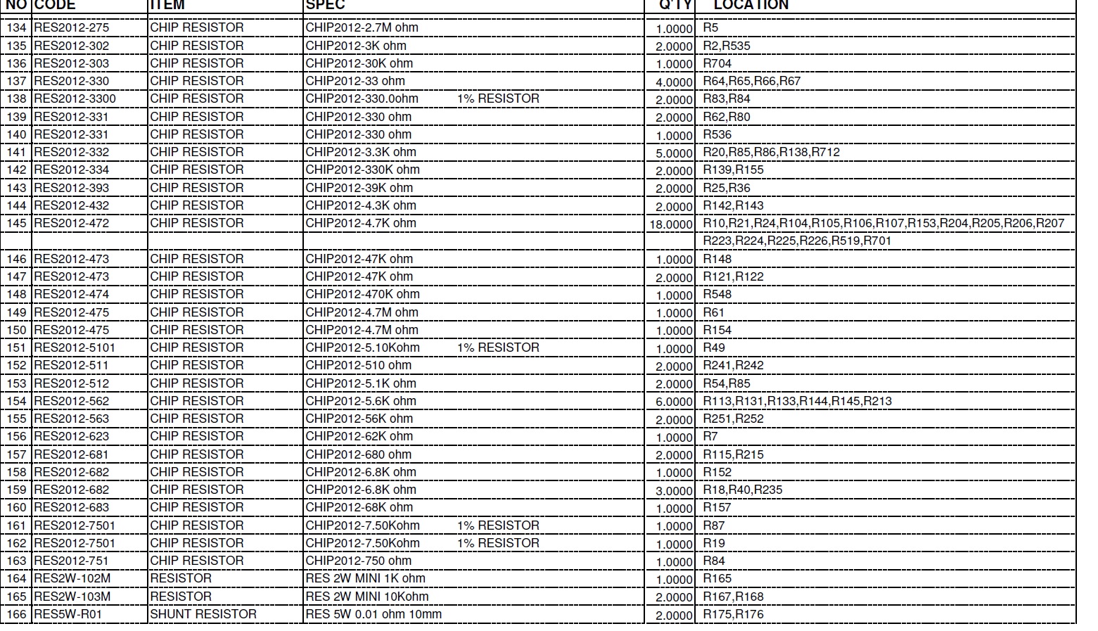

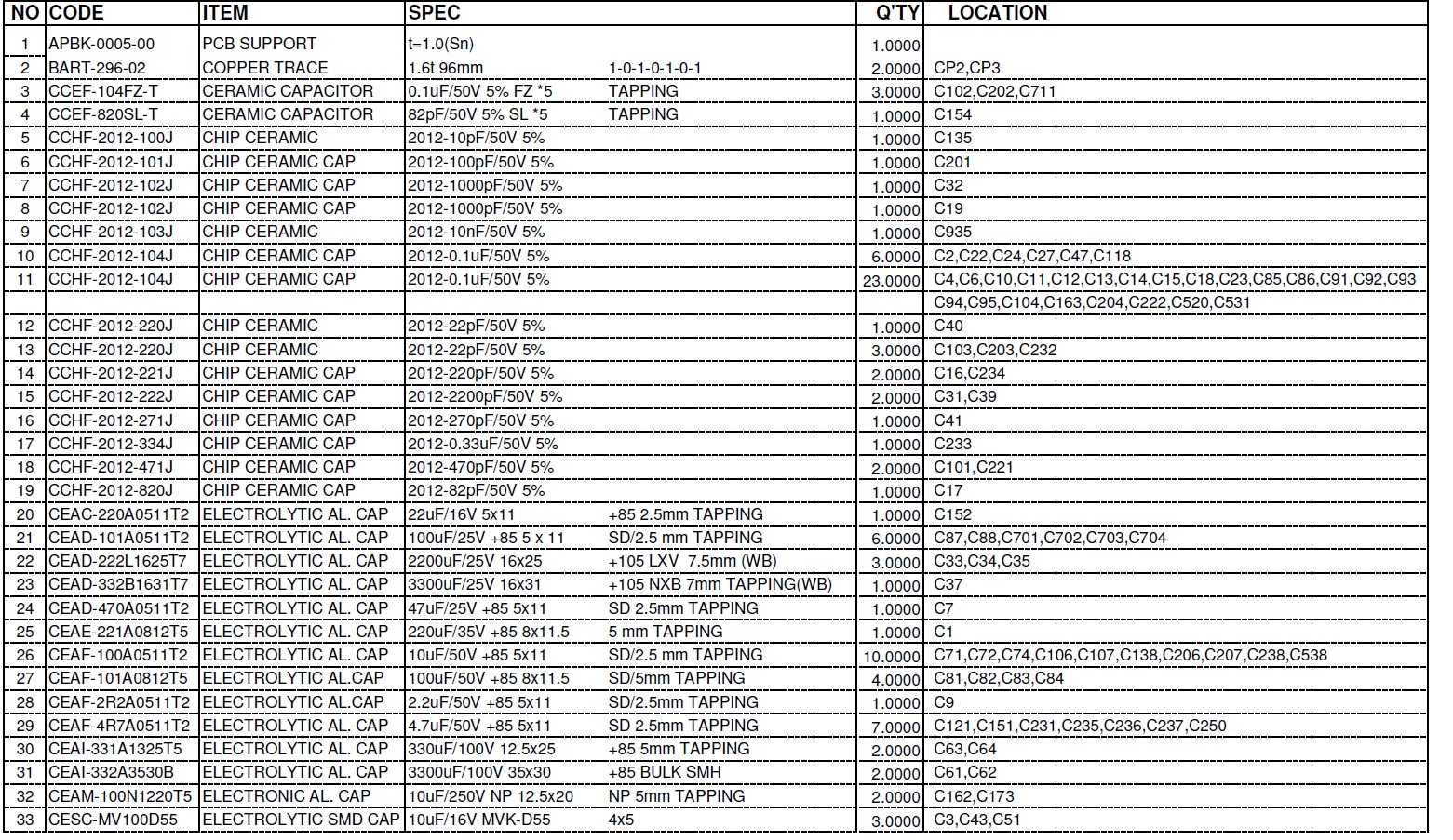

Parts List
send me the NO & CODE from the list that you want.
most of the parts i have in my stock Original from Elettromedia [Hertz and Audison].
i am the technical division in Israel of Elettromedia and make the full service for the products in Israel.
i will do my best to help you.
