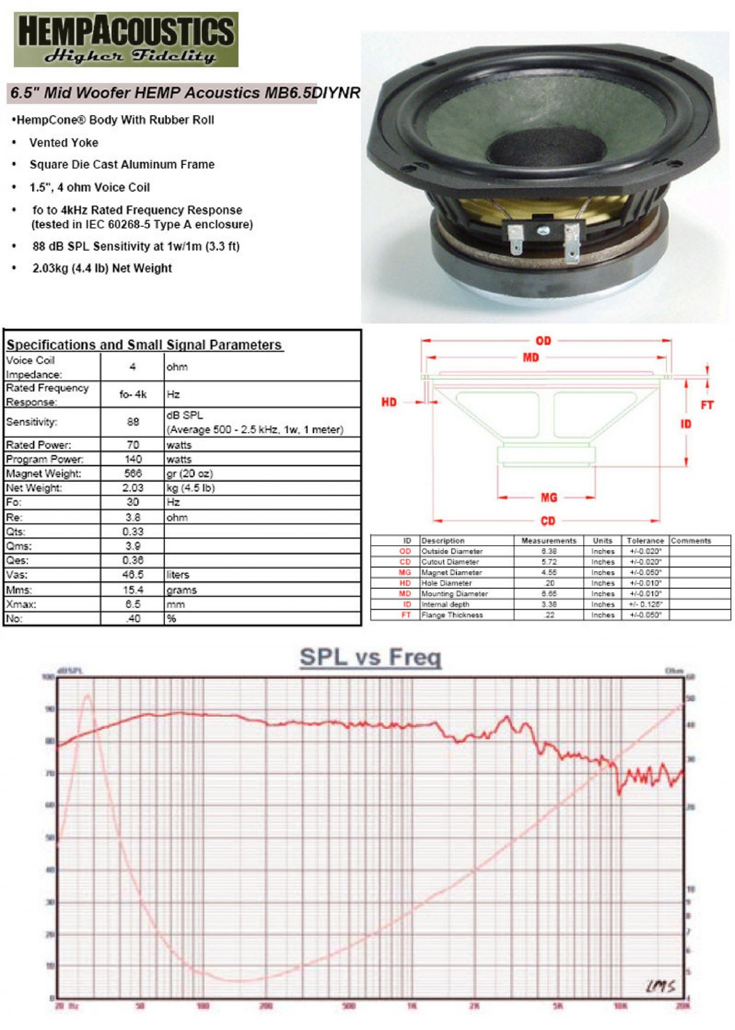

Dug through the archives and dusted off the data sheet for these. See 5th picture.

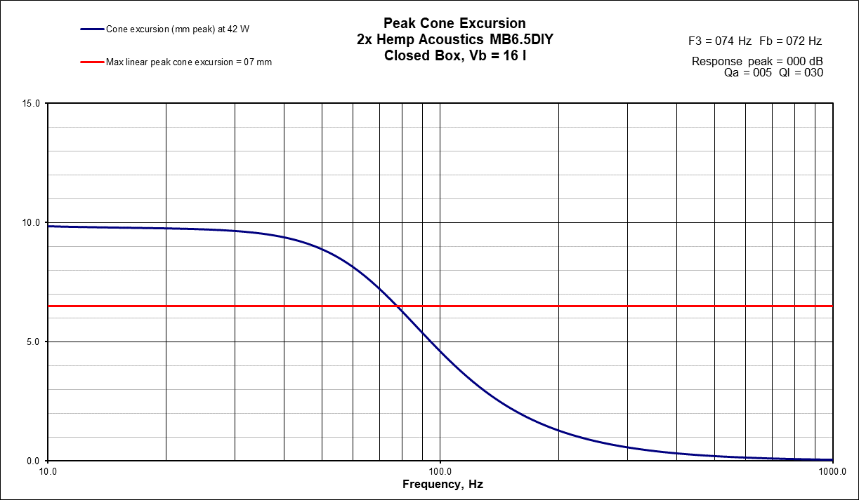

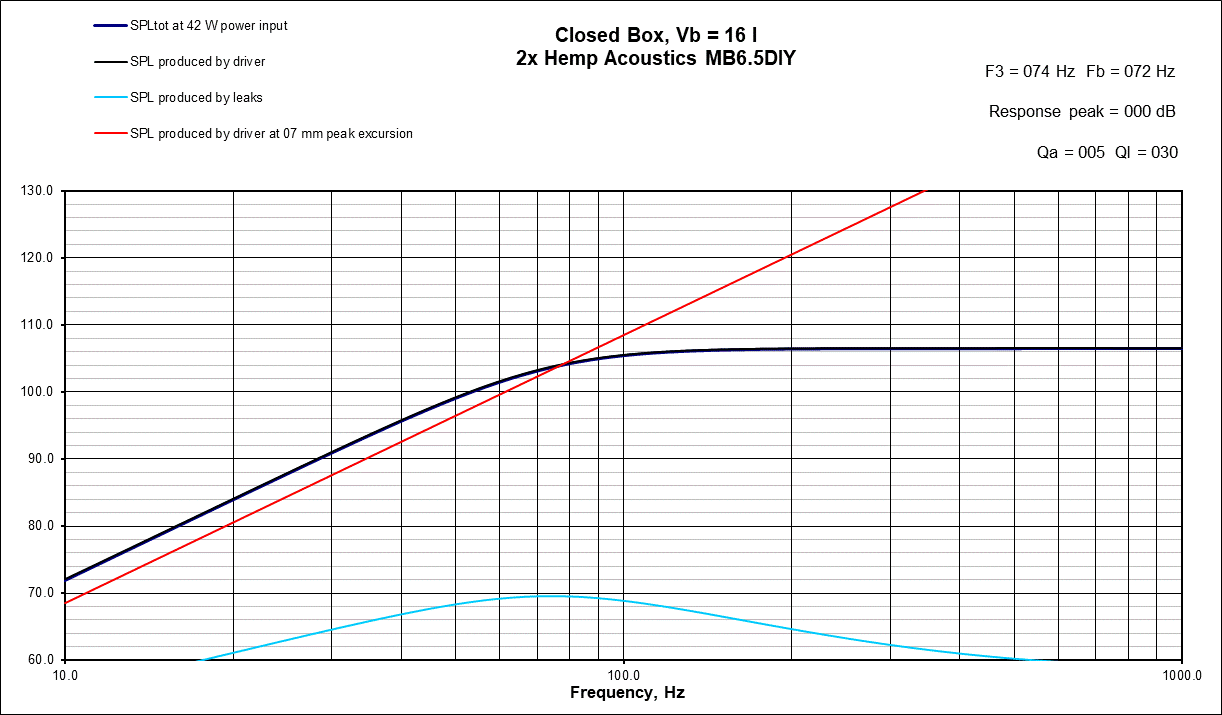

The plan was to put a pair in 16 l closed box enclosure to get the responses in the 3rd and 4th pictures. The design was to get a maximum of about106 dB from each driver set. Not that I'd listen to anything that loud, it is just nice to have some headroom!
