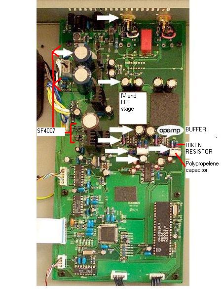

I'm trying to mod my Shanling CDS-100 ...it's a same player as the Music Hall CD-25..
This is what I did to it so far...new solid copper RCA outs , silver wiring , replaced the op-amps for 627 , sound coated the beast...
Player still has bleached sound with no dynamics and slow...just like the reviewer on 6moons audio said...song walks knee deep in water lol.
I found on the web Level 1 and Level 2 ( clock change ) mods for it...bad news ...they are charging arm and a leg for them ...could not find any schematics , instructions or parts list for them..
Do you guys have any advice ( besides buying a new player lol )?
Any help be greatly appreciated...

The Shanling may be knee deep in water but that does not mean it's hopeless.If you can post a close up photo of the dac/IV section leading to rca would be most helpful.Another complete overhead shot of the Shanling as well.We will learn together to tweak this baby. 😀

If you have used OPA627 then the Shanling should not be walking in water. 😀 Although you did not do all the mods.After looking at the board, it's obvious you can't do anything about the IV stage;it's like Marantz's HDAM ( discrete components).Unless you want to use your own and bypass it.
Here is what I think:
Do it in stages so you can evaluate if there are any changes to the sound.
1. SF4007 diodes.( DC rectifier).I don't recommend them.The reviewer looks like he's related to Sonic Frontiers.The diodes are fast but not fast enough.Try FR107s or Schotky diodes 100V should be enough.For the real deal try SBYV27-100 or 150 soft recovery diodes ( reduced RFI emission).
2. The 2X Multicap ppmfx-- you can choose others if you like.
3. The riken resistors-- I count 8 but the other 2 may be covered by white arrows.These are optional.(I don't think it's needed).
4. Try 1 + 2 and then do the power filter and decoupling caps.Again stage by stage.
Hope this is enough for you to start modding.The picture is self explanatory.

When replacing the caps I have to find out the original uF and DC V and match it with multicaps ..right ?
With rectifiers ...there is orientation they have to go in ...on my old ones ...can't find any markings ...:cannotbe: ...
Thanks for your help...and patience...like I told you ...I'm a total noob ...lol
Thanks again
daRRski
Look at the marking on the body of the diodes if there are no silkscreen markings like + or - on the pcb.The white band is the cathode or minus sign.So mark a plus or minus on the pcb with a permanent marker at the appropriate end or better take a close up of all relevant section you wish to mod( before you attempt to remove),you get the idea, right?
The 2 pcs. multicap (white colour) are non or bipolar so no need to observe polarity( original are orange in colour in the left picture).The other electrolytic caps are another matter.ALWAYS note the correct polarity by marking again before removal.Of course take note or write down the cap designation like C1 =??UF ??V before hand.
The resistors are colour coded so you need to know the system coding to decypher the value.
Feel free to ask questions as this is your player.You should do it in stages and not rush.Others will learn from you.The E caps may need to increase in capacitance some may need to reduced.So read all about this issue regarding voltage regulators. before proceeding.Also the type to substitute.That's why a schematic is useful.If you are systematic and do the right thing it can be rewarding.Good luck.

What do you think about using those instead ..
https://www.cree.com/products/pdf/CSD01060.G.pdf
the TO-220-2.. ???
In specs they have faster recovery time than SBYV27.
The question that I have is with replacing bipolar with unipolar rectifiers ...would that work in my set up ?Anything I have to watch for when installing those ?...Finally should I go for those..or wait for the SBYV27 ?
Thanks again
daRRski
The Schottky diodes can be used but first let's clear up the confusion about "bipolar/unipolar" in the datasheet.It's not wrong to say as such if you understand the differences between normal diodes and schottky types.In our case we will treat all as a diode that will conduct in one direction only.So watch the polarity
RFI ( radio frequency interference) is generated as the diodes abruptly switch off Normal rectifier (1n400x) are alot slower so the window/time period is longer,hence more RFI.Schottkly diode has "no" switch off time,almost instantaneous nevertheless it's still an abrupt switch off so there is RFI.Soft recovery diodes have a gentlier slope/switchoff/recovery time but alot faster hence less RFI.A proven way is to parallel a small capcitor about 0.01 -0.1uF across the doide to slow down the rate of change.
There have been good results reported over the years about schottkys used in tube amps and mods, still the matter of subjectivity shows up so you may like what you hear or not.It'really your choice,personally I have not tried schottkys so I can't comment.Subjectively for SBYV27 I will say it's feels quieter and overall enhances the sound to be less digital.There it is politically correct. 😀
