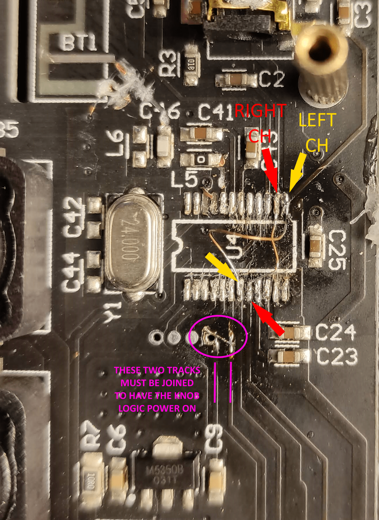

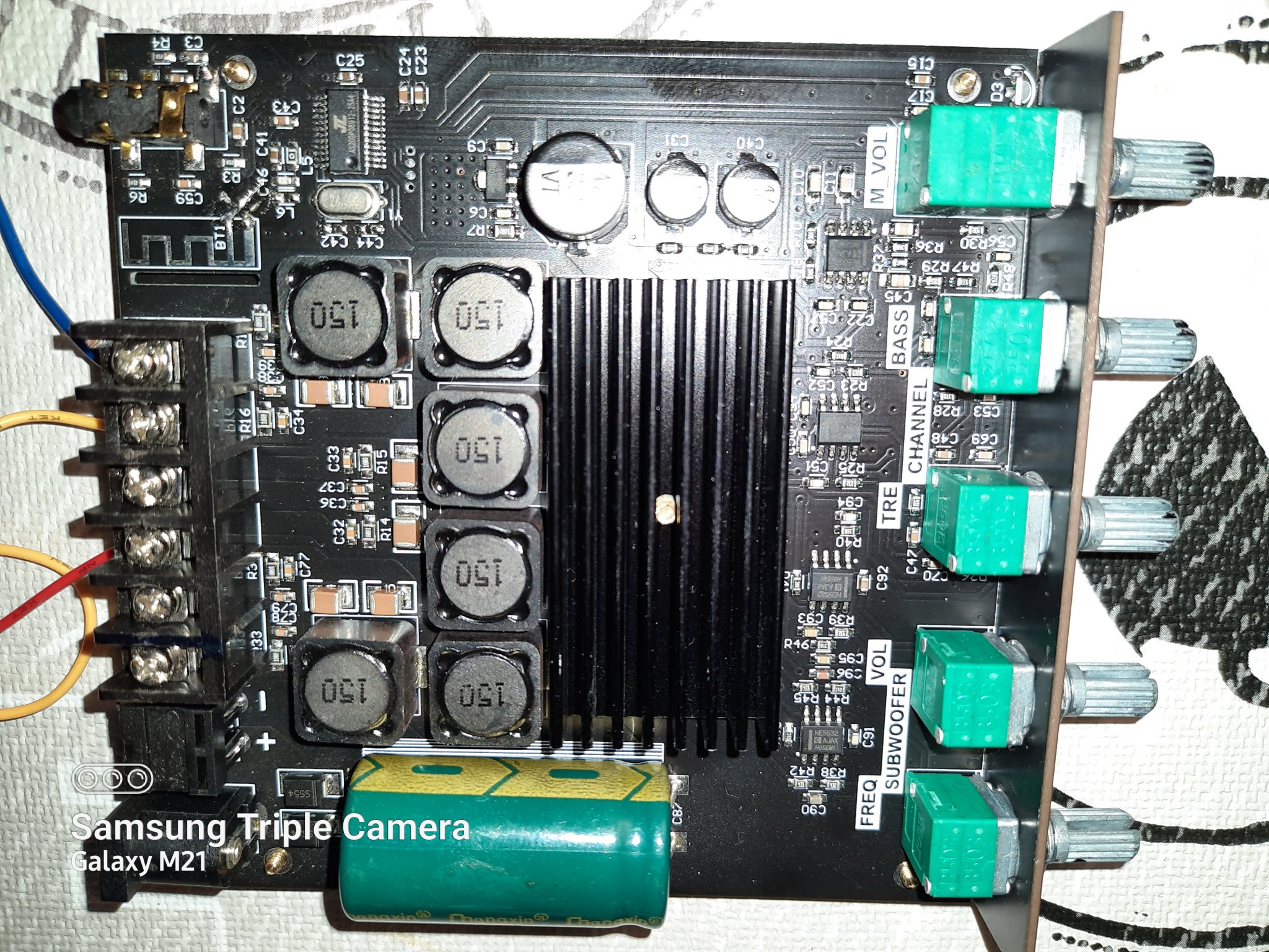

Hi, i have a problem to disable this bluetooth thing... but i don't find any kind of solution for this...
I have try to disable the BT antenna and nothing happens.... this problem is sh**** because my neighbor is always connecting to it. And i can't hear anything from my PC (Connected via AUX)
Board is a ZK-TB21 (2.1 Channel Power Amp)
Chip is a JL AS208P08912-25A4

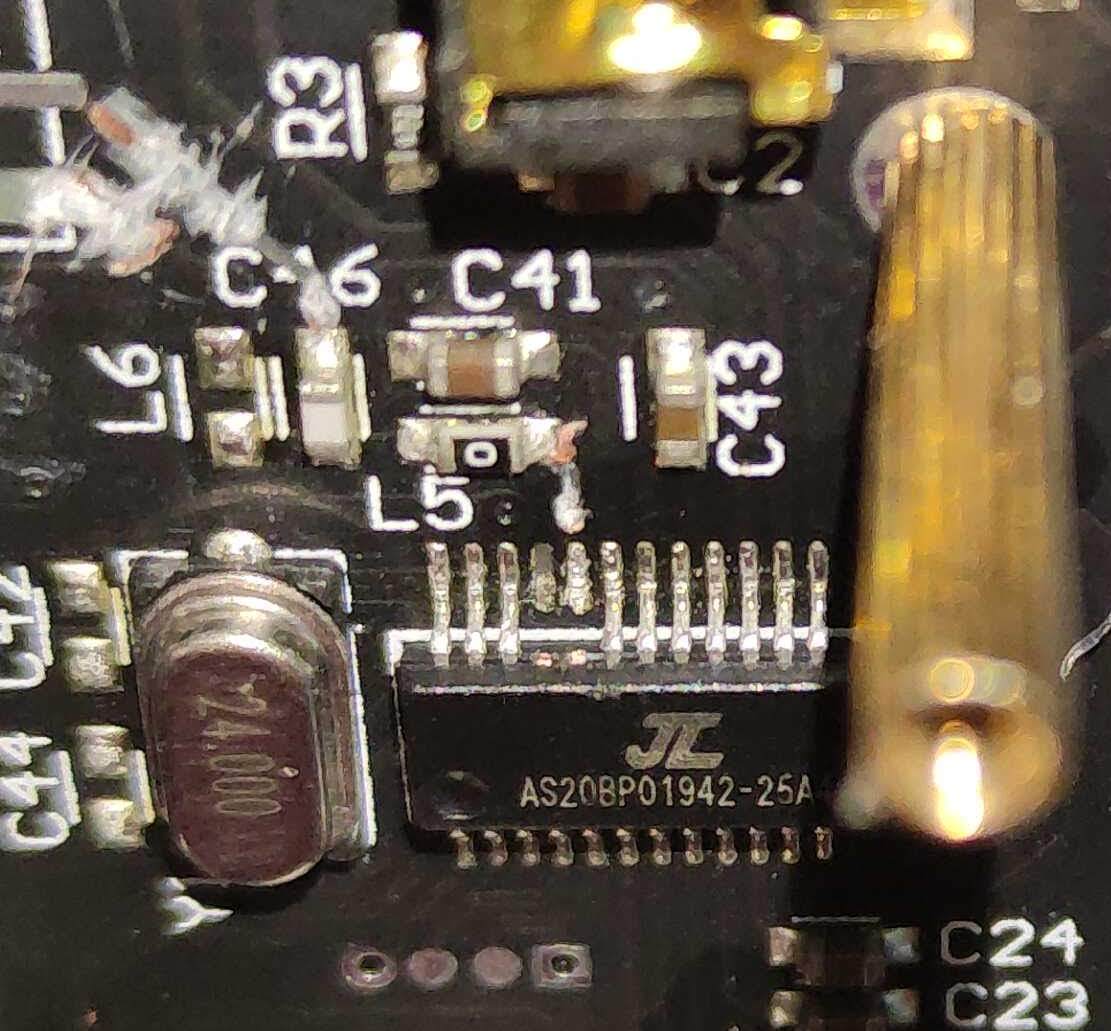

I truncated the pins directly on the BT chip, first the fourth (by mistake) then the fifth and that reduced the range of the BT to one metre.
The problem was old but in the last few days it was too persistent, I thought they were attempts by the neighbors and I intervened by solving the BT but the defect persists: it wasn't access attempts by the neighbors but a power problem. I have a series of "bumps", the power led cycles the bumps then everything goes back to normal. Every half hour or so but it's completely random, I'm investigating, I don't think it's the power supply but rather the boot logic of the TB21.

SOLVED: Fine tip soldering iron, lots of patience, three small copper wires. Remove the bluetooth chip, connect the dots shown in the picture with wires and bluetooth will no longer be a problem.
I cut the pins of the chip with the cutter and then I removed the pieces left on the pcb with the tip of the soldering iron
No more bumps, the problem was the bluetooth chip that made the nearby voltage reducer (M5350B) overheat, now everything works fine.

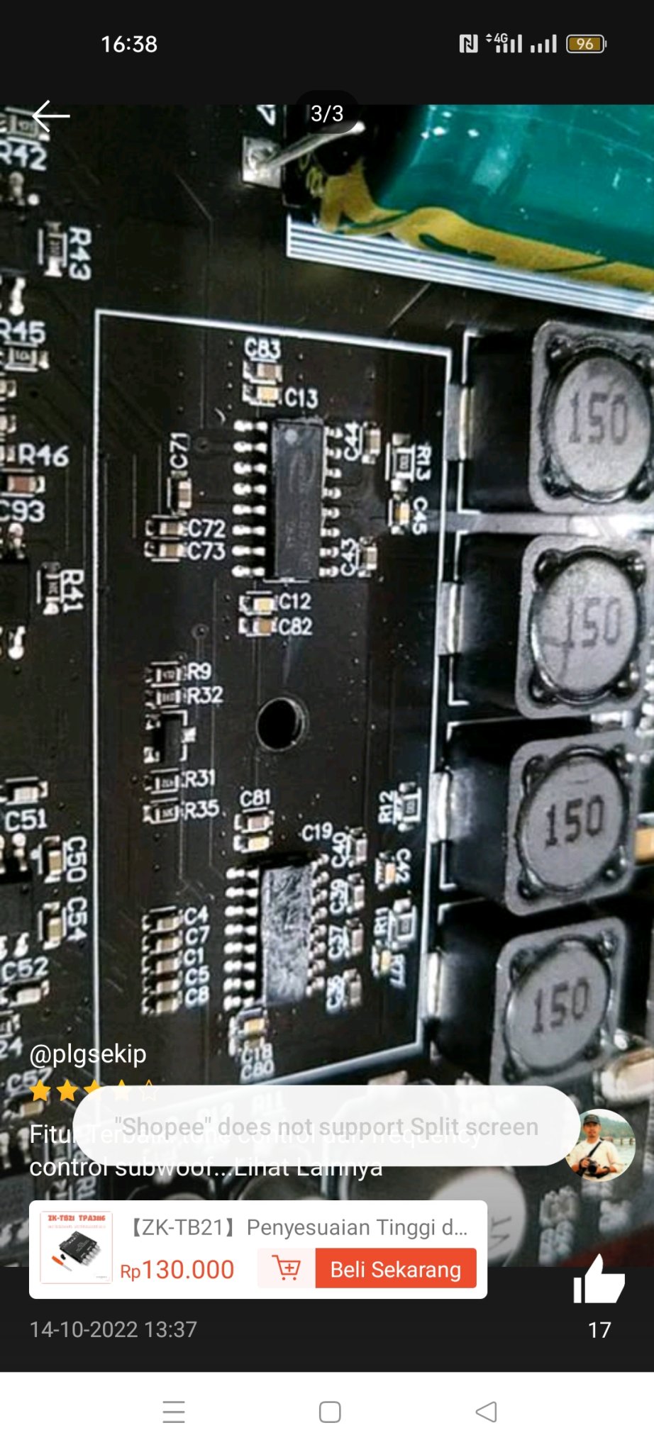

this is mine with chipstar. metal side for heatsink is underneath and it makes it difficult to cool it. 12 volt is cool. 15 volt supply it starts to heat. 20 volt it is hot!!!
