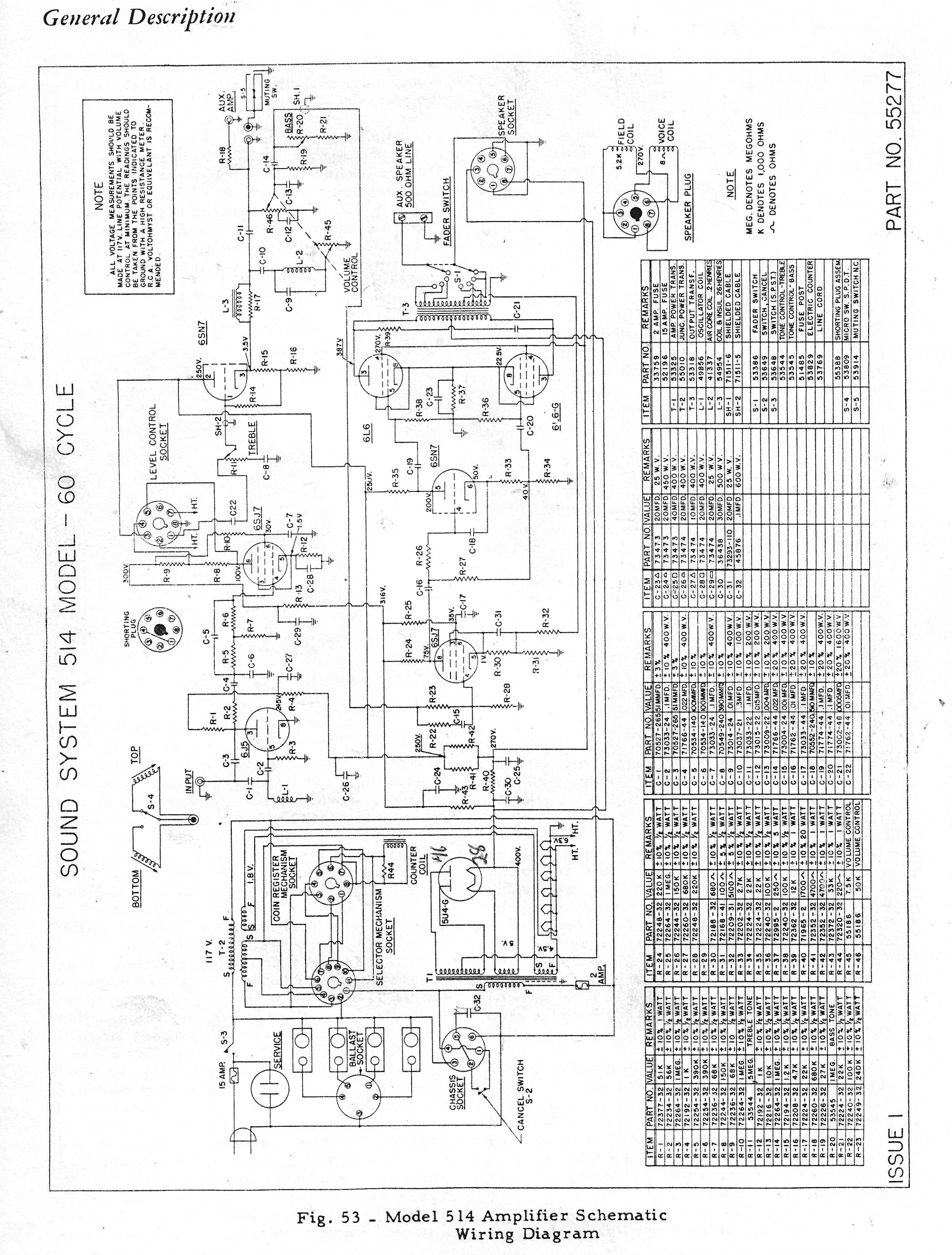

If you have a clean image of the schematic, that would be super helpful. The ones I see online are so blurry they are pretty much illegible.
A schematic would be great but isn't the 6sn7 part of the phase splitter for the output stage. Not sure without a circuit.

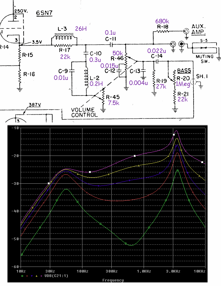

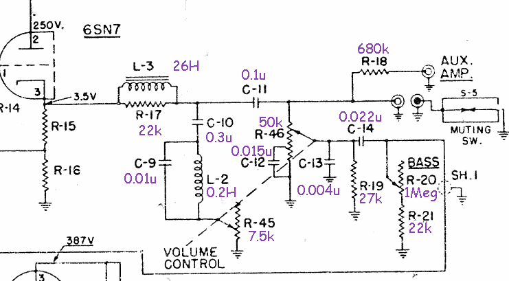

Thanks in advance!!! Attached is a scan of the schematic. I'm new to this forum, so hopefully I'm doing this right. I also attached a picture of some of my measurements. It's been a REALLY long time since I've built a plot like this, so I'm hoping I did it correctly. It includes a plot of what the AC coupled signal looks like at the downstream side of L-3. I also tried measuring at the same spot when C-10 is disconnected and when C-11 is disconnected.
Oh, and to JonSnell - yes, half the 6SN7 is used for the phase splitter, but the other have is used in the preamp section before the volume/bass controls.
Looks like a loudness control combined with the volume but in the wrong direction.
Try conneting the ground to the other end of R45.

It sure looks like that jukebox employs a magnetic cartridge of some kind. That means RIAA playback equalization is being applied to the I/P signal. In order to perform valid "sweeps", what comes from the signal generator has to be passed through a reverse RIAA network, like this.
Hi Mona, R-45 is wired so that it's at zero ohms with the volume at min and increases with increased vol. I've got it set at about 11:00, which equates to about 1K on this pot. The ganged R-46 pot of the volume control is also zero ohms at min volume. I guess I'm not following you. Are you suggesting R-45 should decrease in resistance when increasing vol and that both the schematic and the factory wiring are wrong?

All that stuff around the volumes/bass pots IS a serious response-shaping network.
And it probably is different for every setting of the pots. R45 is clearly to Q-up the 680Hz dip. It seems to drop mids faster than "overall gain". If it is "too loud" (interfering with conversation), the mid is dipped more than lows/highs. The music still plays(pays) without drowning the conversation.
And it echoes what I remember of older jukeboxes. BASS (not deep bass). Highs. And a notable lack of midrange, because a tavern was NOT about the music but about the conversation.

No, that's the right way.Hi Mona, R-45 is wired so that it's at zero ohms with the volume at min and increases with increased vol. I've got it set at about 11:00, which equates to about 1K on this pot. The ganged R-46 pot of the volume control is also zero ohms at min volume. I guess I'm not following you. Are you suggesting R-45 should decrease in resistance when increasing vol and that both the schematic and the factory wiring are wrong?
Because of "The previous owner had the amp "professionally restored" "
it seems not impossible someone had made a wrong connection.
Mona

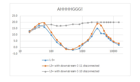

Thanks! I'm thinking I may just add a switch to remove R45 to get back to a flatter response. I guess I thought the tone controls would have been adequate to reduce the mids if a tavern wanted to do so, but???

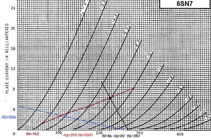

Any thoughts on my 38V on the 6SN7 cathode vs. the 3.5V on the schematic? With the 38V I'm calculating about 6ma of current through the tube. I'm not great reading tube data sheets, but that doesn't seem out of line. Could the schematic be wrong and suppose to read 35V? At 3.5V that would be more like 0.6ma.

Moost probable is the 3V5 is over R15 and that R16 is 47k not 4.7k
Another case of mixup dot/stain, when will you folks write 4,7 and not the error prone 4.7 😱
With R16=47k the cathode comes up to 105V, normal for a cathode follower.
If the cathode is on only 35V the tube is bad or the anode voltage isn't 250V but much lower.

Very nice! Looks just like my measurements. But please help me understand the different curves - what's varying with each color?

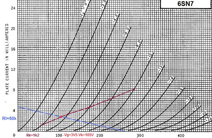

Hi Mona! Hmmm the schematic is pretty clear that 4.7 (4,7)k and 1.2K are the values intended. I also happen to have another W1400 514 Amp that is all rusted out, but good for reference. It too is clearly is using 4.7K and 1.2K here. I've tried three different tubes and get the same 38V at the cathode where the schematic says it should be 3.5V. I have 262V at the plate and see 22.4v at the grid.
Very nice! Looks just like my measurements. But please help me understand the different curves - what's varying with each color? Is this increases in the ganged volume pots? Assuming so, I guess I can see why the tone controls alone won't achieve the same result. I guess the idea is to drop the mids more at lower volumes and increase at higher volumes. I guess that makes some sense to enable room conversation more at lower volumes, but for home use I'd like to have reasonable mid response at lower volumes. I'm thinking that adding that switch to disable R-45 will do what I need.
I put the data you provide in the 6SN7 grafics and it is possible but rather strange loadline.Hi Mona! Hmmm the schematic is pretty clear that 4.7 (4,7)k and 1.2K are the values intended. I also happen to have another W1400 514 Amp that is all rusted out, but good for reference. It too is clearly is using 4.7K and 1.2K here. I've tried three different tubes and get the same 38V at the cathode where the schematic says it should be 3.5V. I have 262V at the plate and see 22.4v at the grid.
The -Vg=8V so there is 30V on the grid (and on R16), you lose 7,5V on the 1M by the meter current and read 22,4V.
I made an error stating Vk= 105V with 47k for R16, used to anode load I inverted the deduction, it's more like Vk=150V.
With the resistors as is, the gain of the cathode follower is ~0,89 and with R16=47k you get ~0,93.

Thanks PRR - any help on what the different plots represent? Are these different volume levels?
Thanks! I got some feedback from a jukebox amp expert and he does think the 3.5V is wrong and should be 35V, which is about what I'm seeing. The gain for cathode followers as I understand it, is indeed less than unity (which I'm also seeing) as the primary purpose is to convert impedance. So, I think this part of the circuit is acting as designed.I put the data you provide in the 6SN7 grafics and it is possible but rather strange loadline.
