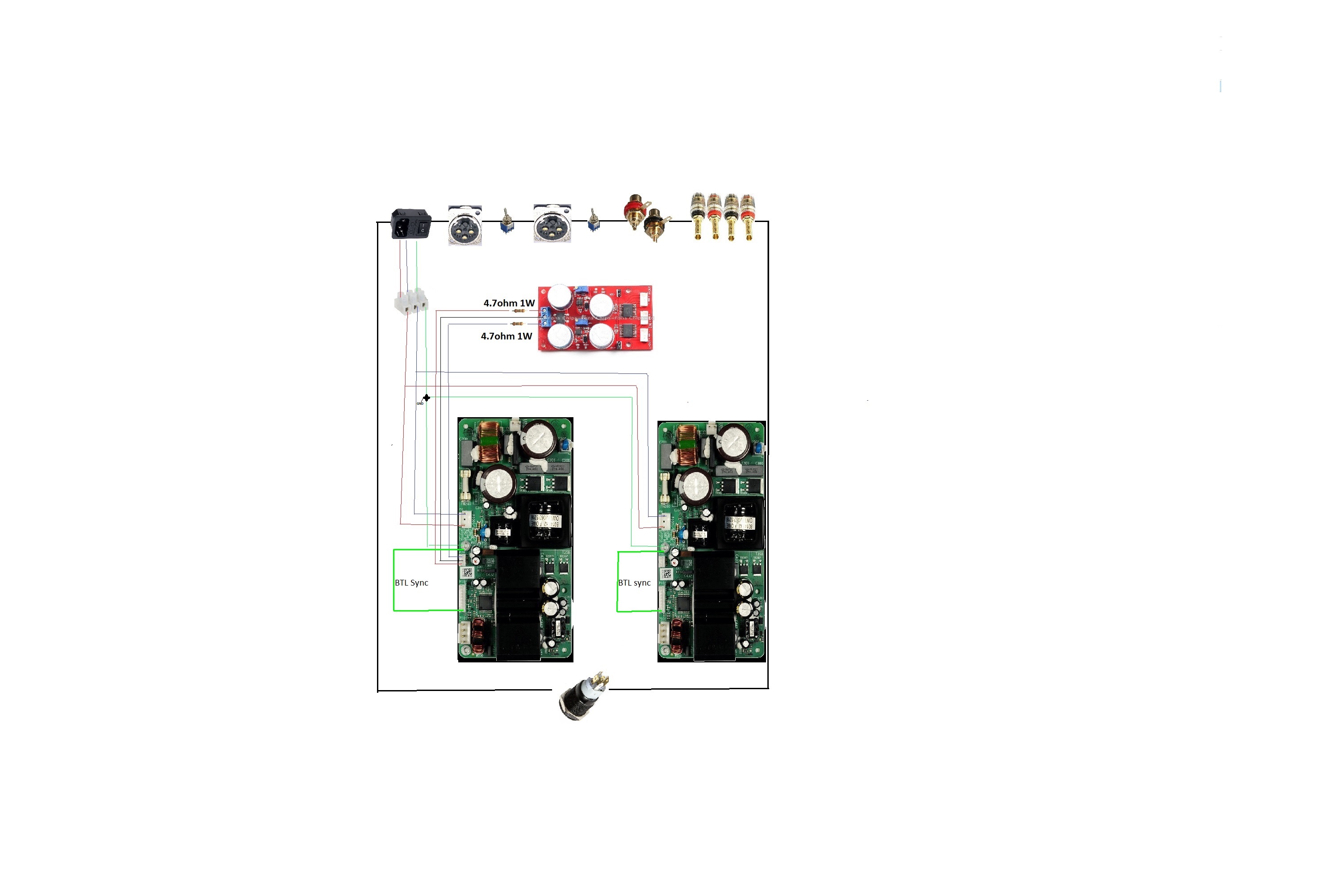

I'm in need of a little help with the last part of my amp build. I am not an electronic engineer I just like to build stuff.

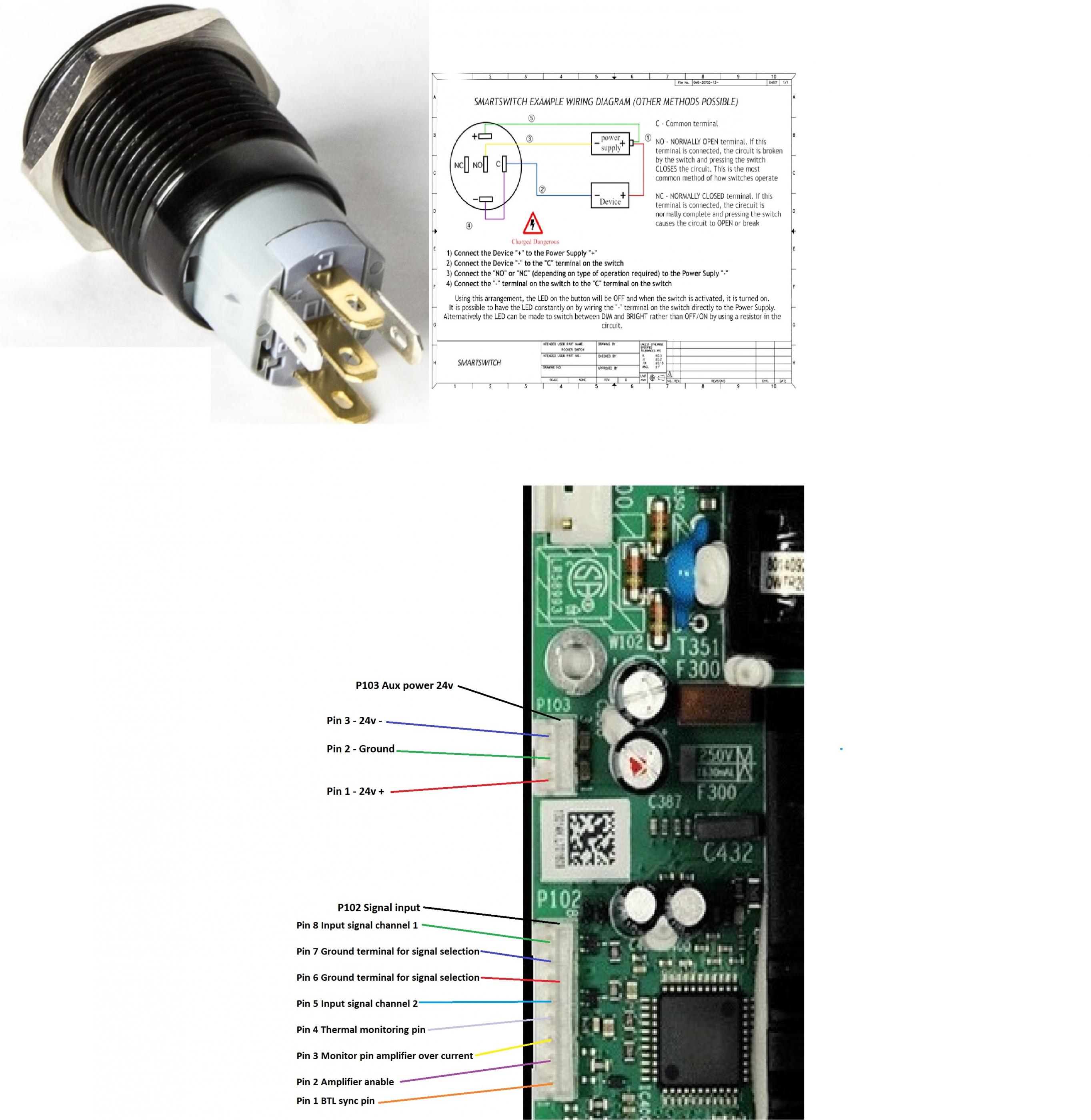

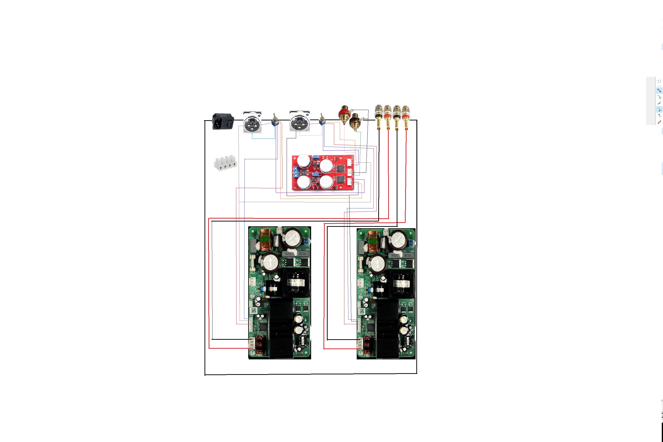

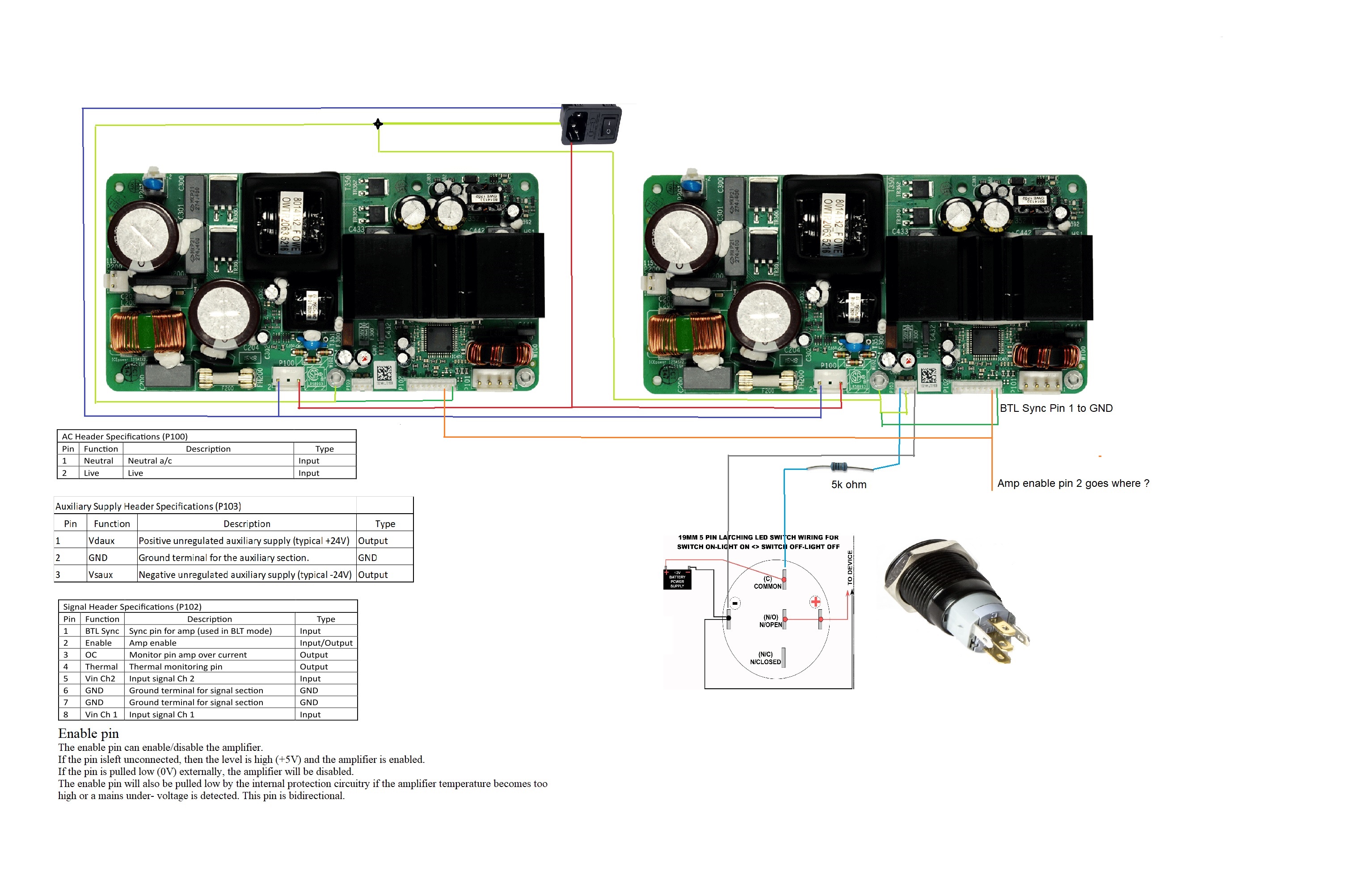

I have on their way a pair of Icepower 125ASX2 modules that I am going to build into the same case so that I end up with a nice 250w 2 x Chanel amp by bridging/BTL the modules. I think I have about worked out the wiring parts but am a little stumped on how to wire the 12/24v single pole standby switch, I have attached separate wiring diagrams to make it easier to read, 1 for the main power, one for the signal input/output and the amp enable/not sure diagrams.
Once I know how to wire the switch to the board do I need a double pole switch as I have been told to enable the 2 amps together or surely I can connect the 1 same pole to control both the boards ??
I know there are some of you guys out there that have built these as I have seen the pictures when googled but I can't quite see how the standby switches are wired.
I will be forever grateful for some help

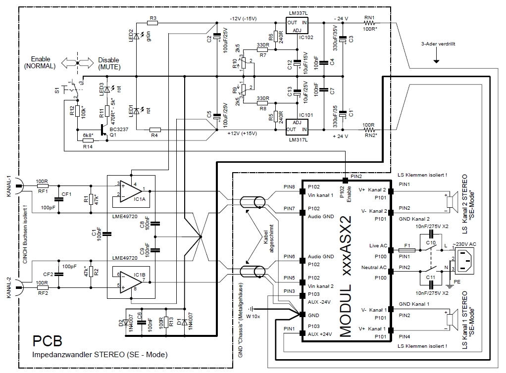

You will find a complète schematic of a 125 ASX2 amp including pre-amp and mute section in attachment.
I've included the +-12V PSU and the pre-amp section in my four channels 50ASX2 build.

I highly recommend you take a look at Bruno Putzeys „The G-Word, How to get your audio off the ground”!
