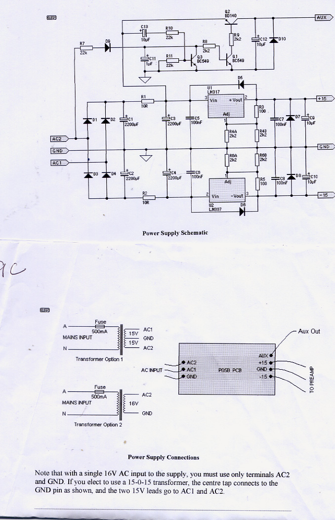

Hi.
I am enclosing 2 images. However if they do not come through this is the instructions
for connecting supply. ' With a single 16V AC input to the supply, you must use only
terminals AC2 and GND '
The actual connections are marked on circiut board AC1, AC2, GND.
Mike
Hi.
Mike
I see what they have done.
that GND is actually the pad for the transformer centre tap. It should have been labelled CT
A three wire centre tapped secondary uses the two AC and the centre tap.
A dual secondary with four wires uses AC1 and centre tap for one secondary and AC2 and centre tap for the other secondary. BUT !!!!! you must use a protection device in case the phase of the two Secondaries gets mixed up. A Mains Bulb Tester is a good protection device.
A single secondary uses the half bridge as a full wave rectifier. This is not a good way to wire this up.
Buy a dual secondary, or a centre tapped transformer, or buy a second double insulated transformer to match the one you have.

SHORT answer: you can NOT use that wall wart to supply that circuit, period.
Sorry.
You need a:
16+16VAC center tapped transformer

Non monsieur!
He possibly can use that wall wart, feeding an AC-input and AC return.
The rectifier will then work as voltage doubler resulting in twice the ripple.
Any way, it is worth a try!😉
It looks like a voltage doubler, but it is charging two separate series connected capacitors. That gives virtually the same voltage as using the whole bridge rectifier from a centre tapped transformer.Non monsieur!
It is a full wave rectifier, not a voltage doubler.
As per Rod Elliott's project page Power Supply for Preamps - "If a single AC supply is connected between GND and AC2, the rectifier is a full-wave voltage-doubler type, and with an input of 16VAC will provide about +/-20V DC at a current of up to at least 100mA - this should be enough for the most power-hungry preamp."
It does not matter which way round the 16VAC is connected. Ignore the naysayers.
It's NOT a voltage doubler. The 16vac would have to series pass through a cap to make a voltage doubler.
I guess it isn't. With single supply you have half wave positive via D1 & half wave negative via D3. D2 & D4 do nothing and may be omitted.
Same as Project Phonobox and it will work.
I suggest you tell Rod - he does respond to email and will appreciate the interest in his projects.

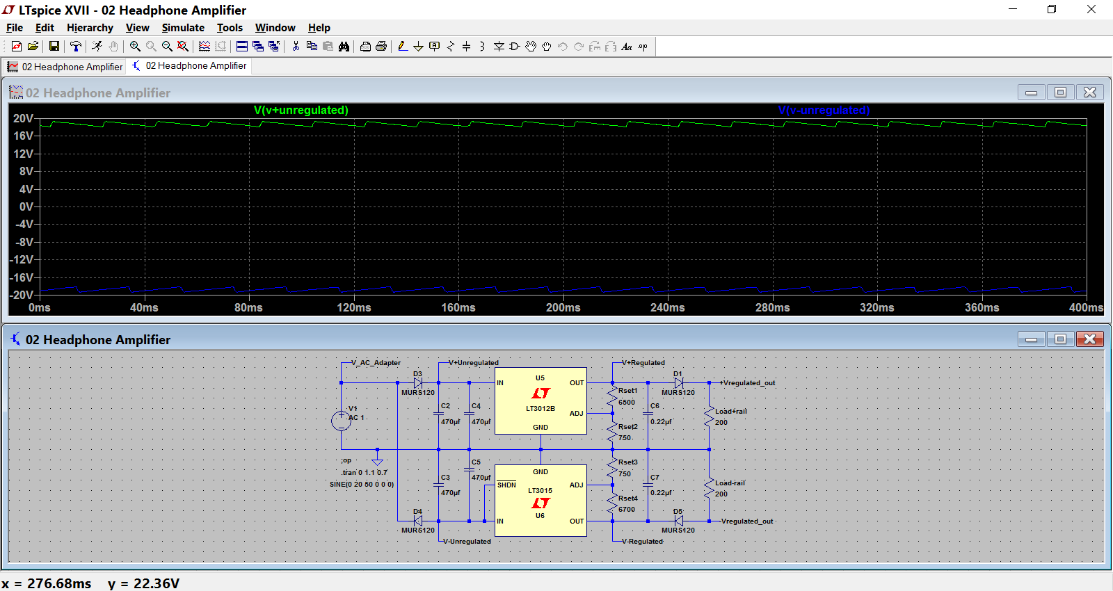

And here is the correct answer.
You CAN use your wall wart. Connected to ac2 and gnd the circuit acts as as half wave voltage doubler. Its all explained clearly on the ESP p05 article.
The circuit is simply two half wave rectifiers, one producing a positive rail and one a negative.
Its only a 'voltage doubler' if you decide to move your measurement point of reference to one or other of the rails.
Fwiw, the circuit is the same in outline as that used in the 02 headphone amp.
