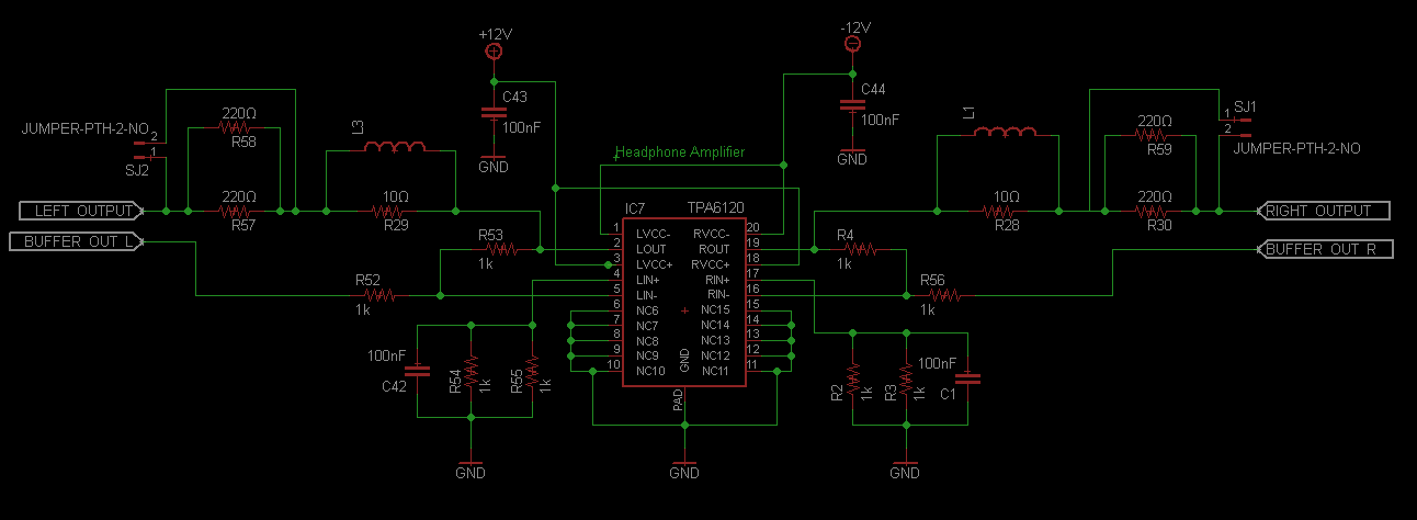

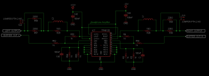

its better to use the lowest resistance volume pot your source happy driving - 10k would be my typical suggestion
as the wiper moves the resistance seen by the rest of the input circuit changes, will change the low pass time constant with the 100 pF RF grounding cap
an additional effect is that higher source Z causes some (very small) distortion with fet input op amps in particular
other quibbles would be having all the parts and not using a multiloop feedback arrangement
driving the TPA in inverting mode is a poor system choice compared to extending the input op amp feedback loop to include, correct the TPA output for much lower distortion performance
and the 10 Ohm output R wastes the TPA abilities too - should be a lossy ferrite or R||L to isolate the TPA from cable C while giving milliohm audio frequency output Z
the last improvement does come at a cost of then needing to deal with the horrible headphone TRS jack/plug tendency to short outputs while being plugged in/out

Okay, so at least for the 10k output resistor issue, I added in a ferrite as suggested by some research. Hopefully, that will lower the output impedance to a reasonable level. Attached is the TPA6210A2 portion of the circuit.
