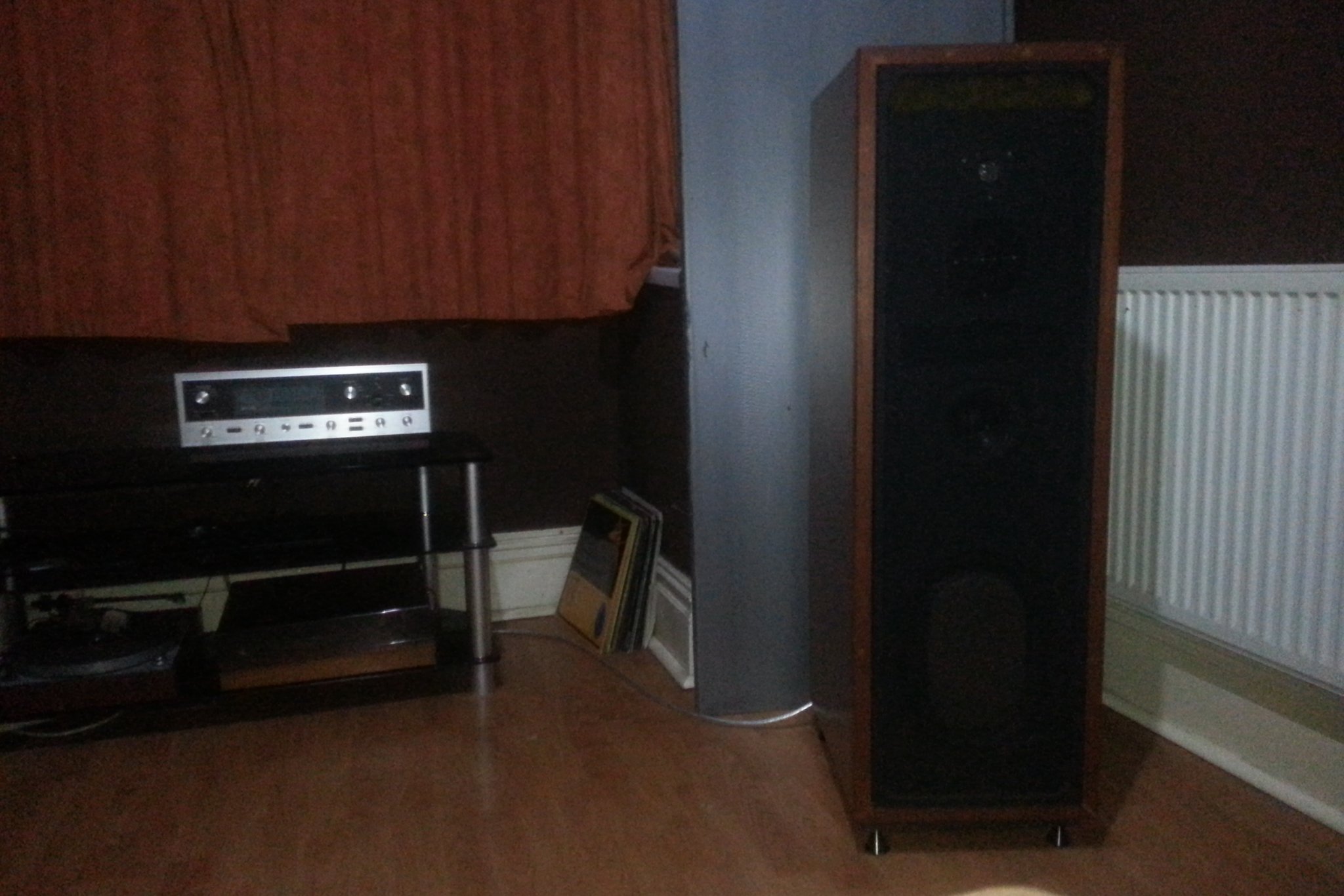

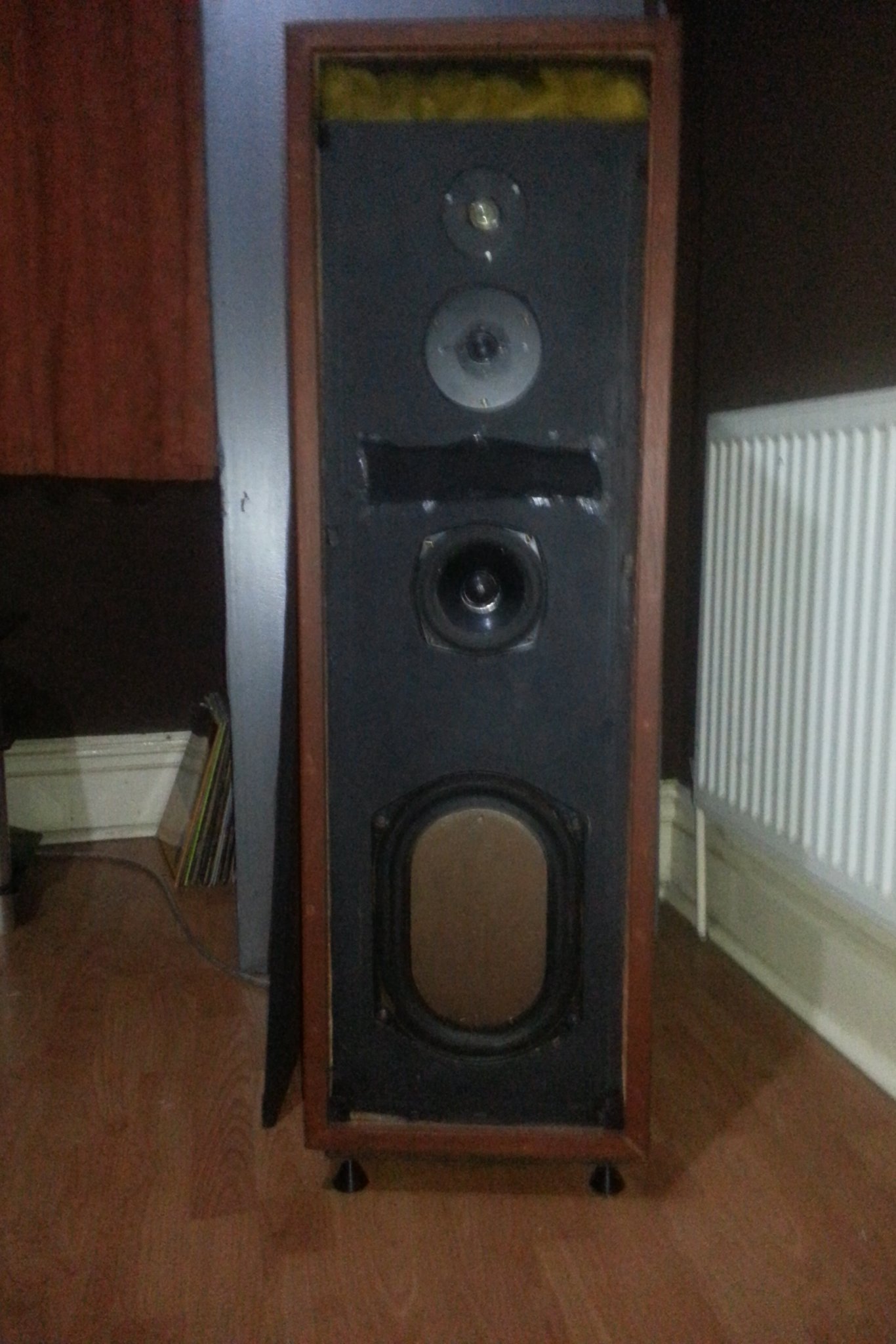

I have very old pioneer speakers pw12a woofer pm6 mid and pw3 horn tweeter. Thau all work and are inclosed in a corner shape cab. What type of cab should I make for them. They also have a dividing network box and volume for top end frequency. .thanks
The cabs had huge rectangular port and I cut out at the bottom. So I closed them off. Just very nice mid. I today removed the bottom piece of wood that closed it off still nice mid. But if I put my head in the speaker box it sounds awesome, how do I get that sound outside of the box so I can hear it.

You know, since the midrange driver ( squeaker) and the tweeter are covered in the back, they don't need any enclosure. Not that I say that they might be set naked, but...
You would focus then on the woofer cab only. I would make some cubic-prism-anything that leaves one side near to the woofer free to position the two other driver units, eminently on the vertical axis. This way you could position the whole set anywhere in the room and experiment with the two speakers aiming at you

And...I wouldn't call those woofers and all the vintage stuff " full range" since they're limited...a modern aluminium/ ceramic/graphene! 4" easily outperforms them in the bass range requiring 1/5 space and mantain pistonic behavior till break-up (well, they are small...) due to cone rigidity ( and the membrane being more soundproof than paper.. ) and roll surround + good excursion..
So you cannot "feed" those (that) woofers with synthetic LFO (like the group!) at medium-hi volume.
In short, I would make a mono speaker with all the sighteable things in sight in a 50's and steampunk style. Woofer cab in formica, of course, and solid copper wires covered in cotton 😉

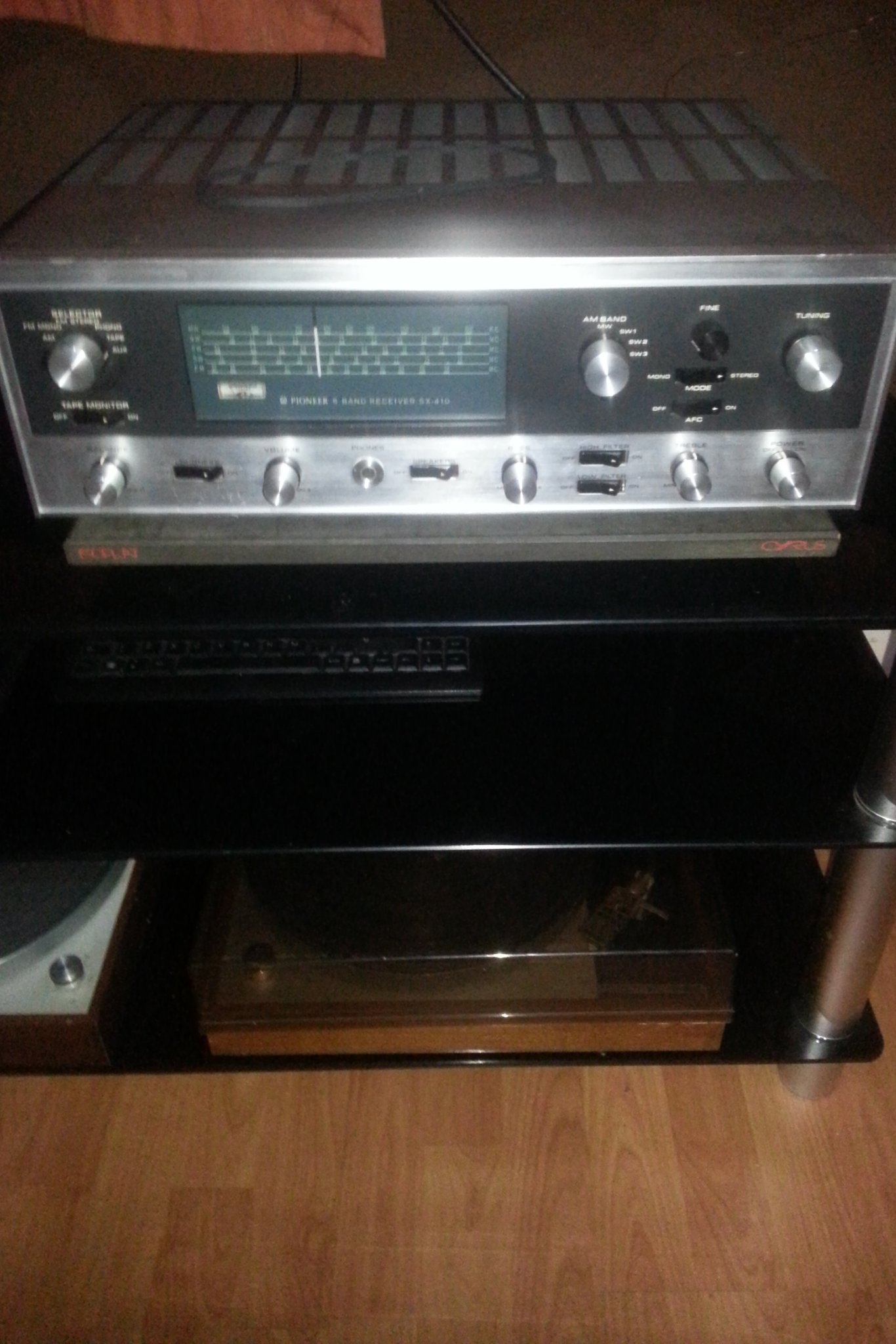

I would like to make some speakers myself to interchange with the equipment I have at the moment.
Pioneer sx410 receiver and the pro9 transmission line.

Amp has only one Chanel for one set of speakers. This project is for my sony ta1144 that has 2 channel a and b. Im looking for a pair of mission 737r to repair my mk2 mission 770. The pioneer set is to provide a larger more open sound stage by having the pioneer in centre and 2 other speakers as satellite to widen sound, if you get the picture.
