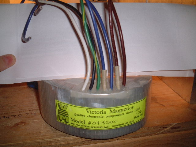

Ok i bought 2 brand new transformers from Peter Daniel They didnt come with Wireing diagram or any thing. they have 7 wires
black
white
green with yellow stripe
2 brown
2 blue
can any one tell me what they are.
here is my guess
2 brow = one set of secondarys
2 blue = another set. of secondarys
blacn and white is ac in.
and green is the center tap

I would guess that the Black & White are Hot & Neutral, the Blues are one secondary, the Browns are another secondary. I think the Green w/ Yellow should be connected to the Earth coming from the mains???

i did ask P.D. You would think he would know but he didn't he sujested emailing victoria magnetic's. I may just do so.
Emailing VM is probably the safest way to go. (You don't want to damage the transformer). If you give them the model # off the tranny, they should be able to help you out.
Email John (john@victoriamagnetics.com) tonight and you'll get your answer tomorrow morning.
Email John the picture that you posted here. He's familiar with what we diyers are doing with those transformer.

Anyway, this is just a simple toroid and the previous suggestions were right on the mark. The green/yellow wire is shield and should be connected to the ground. The other wires are easily identified with a meter. The highest impedance would be for primary. THe other two are secondaries. The short piece of a jacket is to mark the same phase on secondaries, I guess.

My VM 1kva transformer has only one set of secondary. White/Black is Primary. Blue/Brown/Blue are secondary where Brown is secondary center tap. I guess JasonL can figure out the other set of secondary wiring.
