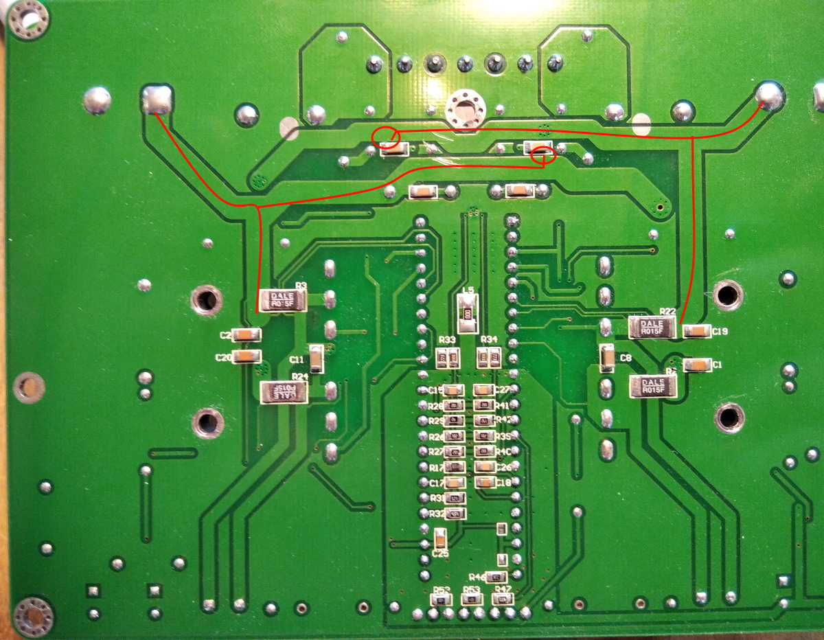

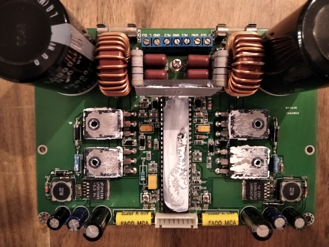

I inspected the boards and noticed a burnt C on the underside of the V2a board. I want to replace it. But it is not numbered an not specified in the schematic.
Anybody know the value of this C ?
I attached a picture of the board and the burnt C.

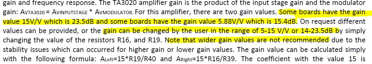

Setting gain factors.
The boards have different gain (V2a has apr. 8dB more gain). I´d like to set them to the same gain.
The manual says "changing the value of the resistorsR16,andR19."
edit:
The manual numbers are wrong.
see my answer #7

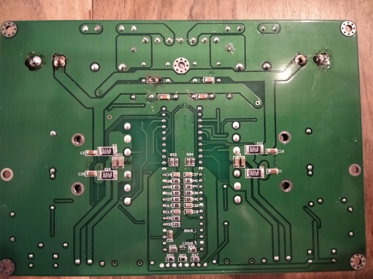

Another top and bottom view, to locate the broken C.
I´m not good at reading/understanding those layouts.
But as far as I can see, the broken C sits on the V- line with C19 and R22 on the underside. But I can´t see the other connection that pulls through to the topside.

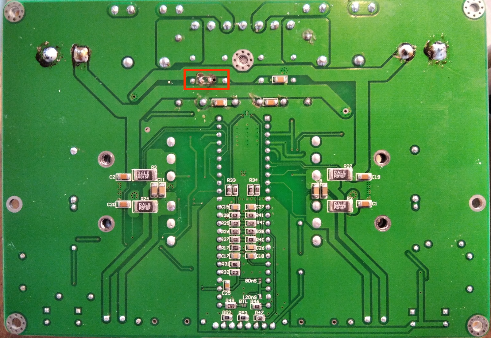

I removed the C from the other line and measured it to be 100nF.
So I´ll just put a new 100nF in.

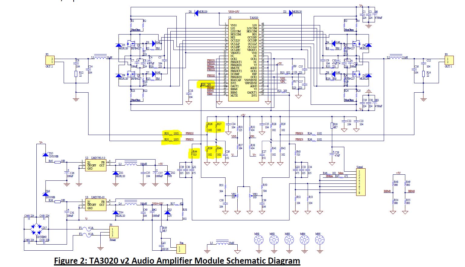

The only question left is th gainfactor now.
I think the R-numbers in the text and in the schematic are mixed up or not belonging together.
Anybody know which resistors I need to change ?

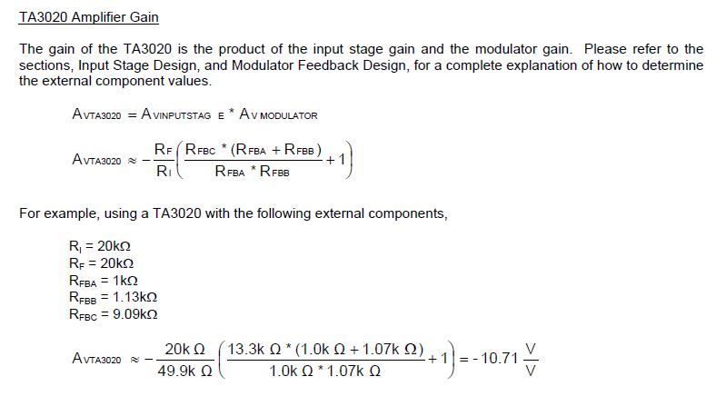

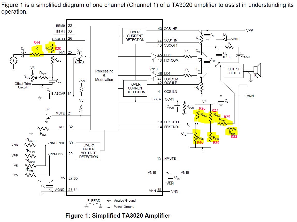

I took a look in the TA3020 datasheet.
I think I was able to relate the datasheet names to the Connex layout R-numbers.
I wrote the Connex R-Numbers into the Datasheet.
Is this right ?

As far as I can see, the burnt C is in the V+ and V- line.
Because it is connected to the +/- of the big 10.000uF C and to C19+R22 / C2/R3
This is a picture of the other board. (easier to see without the smoke on the pcb)

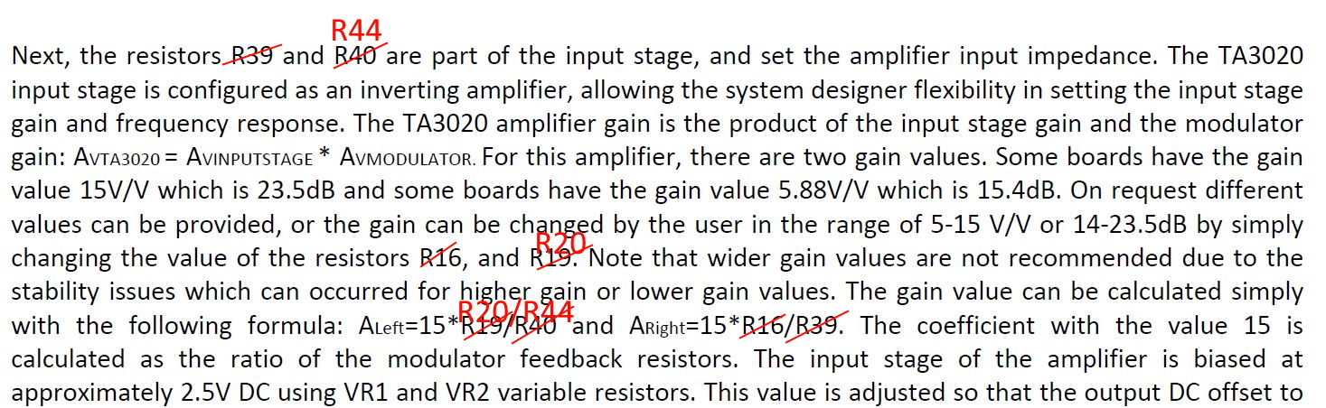

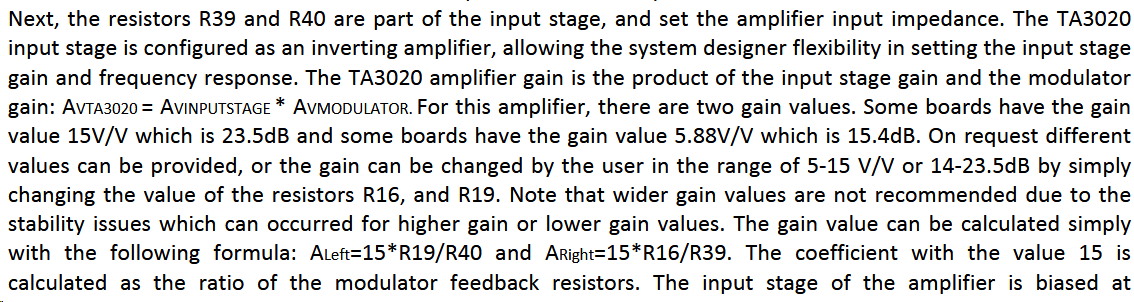

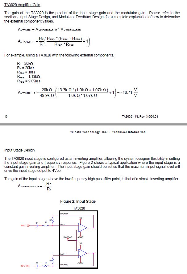

I think I understand the gain setting now.
I think Connex just changes Avinputstage. So it´s RF/RI and Connex just changes RF. RF should be R20 in the connex layout.
The Avmodulator part is the factor 15 in the connex text and therefor doesn´t matter for me.
I corrected the numbers of the input stage in the connex text how I think they should be (just for the input stage of one channel)
So: I think I should just change R20 (and R23) for setting the gain in the input stage.
Can anybody confirm this ?
I´ll check the R20 values on my V2a and V2b board and see if they differ.

Umm .. R's 5, 6, 15, and 16 have nothing to do with gain -- they're 'Gate stopper's controlling the MOSFET turn-on behavior. The different values (5R6 and 27R if I'm following correctly) would be needed for different p/n's.
R19 is the Gate pull-down for Q4 (sinking device, ch 1). It assures full turn off since the turn-off diode can't take it all the way to ground.
Wouldn't it be a lot safer to just put 8 dB pads ahead of the inputs to the board that has higher gain? There are resistor values affecting gain that WILL NOT be stable, and you don't have an accurate schematic.
Just my 2 cents ..
Regards
edit: Looks like I'll have to study posts 6 and 7 that came in while I thought about this one.
I know. The values are given in the connex text.
I only want to change the 15.4dB gain board to the 23.5dB gain of second board.
They are the same boards just with a different gain setting from stock.
If it works on the second board, I can see no reason why it shouldn´t work on the other board.

I don´t know when the 100nF C burned. (It burned the connection to the pcb track as well.) The amp was working till I opened it up to change it to BTL mode.
So maybe they burned 10 years ago or just a couple of days ago. I don´t know.
Those C sit in the V+ / V- rails (50-60V)
I have now ordered Vishay SMD condensators with 100V max working voltage.
I measured the input stage of both boards:
So, ich habe jetzt die Widerstände der Eingangsstufe ausgemessen.
Meine Zuordnung scheint richtig zu sein.
V2a: 47k / 47k which is 15V/V gain
V2b: 20k / 47k which is 6,4 V/V gain
(data sheet says gain range from 5-15V/V is stable)
So I´ll bring the V2b to 47/47k as well.
