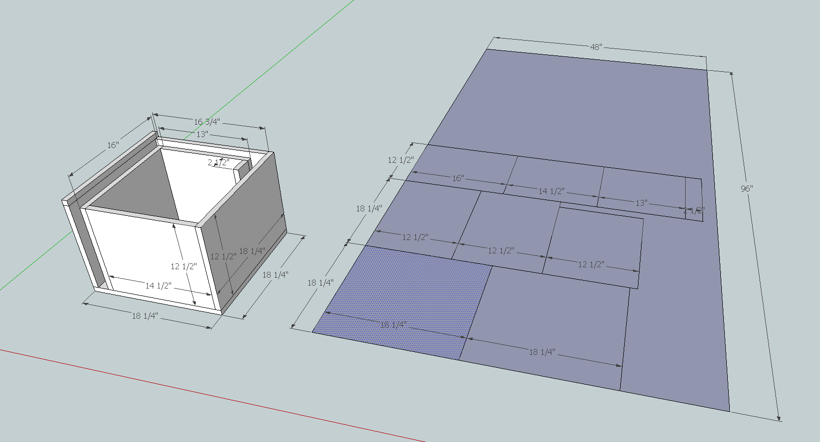

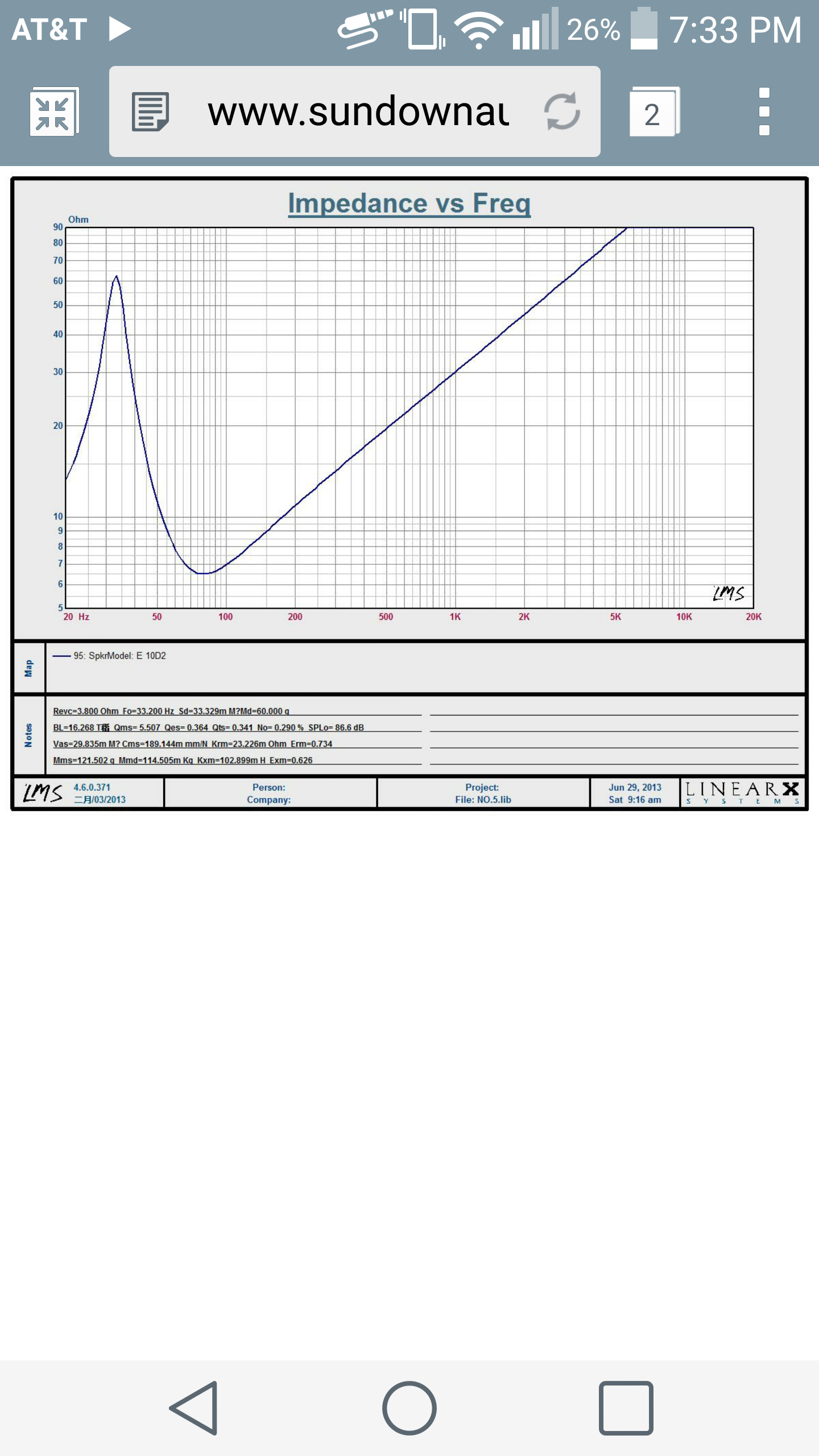

I plan on ordering a sundown audio e10 dual 4 ohm, but I can not locate a plan sheet for the woofer box. There webesite has enclosure plans but(1cbf, 35 hrz)but I can't download it on my cell or desktop because I can't download Google sketchup for some reason.
Does any one have any ported planes for this subwoofer or help with the design. I have tried to designs my own sloted and ported but crazy port lengths come out and ther is no way to shove those ports in a 1cbf box.

You can reduce the port cross-sectional area (to make it shorter) or have the port external to the enclosure.
Thanks so much Perry. These are great planes just what I was looking for. Did this come off there website?
Yes. Try to get Sketchup downloaded and learn to use it. It's a great program. There's a short tutorial on my asos1 site. Chapter 10.

Yea I'm go in to try and download it again and thanks for the help. One thing I don't get the box from they website is about 2 cbf and they list a ported enclosure at 1cbf. Things like that confuse people. Man I I need to get winlsd.
