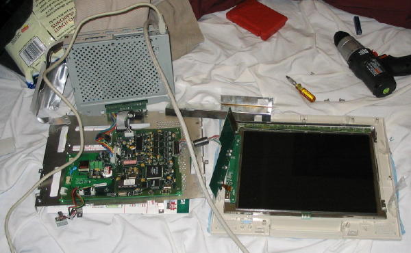

I've been lurking here for about six months, tried and failed to make a projector with a 5" car lcd, and now I'm going the stripped monitor/ohp route. I got a converted Wyse Winterm client pc with a 12" SVGA panel, which was actually really easy to strip (took less than three hours, and no little flex cables in the way! I also managed not to break it, which was good) The panel is a toshiba, and I don't know the response time or contrast ratio, but I'm hoping they're good. I got the whole thing for $100, and I don't plan on making it much bigger than 75" diagonal so it doesn't have to be perfect. Anyway, I have two questions for you worthy inventive geniuses of this forum.

I'm going to try to attach the picture this time. Let me know if it works.

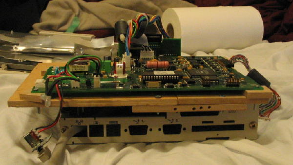

Also, I've done a little work on putting my pieces together. I took the metal box and screwed the controller board for the lcd onto it with a piece of wood in between. Next I'm going to try to build a box around it, then mount the lcd onto another piece of wood. Should I add a few fans to keep it cool? How high off the stage can the lcd be before you can't focus the image?
Here's a picture of what I did with the metal case and controller board:

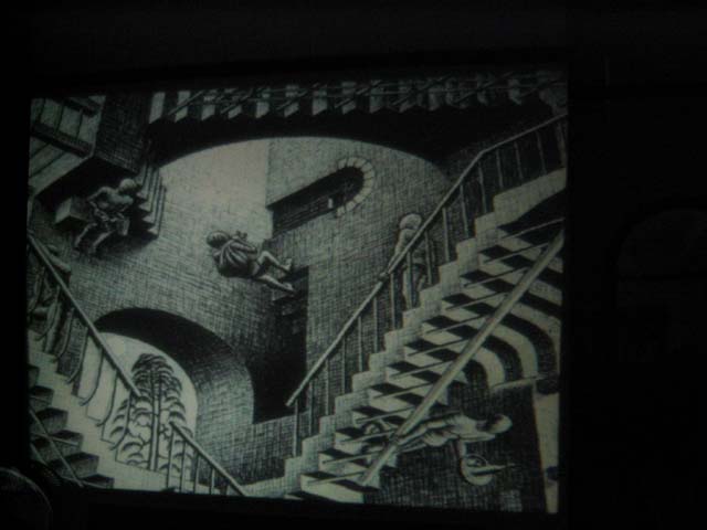

Well, I ended up going to my college's media services office and they let me borrow a crappy Elmo overhead. It's portable and folds into a suitcase, but it uses a 300W bulb and just s singlet lens. Also, since it's portable, the focus options are limited. But I managed to get it to work decently well. Here's a screenshot of my desktop (an escher drawing) with the lights on:

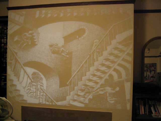

The image is about 50" high and 65" wide, so that's a diagonal around 80." Not bad for a college dorm room. It's projected onto the stucco walls, which aren't that bright, and I'm hoping to make a diy screen for it in the near future. Here's the desktop with the lights off and almost all ambient light controlled:

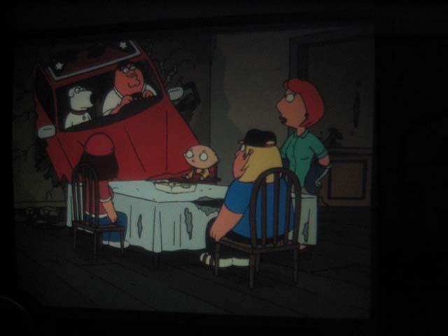

Here's some family guy. Animation seems to work the best. Live action movies seem to get really low-contrast in the darker scenes and get some solarization, especially with skin tones. Is this because of the weak overhead projector, or is it a problem with the panel? Any input would be great. Thanks.

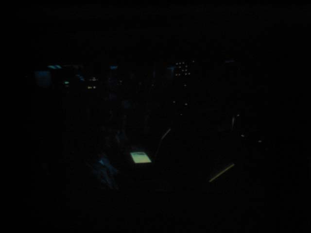

I tried Top Gun, and was really disappointed because the dark scenes really didn't come out. Everything just seemed to blend into a neutral grayish color and I couldn't see much detail. Here's a scene inside the aircraft carrier near the end of the movie:
While the actual image isn't quite as bad as it looks from the photo, it's still not as good as I would like it to be. Please let me know if any of you have any ideas about how to improve contrast and brightness. (I know a better projector would be nice, but right now I have no way of getting one.) Thanks!!

HMmm
Anybody who knows better feel free to kick me in the man-lumps and correct me. 🙂
I belive the 'dark scenes blurring into a blob' problem has to do with contrast.
Thats the 300:1 or 450:1 type numbers you see on LCD specs, the higher that first number, the better the contrast.
and the better it handles 'near black' sitations/RGB.
the lower that contrast number, the sooner the LCD says 'okay, thats black!' when in fact,there might not really be any 'black' there, but more of a 'near black'
for example, a 500:1 LCD panle does pretty darn good.
whereas a 200:1 LCD is utter crap, and is likly to really choke on any dim scenes whatsoever.
I'm pretty sure thats correct.. There are threads on the forum you can search for to find out. (which is where i got my info, just re-iterating what i remmeber)
also, LCD response time is important too. 30 MS response time (also refferd to as a sum betwene pixle rise and fall response, or rise/fall typical/average) is pretty bad. some people say they can get by with 25 or 20. but i'm currently looking for a low response time LCD with a moderate contrast (450:1 at least)
(mine is going to be for games and movies)
Response time has to do with how fast pixles 'change', IE: going from one color to the next as there is motion on the screen. (remember really old laptops, and the nasty smudge effect when things moved around? thats the response time, it was pretty nasty and high back then)
Thats all I can think of. and FAIK I might be completely wrong.
Thanks for your response Hudson. I already know that contrast ratio and response time are the most important things to look for in a panel, and I know I picked a panel without being able to find out what those two values were. I'm in the process of trying to figure it out now, but the tech team at Wyse have no clue and the toshiba panel I tore apart doesn't have a model number on it that I can find. However, when I look at the panel when it's sitting on the overhead, I can make out all the dark details and it looks much better than when it's up on the wall, so that leads me to believe the issue is with the overhead and not with the panel itself. Since I'm only borrowing the overhead temporarily until I can get something better, for the moment I would just like some advice on the little things I can do to improve the contrast, (i.e. screen construction, minimizing ambient light, screwing with the controls on my computer, etc.) If anyone has any techniques to improve contrast and brightness with either software or parts other than the projector itself, please respond. Thanks!!
Also, if you look around the forum, you'll find a lot of people of the opinion that a 200:1 contrast ratio is actually pretty good. Some even think 100:1 is enough. Most of the projection panels that everyone seemed to love so much had 100:1 or 200:1 at the most. I'm hoping the panel i'm using has at least 200:1, but I won't know until I can get a good datasheet on it. If anyone knows a good place to get datasheets on Toshiba LCDs, please let me know. Thanks!!

I'm still looking for a VGA box and help with trying to make the picture look better. Cartoons look great, but movies are still difficult, especially with the dark scenes. The image looks really nice on the lcd screen itself sitting on the projector, but when it gets to the wall the details disappear. Is this because of the panel or the projector, or the fact that I'm not using a screen? The difference is really quite dramatic, and I may even post pics at some point to give you a good idea of how it looks. Thanks for any help you guys can give me!
I finally found the specs on my lcd panel. It's a Toshiba LTM12C275A.
Res: 800X600
CR: 250:1
Response Time: 40 ms (slow, I know)
Color Depth- 6bit (256k)
So the contrast is pretty decent, so I'm really confused as to why the picture on the wall still looks so bad. And even though the response time seems slow on paper, the panel handles full motion video just fine.
So the issue still remains: why the lack of detail in dark scenes?
