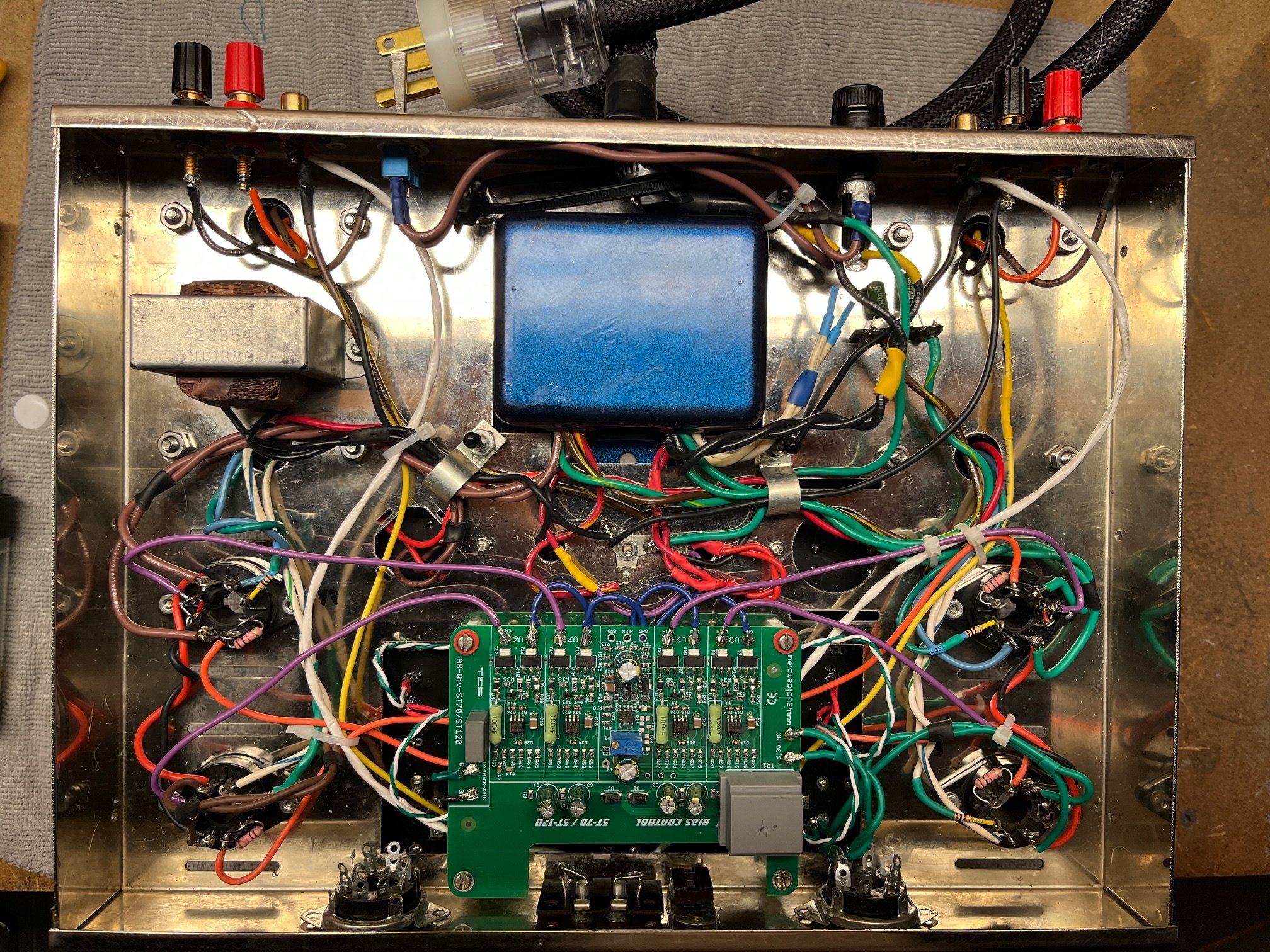

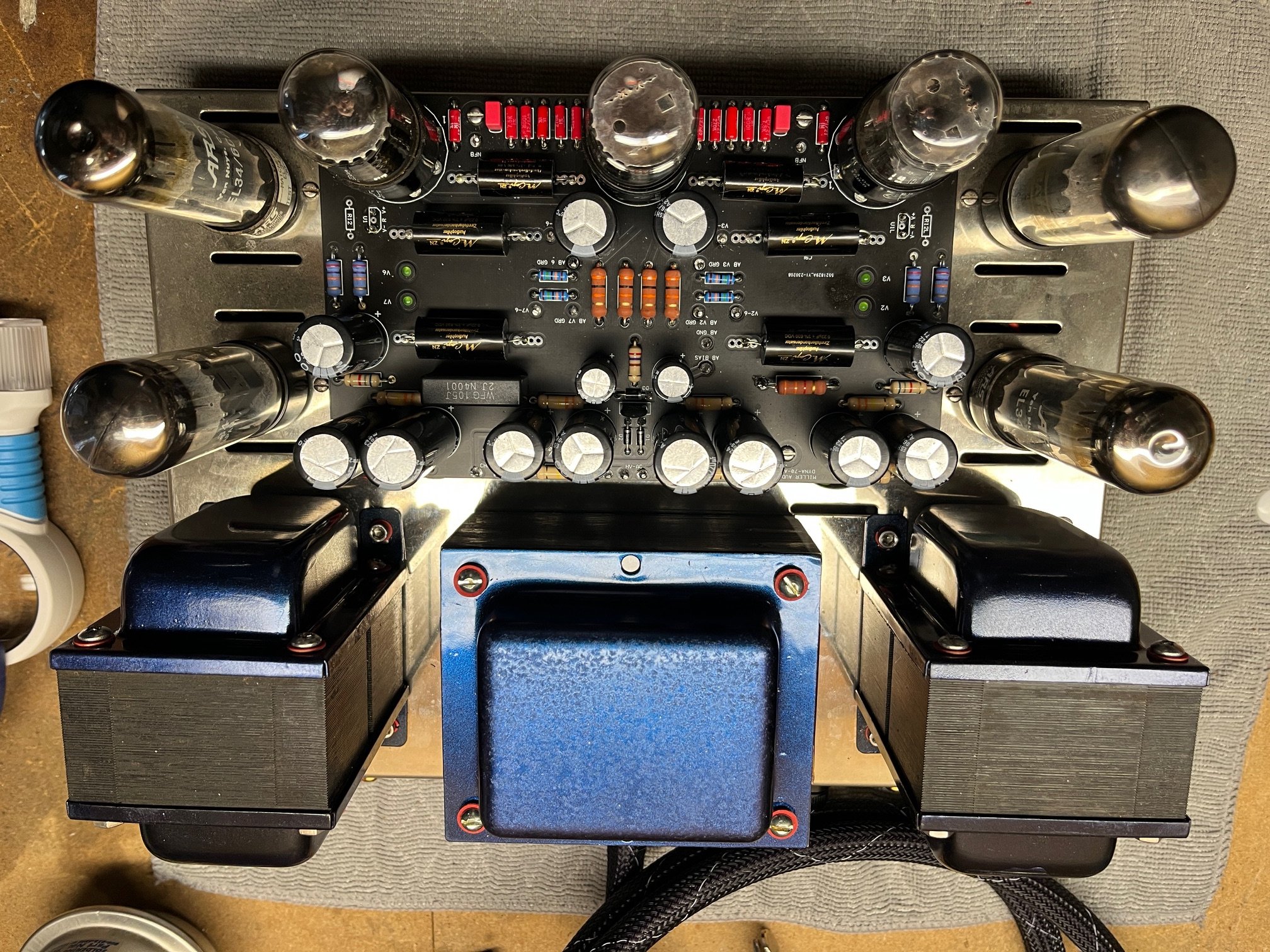

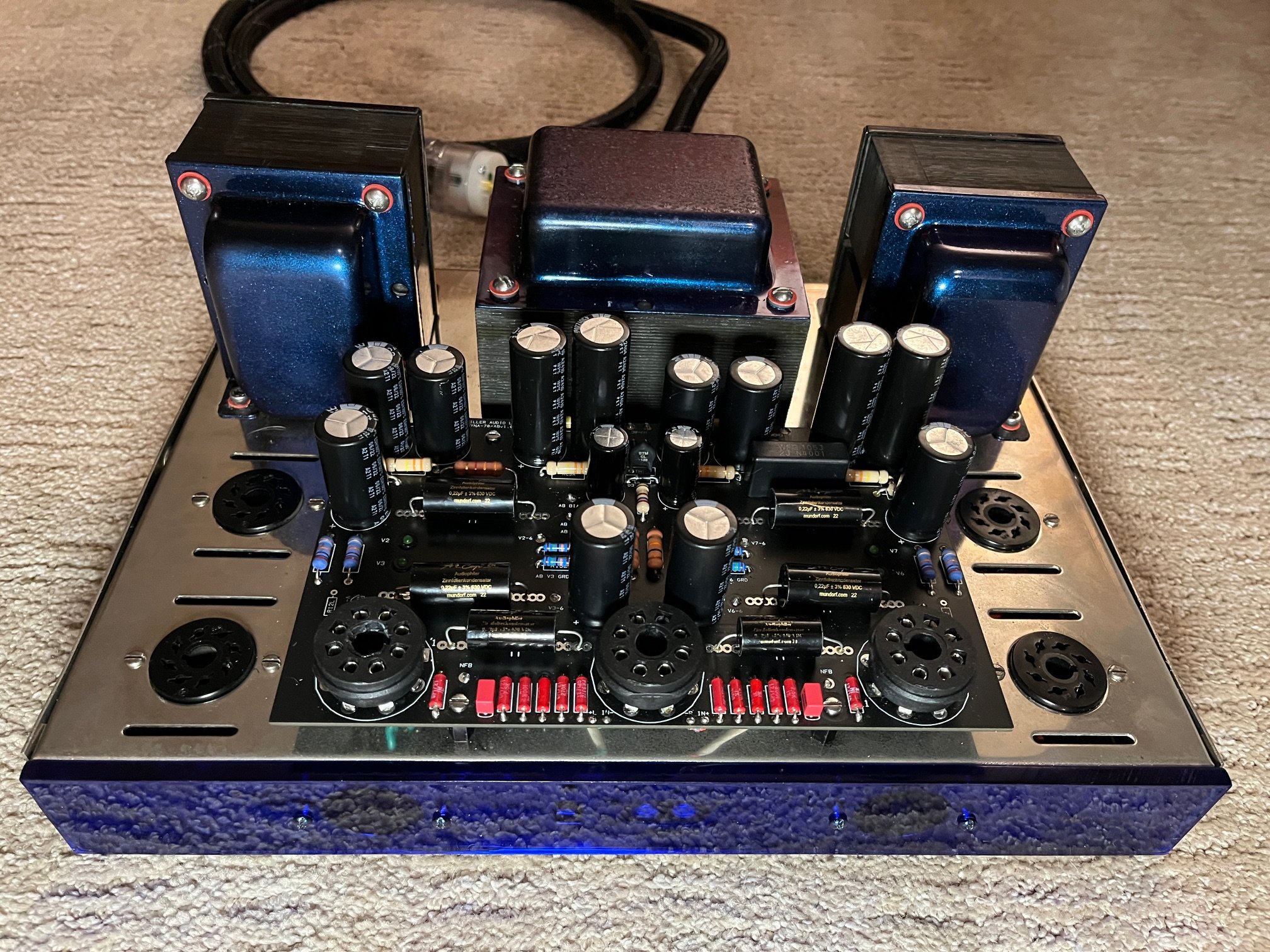

Attached are pictures of the amp. In the photo of the internal wiring, note that the long "s-shaped" white wires connecting the RCA jacks to the circuit board have been removed (to rule out the RCAs and that wire as the source of the noise.)
