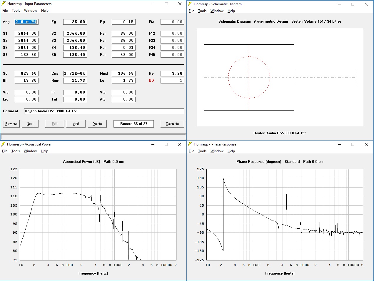

You'll get 110db unfiltered at 150watts in a 151 liter BR, I would probably use a simple 12db/oct LP filter up top. Behaves well to ca 300hz, cross below this. (Only because of the cone construction and material)

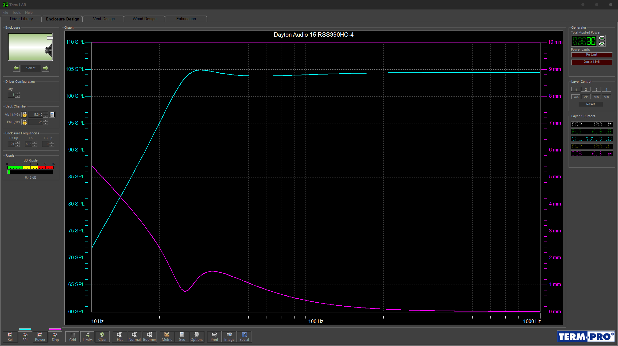

Have a look at this sim and see if it's interesting.
FYI I think there will be no bump below 30hz because of the resistive behaviour of the slot port, it will probably just be flat-ish and roll off slow from 22hz down in-room.

If you want you can post desired dimensions here, and I can run the numbers in hornresp, and check how it will work out.
Do you want a finished calculation, or do you want to figure it all out yourself?
For 150L Im getting a slot port of 2" tall by 17" wide by 18" deep. Think that's ok?

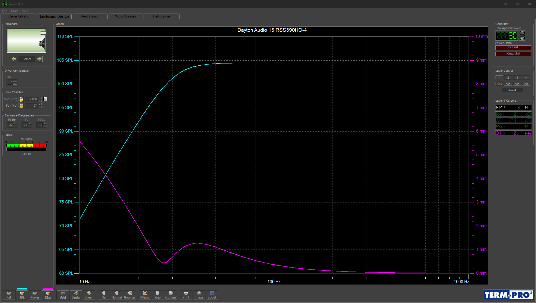

Also, when I kick the box down to 3L I get the following curve response. The 90L vs the 150L I can't seem to see much benefit of making the box bigger. I feel to receive a real benefit I have to make the box MUCH bigger than 150L which I just don't have space for.
Do me a favor, take look at these and tell me what you think. It's what I get in Term-Lab at 30w vs. what I get with 30w with 150L.
Do you think my software is off or I'm doing something wrong? Are you just looking to keep that 30hz up? Would I be able to baffle step correct my smaller box to work? I don't think I'll run more than 100w through this. I just need it to sound big enough to fill a room that's 25ft x 25ft.

Note, I am looking for a flat response! So I'm not necessarily in search of a bass bump however, don't mind one.
Pics attached.
