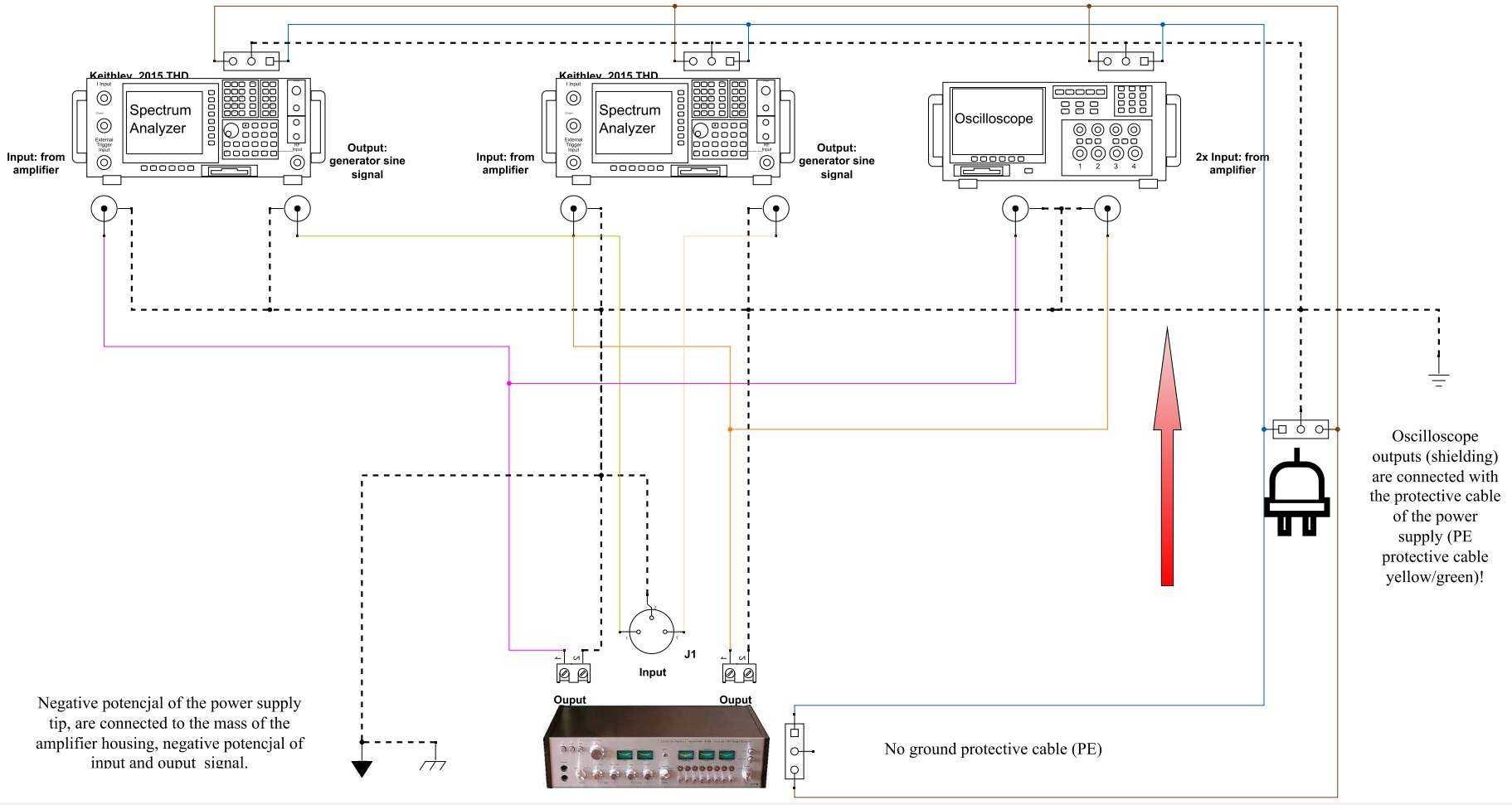

I have a problem with Keithley 2015 THD. On the first output of the generator, I do not have a sinusoidal signal, but on the second channel I have both a sinusoidal signal and pulse (of course, switched not at one time). What could be the cause of the fault? Is there any service documentation with diagrams of this meter available? Where and what should I measure?
I bought this meter as used. I wonder if by connecting a signal from the generator to the tested equipment and at the same time having a connected oscilloscope, with a short circuit with a PE wire, it can work correctly? Could such damage occur as a result of a short -circuit of the negative potential of the generator with the Protective Power of the PE? The easiest way to write a question is: can the generator output sockets be connected directly to the PE protective cable? Because I noticed that they are factory isolated from the metal parts of the meter housing and probably for a specific reason.

It has been 18 years or so since I designed that, so things are a bit hazy. As I recall the direct digital synthesizer had both a square wave and sine wave output and that is what I used. Nothing on the sine output but both on the pulse out? Sounds like, maybe a bad connection to the BNCs on the back.

1. I haven't worked for Keithley since 1999, so I don't know what there is. It is almost certain that they will not share schematics, and I don't have any.
2. Not sure about this short you refer to in question 2, but the 2015's circuitry is isolated from mains via a transformer with a triple faraday shield, so it probably would not cause damage. I'm not clear about what a PE is. Could you attach a sketch of the setup you had?

I am sending a primitive scheme that I was able to do. I hope that it will see how the connections look like.
Namely:
1. Keithley sinusoidal signal outputs are connected to the input of the audio amplifier. One to the right channel the other to the left canal.
2. The audio amplifier signal outputs are connected analogously to the Keithley left inputs to the first right to the second.
The last connection or oscilloscope is troublesome. The same audio amplifier signal outputs are connected to the first and second oscilloscope channels to track the shape and level of the test signal generated by Keithley when measuring harmonic distortions.
The construction of the amplifier is made in such a way that the mass of the input audio signal and the output mass and the metal housing of the amplifier are connected together and are on the same potential.
The supply of an audio amplifier is a two -wire (flat plugin without entering the plow) and the PE protective cable is not supplied to it.
This is the opposite of the oscilloscope supply where the power socket borea is connected directly with the BNC socket screen.
In Keithley, the entrance and output nests are fully isolated from the Earth and the PE protective cable.
And now we reach the main point of the topic: by connecting an oscilloscope to the output sockets of the audio amplifier (for imaging the shape of the test signal) at one moment "I ground" and cause a short circuit to the PE cable power socket 230V, all BNC cables from the Keithley generator and masses of input and signals output audio amplifier and its metal housing.
Am I then able to damage the Kethley Audio amplifier generators and how does this affect the measurement of distortion?
