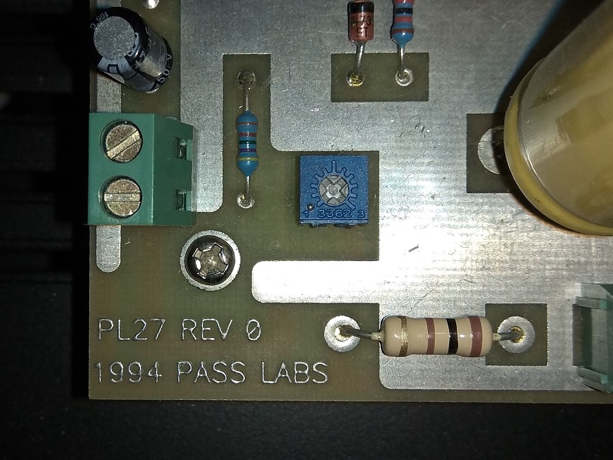

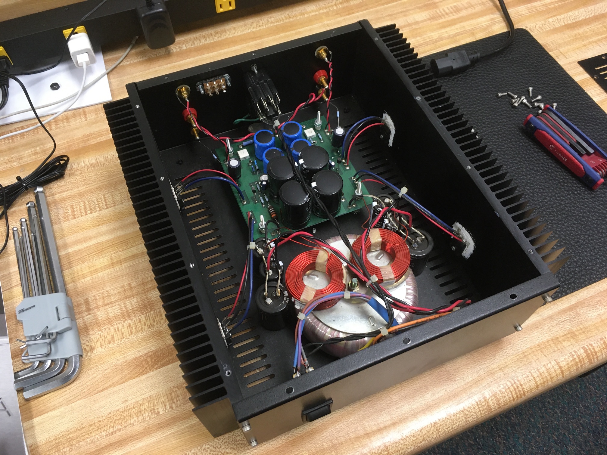

I tripped across this amp the other day, but passed on it until I could confirm some info on it.
It is a Zen, that I know. I was led to believe that is was built by Pass Labs (not a kit) and that it won some HiFi competition in the 1990's.
Can anyone shed some light on it? There are no markings on the case, only on the board as pictured. Thanks!

Certainly does not look like a Pass Labs in house quality build. The Zen amps were designs released by the master and were built by hobbyists all round the world. Your photo quite clearly show it was built "at home" by someone.
Could be a Pass Labs derived pcb, although I don't remember it as such.
Looking at the Zen amp article, there was a published pcb by Nelson - not sure where one could get it though.
Maybe Mr Pass can shed more light on it for you, 25 years or so ago since the design came to light.
The builder has added more PSU caps and inductance to make it a CLC PSU - not as per original design either.

Gee Wayne - very experimental. I bet your current prototypes are put together way better than that one. As long as it works, that's all that matters, I suppose.
Yeah, those blue RN55D look pretty nice.
This looks to me like the "Return of Zen": https://firstwatt.com/pdf/art_zen_redux.pdf
Thanks Dennis, I see from the schematic in your link that there is a CLC PSU - something not seen often in Pass designs. Maybe the amp is a true Pass prototype as Wayne has mentioned, if so it would be worth having because of that.
The board does say Pass Labs right on it, so they must have at least made some "official" boards.
Here is a link to a similar one. Same case, slightly different build:

I'd love to get my hands on one of these artifacts. I think prototypes are little works of art. 🙂
You might want to contact Tom V. One was found in storage and
brought to BAF last year.
