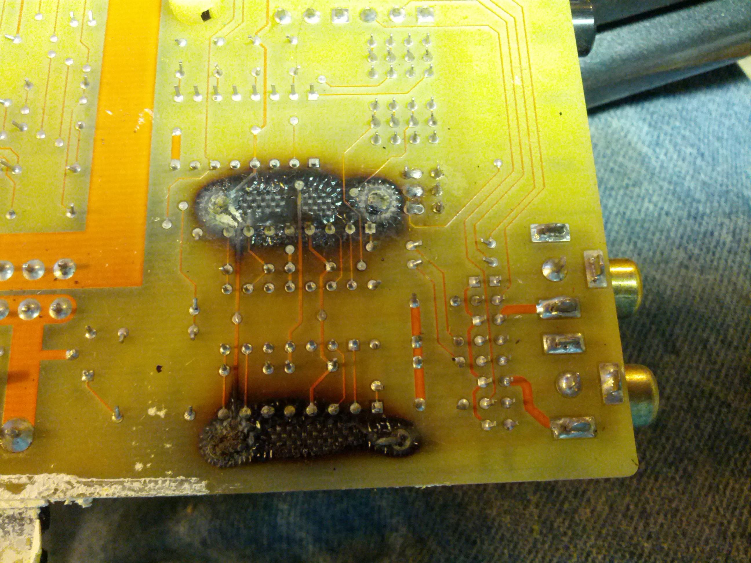

Hey, new guy here looking for a little help with a PPI PC1400.
I'm new to electronics, but I want to fix my PPI PC1400.
I want to start out by replacing the visually damaged and missing parts.
From what I can SEE, this is what I'm dealing with. All damage is on the POWER side.
Blown:
9 IRFZ44 FETs (Non matching. Indicative of previous repair?)
9 resistors ( R7 R8 R9 R10 R11 R12 R36 R78 R167)
2 transistors ( Q25 Q53 )
2 capacitors ( C27 C125 )
Missing:
2 resistors (R35 R185 )
1 transistor ( Q26 )
I've been doing alot of research into fixing it, but I need a little bit of direction from experienced people.
If anybody could help, it would be most appreciated.
Blown:
Missing:

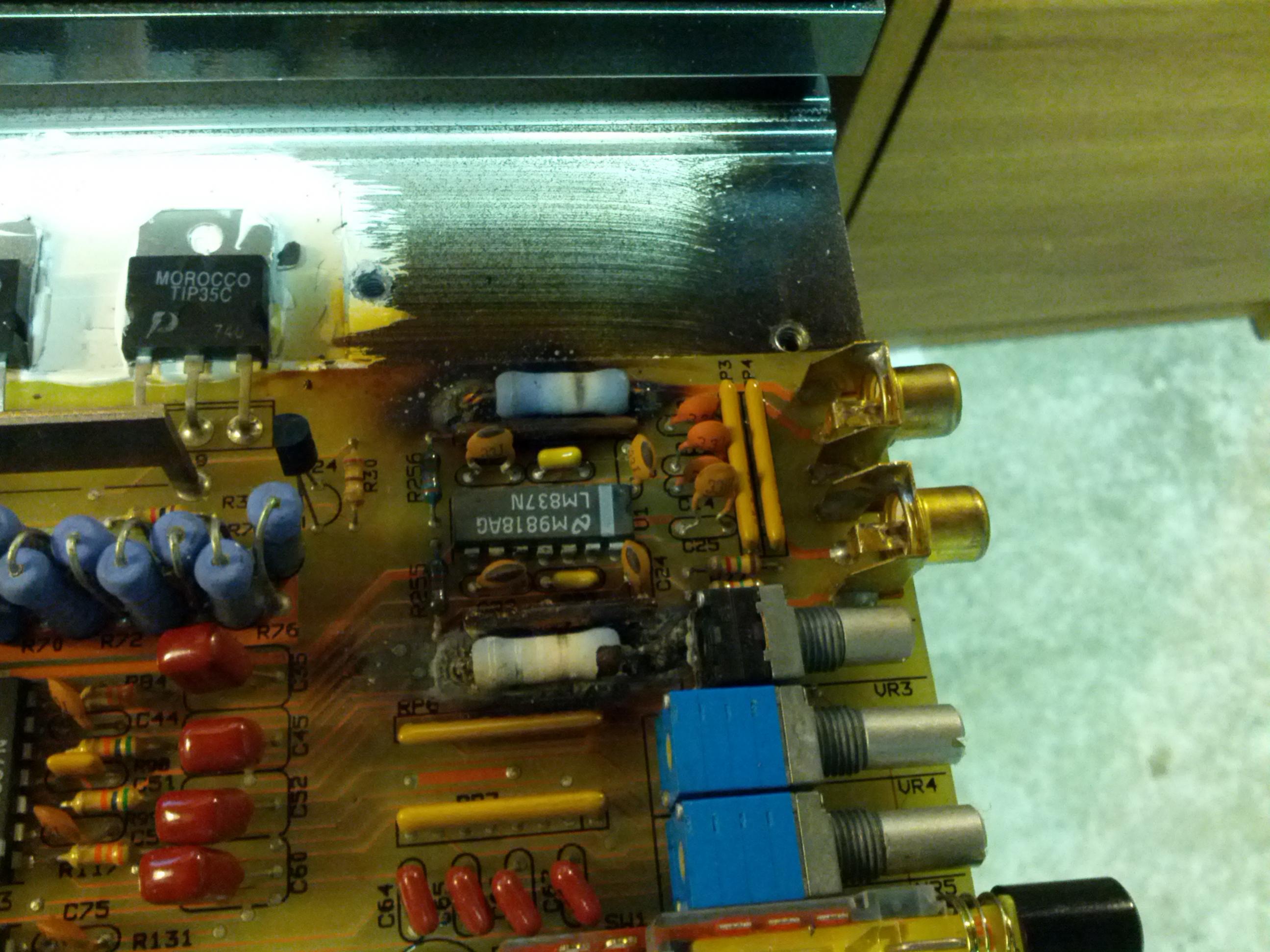

Power supplies rarely burn themselves out without there being serious issues on the audio side. By serious I mean blown outputs, blown regulators for the lower rails, bad caps, blown rectifiers, etc... The list can be endless and only teching it out with a ohm meter will get you the unknowns that may be lurking further into the repair.

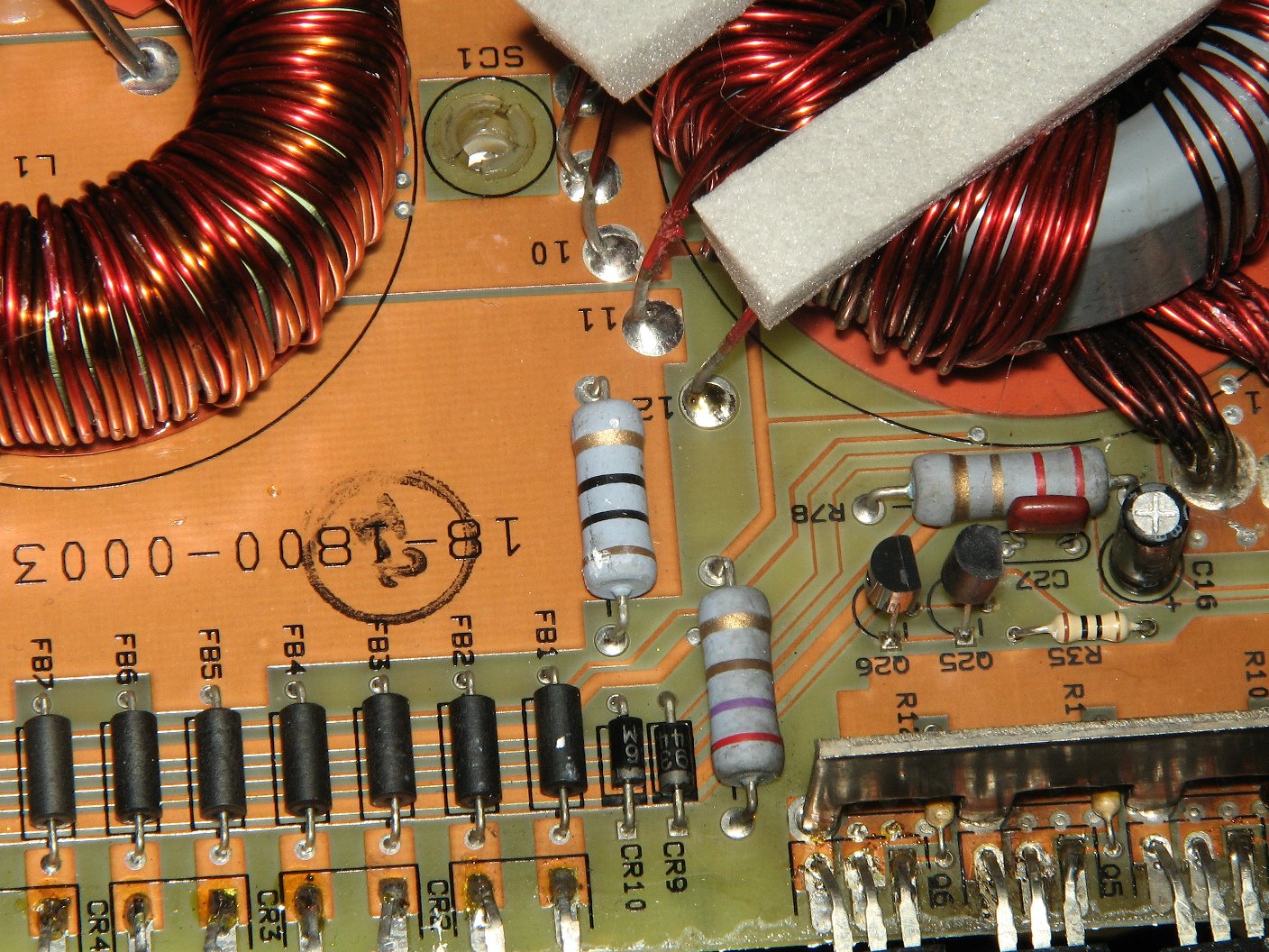

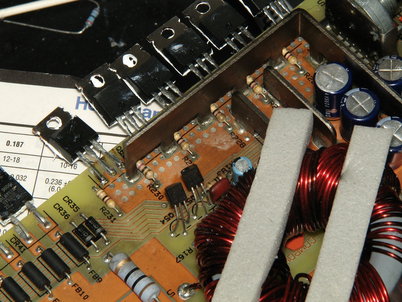

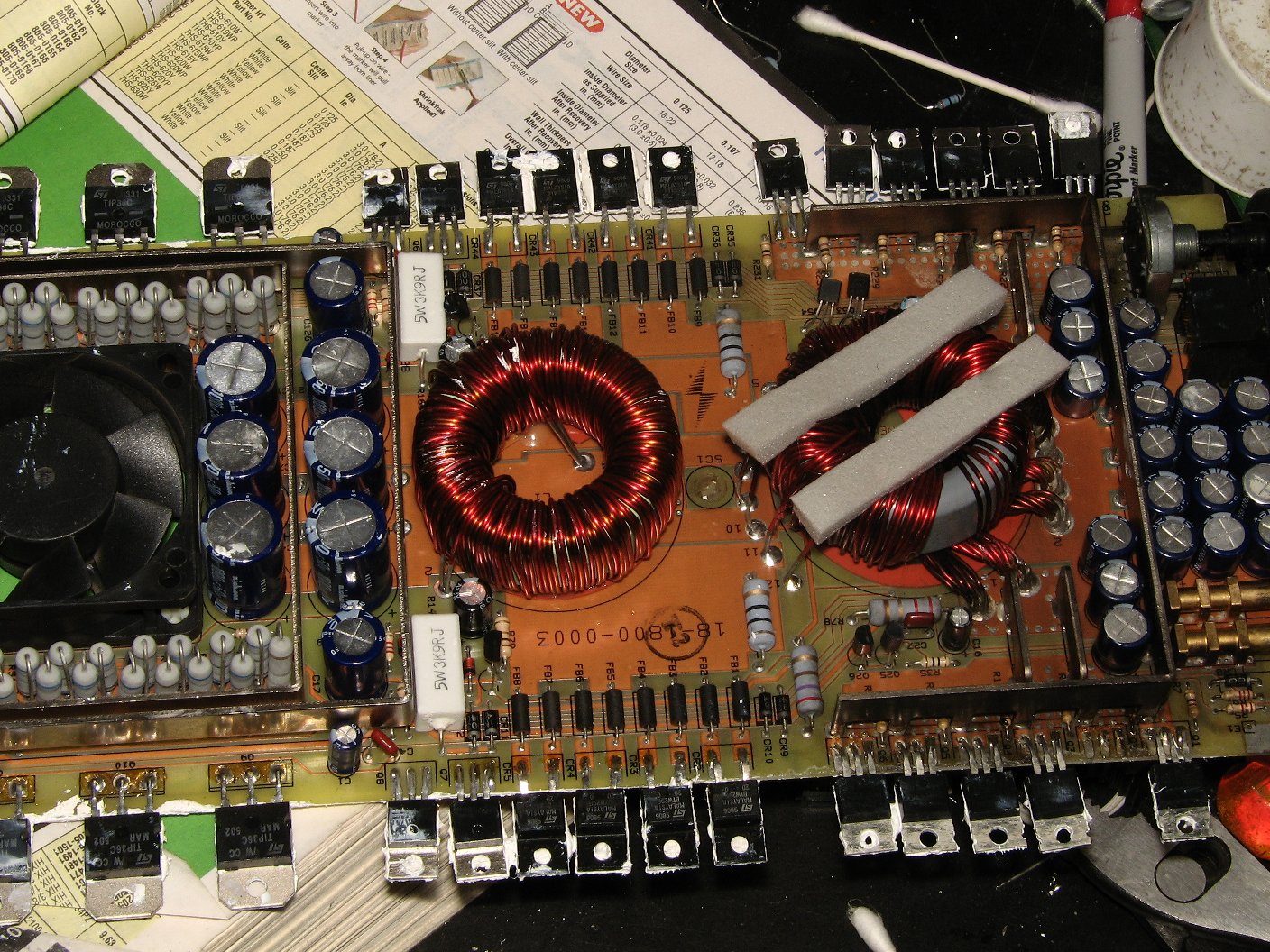

Well Perry sent me some pics I have uploaded to compare with. I will do a detailed parts list from your list and pics in my next post shortly...

here is your BOM of parts based on your pics :
12 each IRFZ-44N or 46N or 48N any of these will work. Q1 thru Q6 and Q61 thru Q66
12 each 47 Ohm 1/4 of 1/8 watt 5% tolerance gate resistors. R7 thru R12 and R226 thru R231 1/8 watt is smaller but will not cause any issues
2 each MPSA06 Gate driver transistors Q25 and Q54 Mind the lead placement the board has orientation marks to follow
2 each MPSA56 Gate driver transistors Q26 and Q53 Mind the lead placement the board has orientation marks to follow
1 each SG3525A PWM controller chip U5
All of the other components appear to be simply soot covered. A simple wash with acetone and alcohol should clean that soot off of them. Q-tips and or tissue wetted with either solvent will clean all of the soot off the board. If they look heat stressed and soot covered clean and verify they proper value and meter them to make sure they are intact and at spec. And please clean up the board by removing as much of the soot as possible, this will help you loads.
With the level of damage you have you might need to replace the PWM controller chip U5 . It is a SG3525A. These are fairly economical and easy to find. I suggest you order one and replace it to be on the safe side since your pretty much completely replacing all of the rest of the power supply anyway. I have seen them be damaged with this level of melt down, so better safe then sorry I say, and completely rebuild the supply including the PWM controller.
C27 and C125 seem to be covered with soot and not really damaged. I would clean them and meter them to check for proper tolerance.
R35 and R185 need to be metered and read to check that they are in tolerance before replacement is chosen. I think they are just soot covered, but you must meter them to see if they are functional and at the correct value.
I still firmly believe your going to find other shorted transistors in the audio section of the amp. I hope I am wrong but 99% of the time one thing leads to another and this amp may have failed a channels outputs and may have not been fused properly to cause all of this.
I had a client that consistently would run this series of amp at 2 ohms mono and no fuse at all. Doing this did the same damage that I see in yours. He never asked for a warranty. He just wanted it rebuilt about every 6 months for the same failure. Around the 10th or 12th rebuild the copper traces on the board gave out to the point it was futile to repair it any longer. Seen this a bunch of times over the years...sad..
Your BOM is most likely not complete because of all the other possibilities of damaged components in the audio section. Please meter out all of the diodes and power transistors mounted on the edge of the card in the audio section. And also find and use a 5 amp inline fuse to use when first powering up the amp after all the repairs are completed. This amps should only need 5 to 7 amps to start properly and then it should idle around 1 to 1.5 amps typical. Fusing it on power up will save you rework just in case you missed something else that was defective.
AND MOST IMPORTANTLY: you must either make some bar stock clamps out of simple bar stock, or you MUST place the bottom cover of the amp back on the amp to test the amp. This amp REQUIRES the bottom to be on to clamp the power transistors in place and without it they will not be seated properly and they will fail in a split minute if the power devices are NOT properly clamped to the heatsink.
Perry shows how to use a set of bar stock clamps in his tutorial. Again I can not stress this matter enough. please build a set of home made clamps and use them while testing ANY PPI amp.

Ok, so...
I'm just learning how to properly meter all of the different components. The output transistors are damaged as well, just as you said.
I'm going to do some more in-depth metering tomorrow. I'm just a little confused on transistor metering. I'm also learning about amplifiers at the same time, so identifying components is mixed in there as well. I'm doing alot of research as to not ask basic questions that can be answered by a search.
