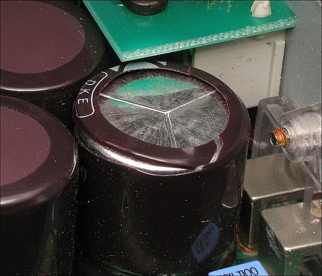

If the plastic tops don't go down then pop back up, the cap may be swollen. You'd need to remove the plastic disc on top of the cap to see if it has vented or is bulging. Don't remove any more of the shrink-wrap from the cap than necessary to get the plastic disc out (see attached).

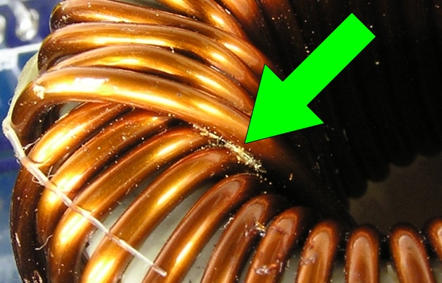

If you see something like the powder shown in the photo, the enamel is wearing through. This is often the reason the outputs fail. You need to get an insulator in-between the windings. I use 80lb test dacron fishing line. Get it around the winding (1 or 2 strands) and pull it up into the tightest place between the windings.

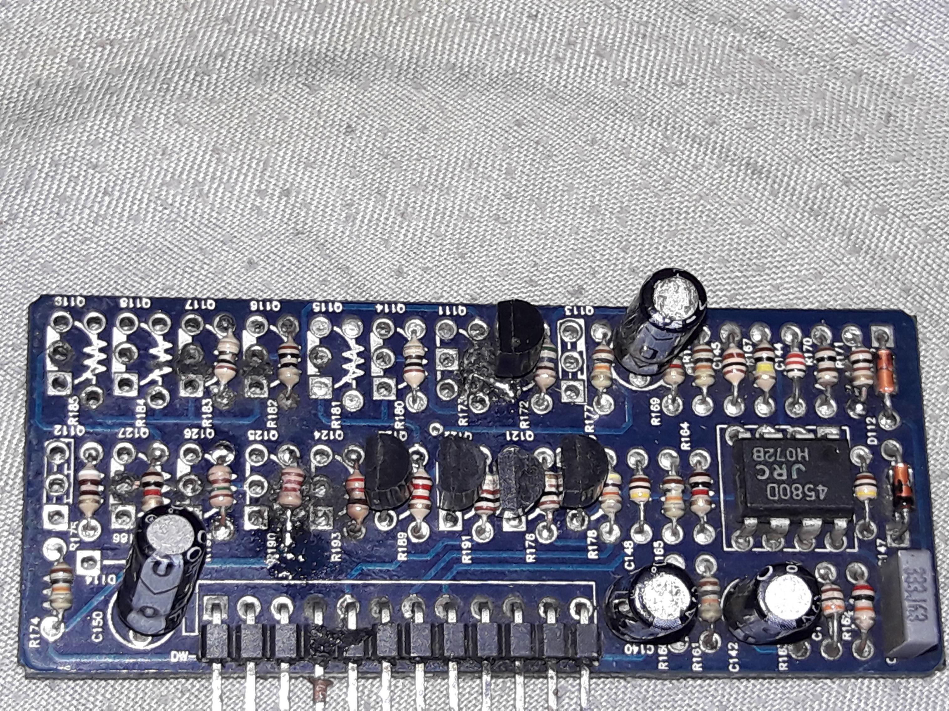

Good afternoon all i know this may not be the right place but still its worth a try. I am repairing a powerbass asa1000.1 mono block which is similar in internal construction to the boss 3000 amps. the driver board as well is similarly constructed but uses more components and some are slightly different. however my problem is that two resistors R185 and R184 are both burnt beyond recognition. I was able to compare the board to a boss driver board to successfully replace all the other burnt resistors but the boss dos'nt carry those resistors so i dont know what values to replace them with. Can anyone please help? I've added a photo of the board if it can help

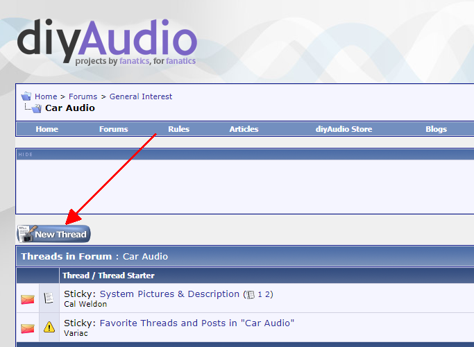

Please don't post in a repair thread that was started by someone else unless you are trying to help them.
Start a new thread.
Start a new thread.
Not offended. This part of the site has become a place where people go to get repair help. If there are multiple repairs in the same thread, it becomes virtually useless to those who need help.
