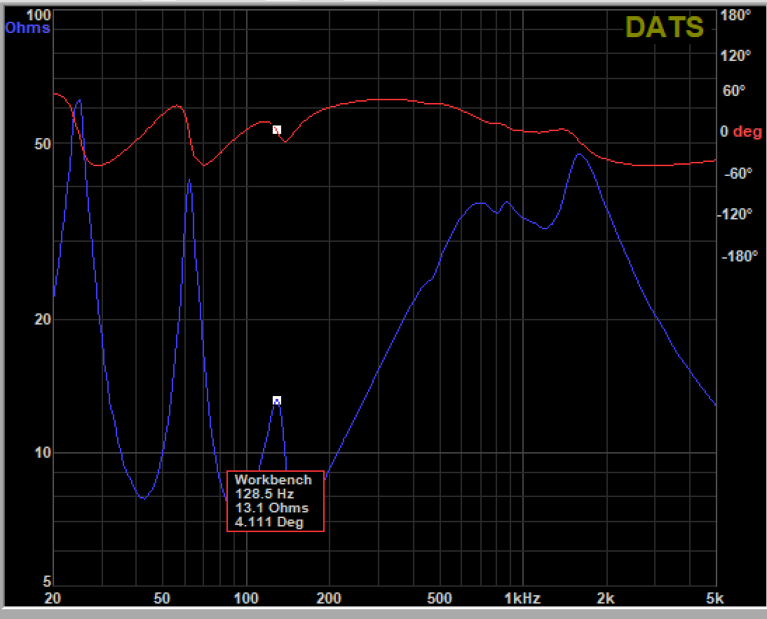

I ran an impedance sweep on the finished design and this is how it looks with no stuffing.

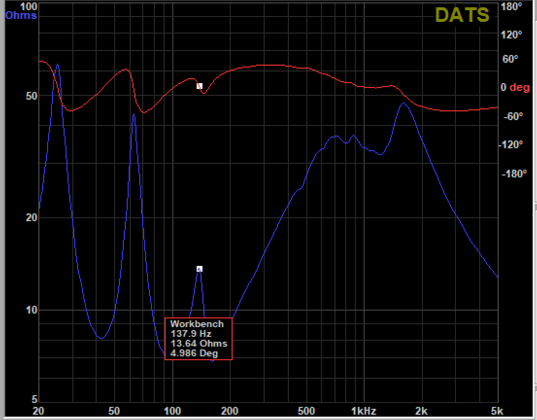

This is approximately what I'd expect. Resonance due to a standing wave of the longest dimension right around 140Hz. So I messed with putting a block of safe n sound insulation in the middle of the box, as well as trying a pillow in the middle of the box, and while they kill the resonance at 140Hz, a resonance shows up at 100Hz. See below.

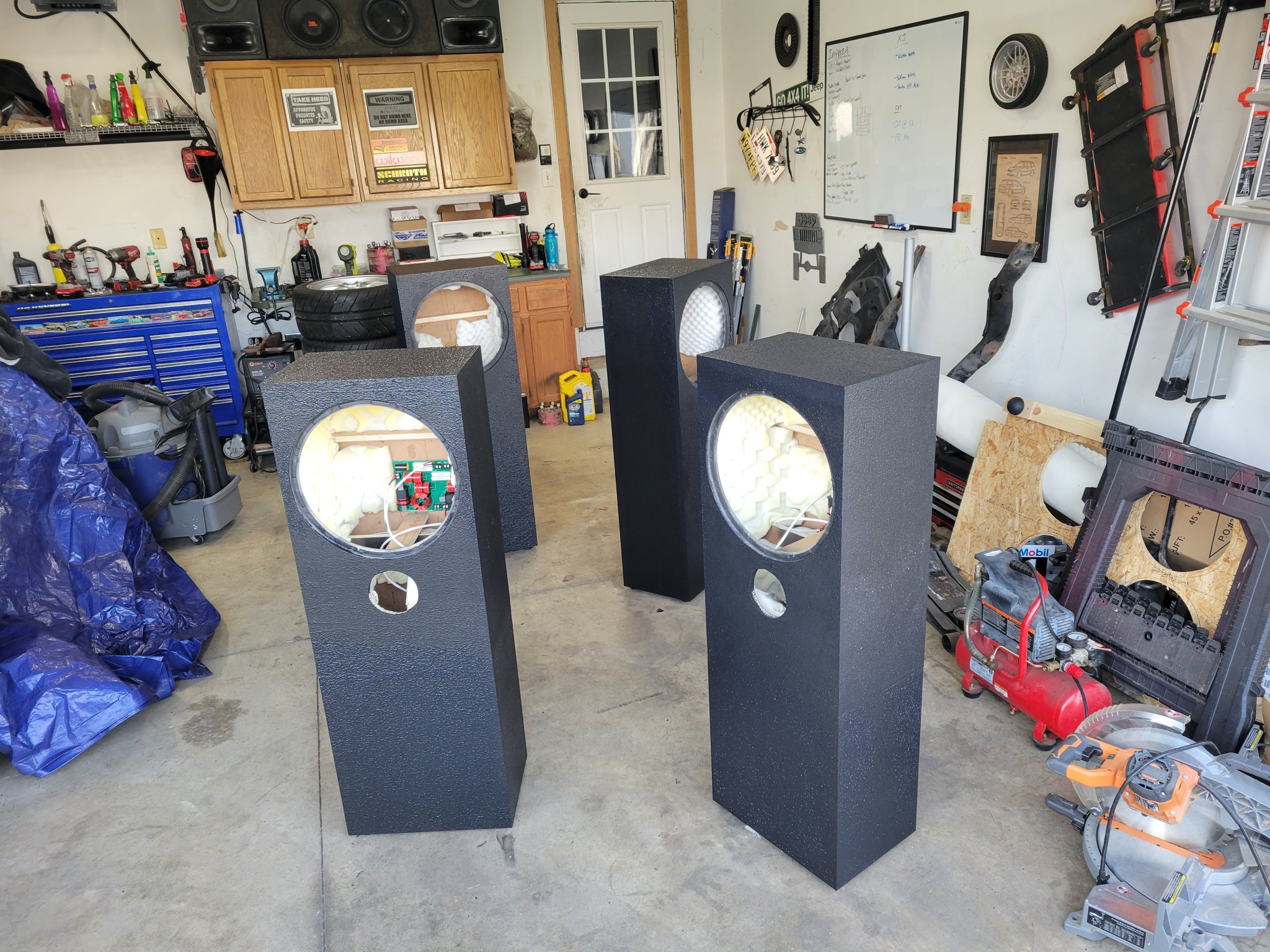

Here's what the box looks like. Right now the big block of stuffing is under the port by about 5-6in.

Hi, driver is probably top of the front panel? This would maximally excite the mode, while driver exactly at the middle would not, almost at all. I also guess the port is at the other end? A fix might be to put the port (inlet) at the top section as well, and fill the bottom of the box to dampen the resonance.
Resonance moving down in frequency would indicate longer path length, perhaps the safe'n sound in the middle makes like a wall, sound goes around it instead of attenuating.
So perhaps easiest is to put damping on the walls instead. Perhaps fill in the whole bottom half of the box.

Hmm, assuming the vent is the hole below the driver, then there's the driver/floor 'bounce' and a secondary vent/floor one, which creates a mid-bass notch in the response.

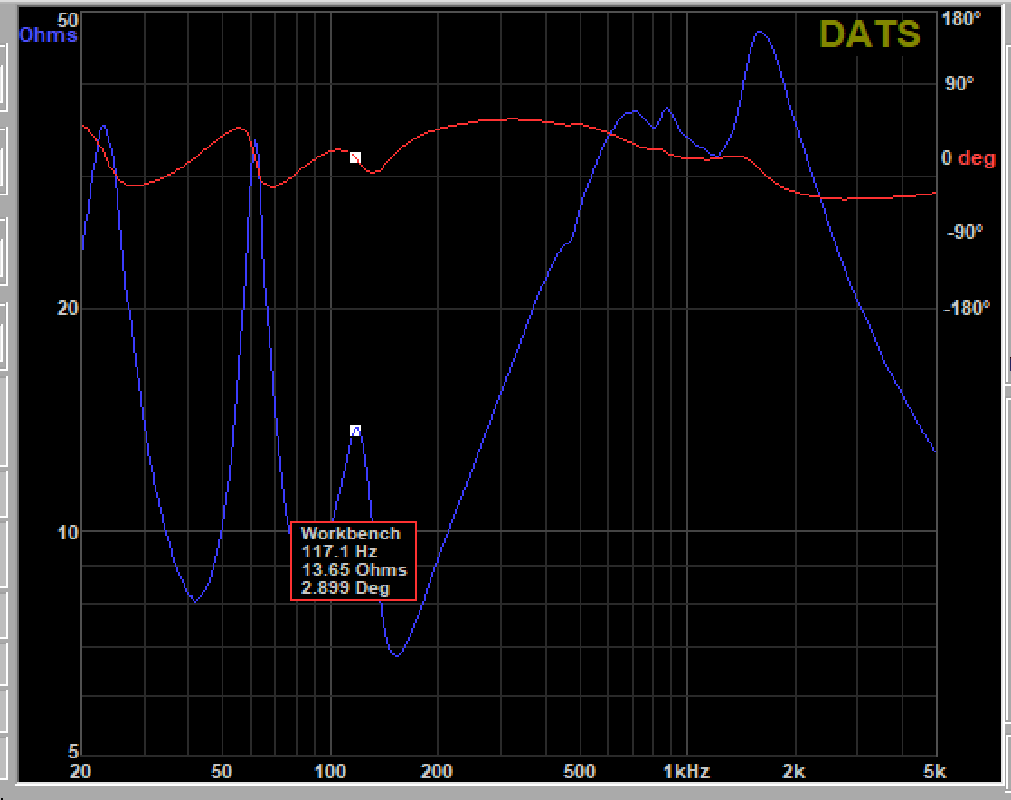

The impedance sweep with the resonance at 100Hz has the bottom 1/3 of the box filled with polyfill, plus a pillow at just below the halfway point, also filled with polyfill. Then some mattress topper stapled on all walls. Though I think the mattress topper probably isn't thick enough to really do anything...
The resonance still appears with the port plugged. So I don't think it's related to the port.Hmm, assuming the vent is the hole below the driver, then there's the driver/floor 'bounce' and a secondary vent/floor one, which creates a mid-bass notch in the response.

OK, HR sealed sim using generic 18.3 Hz/15" with minor full length damping shows notches at 100, 200 Hz, ~120 Hz impedance peak, so wondering if measurements are including floor/whatever resonances.........The resonance still appears with the port plugged. So I don't think it's related to the port.
My measurements are with the mic about half an inch from the cone. So I don't think floor or room interactions would show. Do you mind posting your HR sim? I was going to run it when I get home.
Several things could be at play. Filling the box extensively with damping material lowers the speed of sound in the filled section, lowering the fundamental resonance. A vibrating piece of damping might cause trouble too. But I fail to see why the rise in the impedance plot is accompanied by the drop in SPL. Just like there’s some kind of acoustic short-circuit at play.
you definitely want some damping directly behind the driver. Is there any chance that you took some of these measurements with the driver not secured to the box? I've found that a driver that is just set it the hole will cause a resonance around the 100-150hz area. I've had the most sucess with material behind the driver and at the very top and bottom, with nothing on the sides or back of baffle. The stuffing you put in the middle of the box is messing things up. You're losing efficiency around the second peak which is down over 10ohms and shifted from 57 to 65hz which shows to me that you are now interering with the whole system instead of just attacking the resonance.
