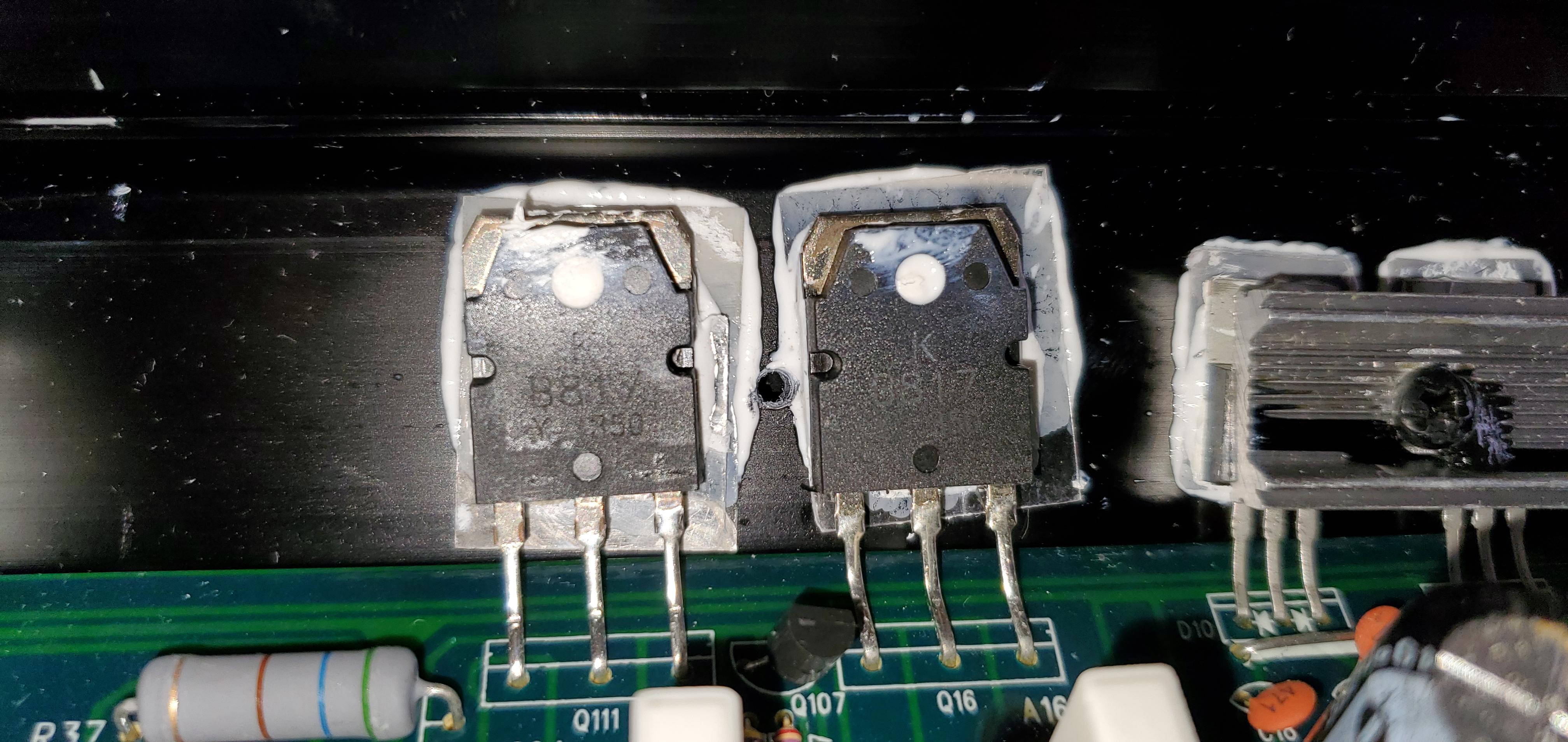

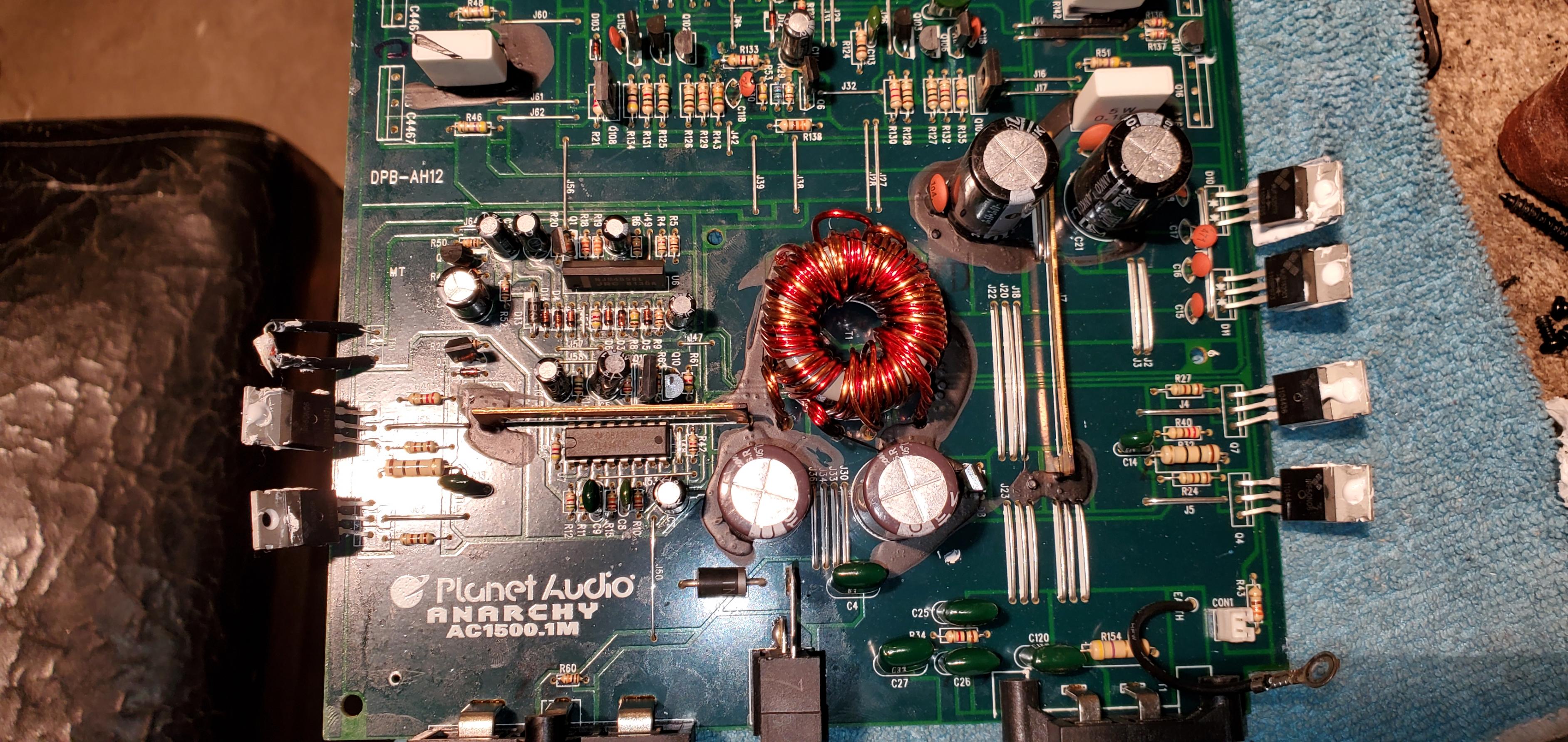

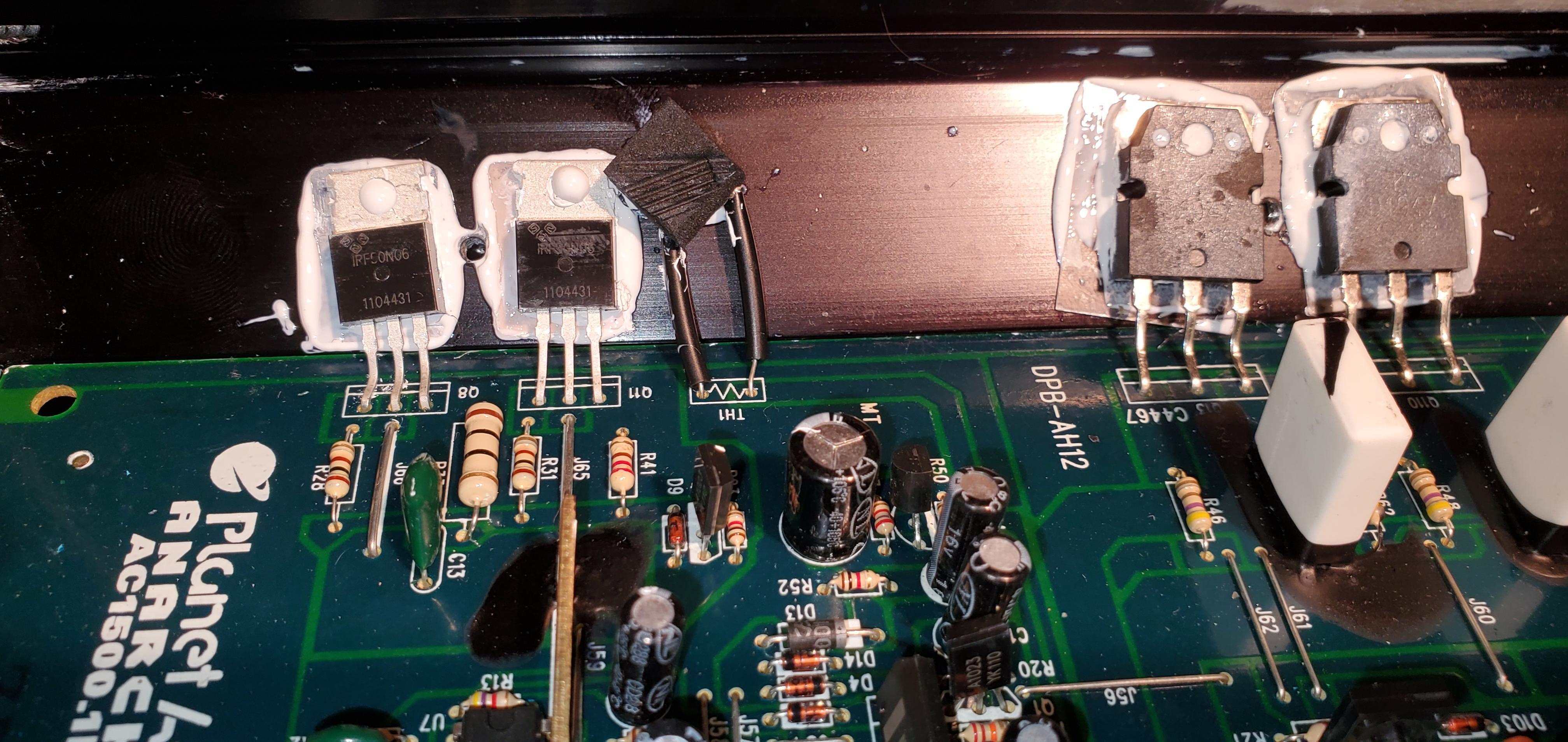

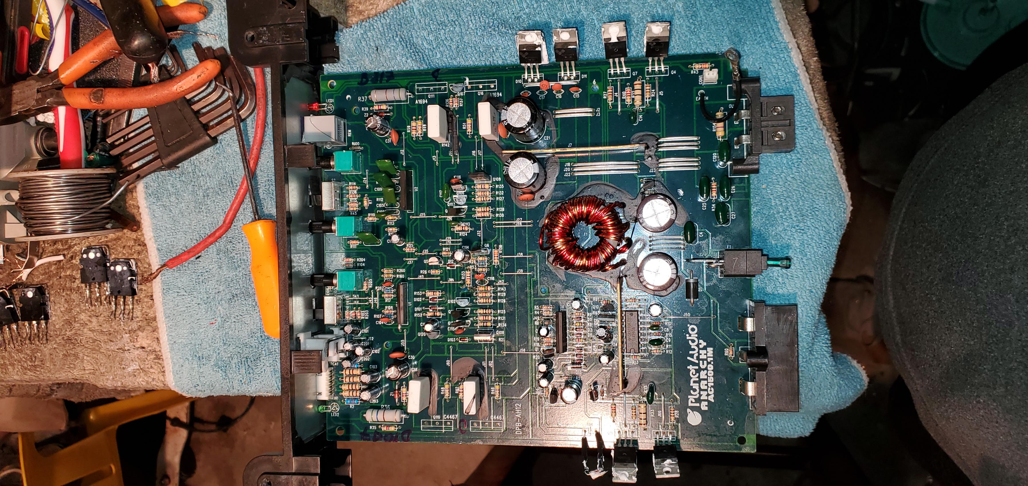

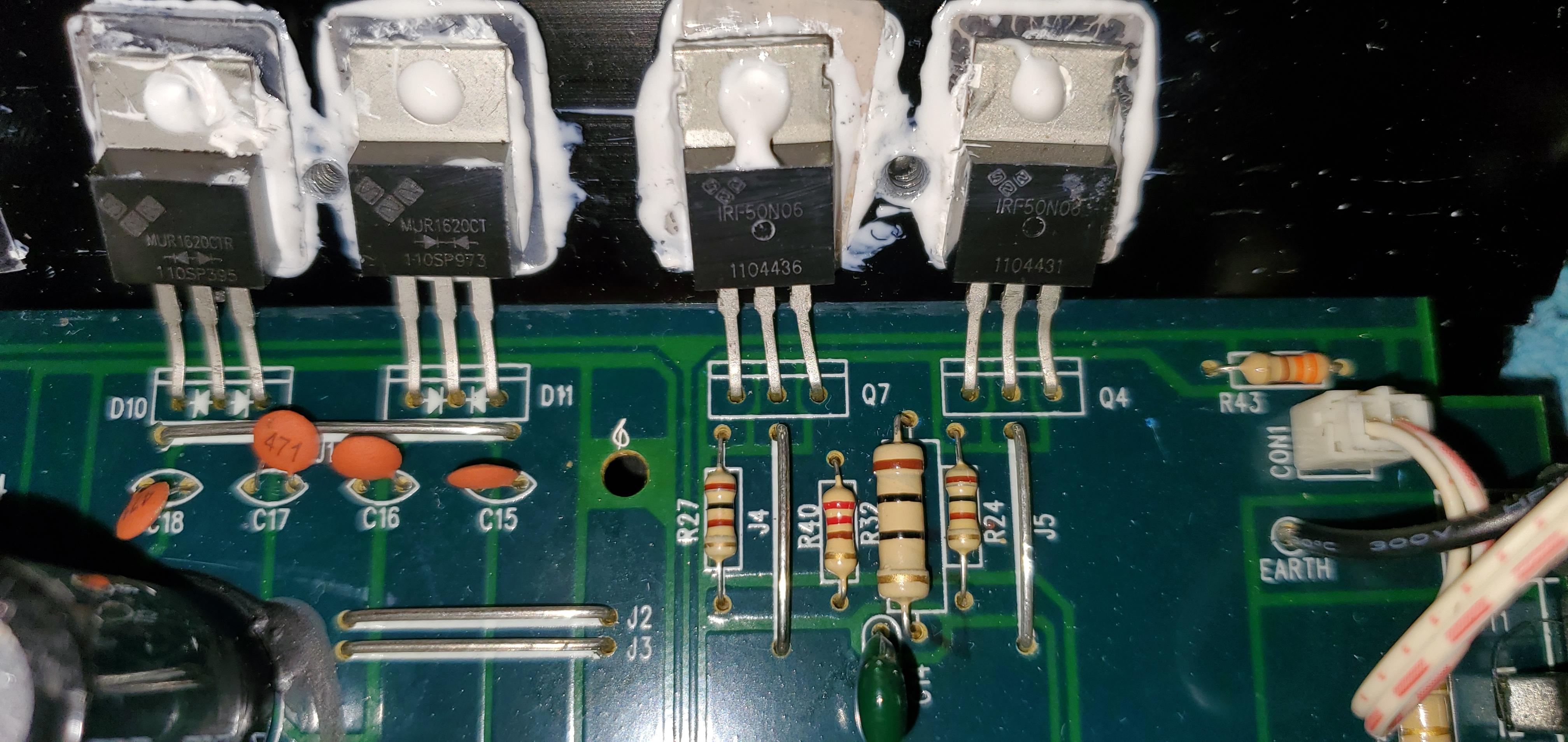

Hi guys someone that can help me with a Planet audio AC1500.1 amp turn on but no sound. the channel just pop out the subwoofer and give me +27vdc on the speaker channel. I already opened the amp looking for bad transistors but both mosfet and output transistors tested good not sure what is causing this problem any help is aprecciated.

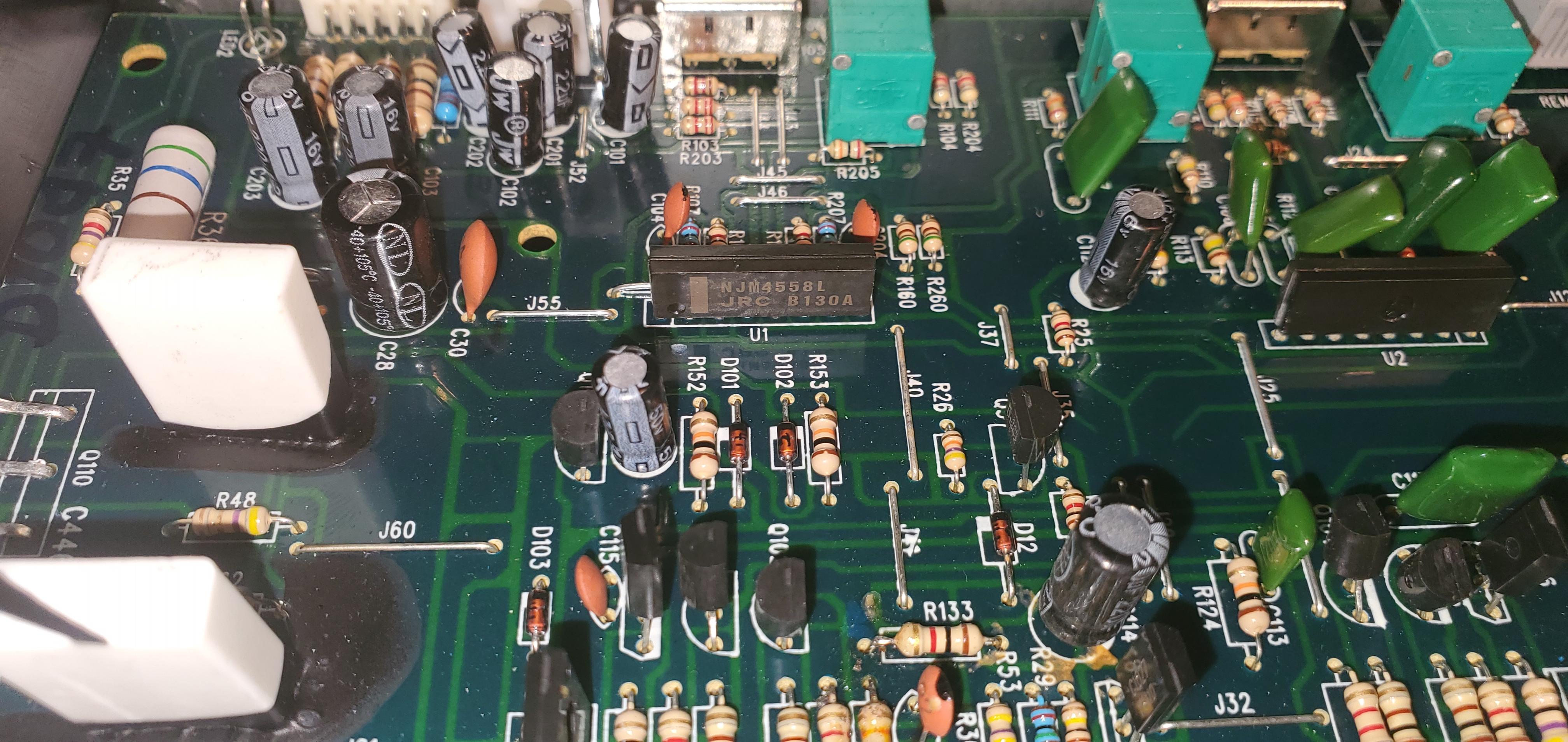

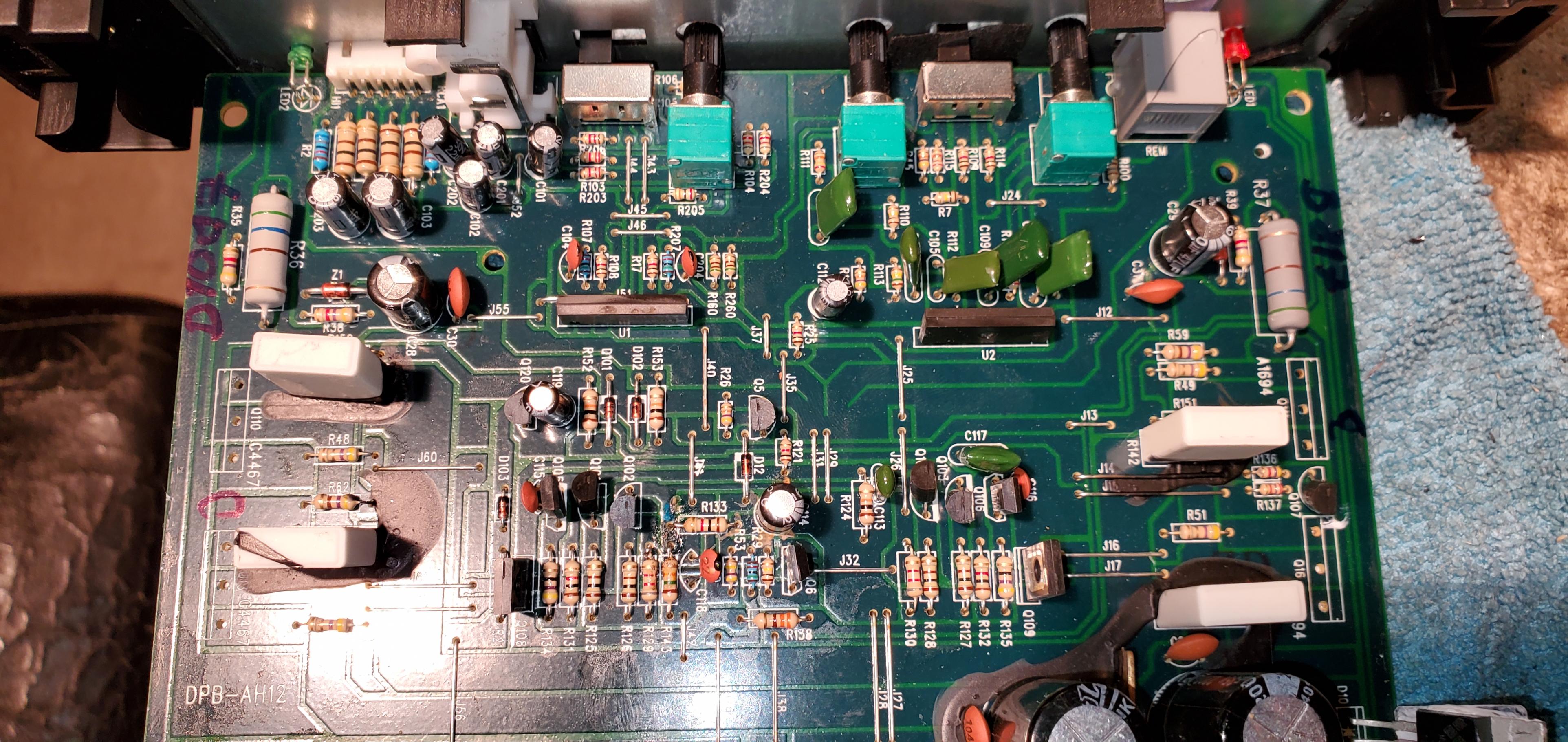

Hi perry yes it's -15.6 vcd I already reinstalled the outputs the voltages I give to you are with outputs in board. How ever I noticed that u2 was installated pointing to the up and the U1 down not sure if this is tje correct way they need to be! I mean with the serial number On u2 is inversed pointed up
Ok I cheched them again and this what I get Then I assume both drivers are working right if I'm not wrong. My bad here
