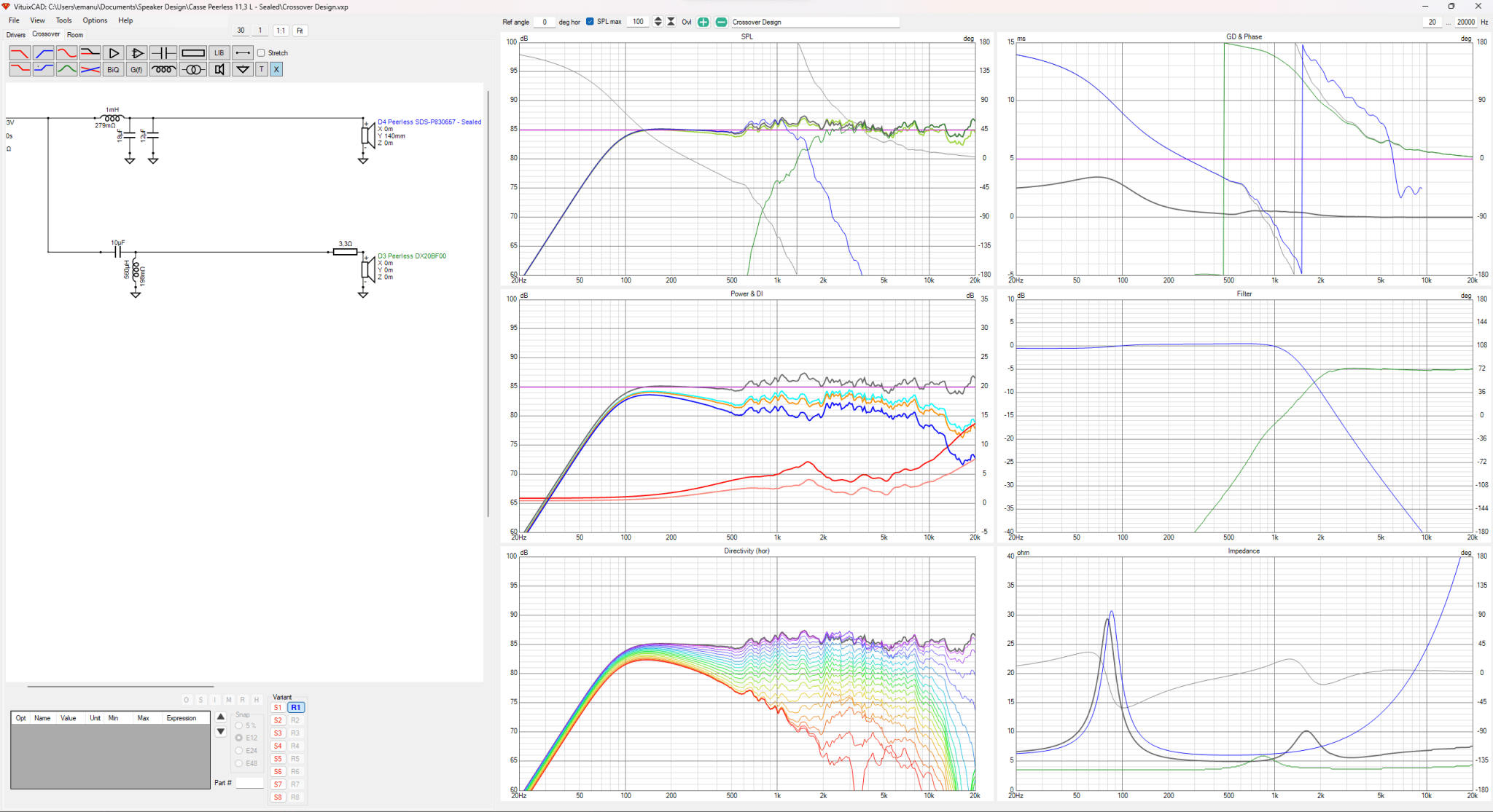

Hi everyone,
I've been learning how to design my first set of two ways speakers on vituixcad in the past few months. I made a concept with two peerless drivers, a Peerless SDS-P830657 woofer and a DX20BF00-04 tweeter. It's a sealed box, 11,3 L of internal volume and 330 mm height by 190 mm width front baffle. From the last posts on this forum I learnt how to take diffraction in consideration with the drivers response, I made this design and started to make a crossover for it. So far the response looks reasonably flat for my purpose, but I have issues in understanding phase alignment. More precisely I don't understand when the tweeter and woofer phase are aligned in the graph. What kind of phase graph am I looking at to have both the drivers work good together? Also the tweeter has a small waveguide, does calculating diffraction for it differ from a tweeter without waveguide? Anybody can help me through this?
Thanks in advance 😀
