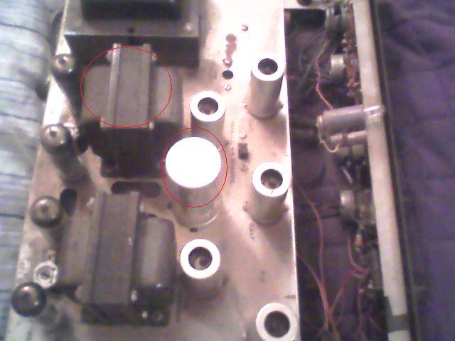

Hello i have aquired a PACO SA-40
its original origins are unknown but the guy i got it from said he thinks a hotal was using it for an intercom/PA system.
It powers on and all the tube elements glow but it starts smoking like its 1970 again. I've traced the smoke to be either an OPT or a capacitor.
I found a schematic here
But i cant quite identify the capacitor.
i circled the two problem children in the photo.

That's C3 on the schem. It's a multi-section electrolytic (A,B,C,D) that has seen better days. You'll need to replace it, either with the same values in one "can", or with separate capacitors.

ahah thanks man. Ill order some up. idk if i can find the can per say but i can probably gut that one. the shell of the can seems to be the common. four leads on the bottom and two bolts to the case. and theres a ground terminal on the case. hopefully these wont cost me an arm and leg but i was starting to freak when i thought it was the OPT
You may be forced to buy a 4 x 20uf "twist-lock" plus an 80uf axial. You could use three of the 20uf sections and mount the 80uf axial underneath. I'd also be tempted to replace all the other electrolytic caps in the PS, just to avoid more magic smoke from escaping.😉
Probably a good idea to check the OPT for shorts just in case.

hey you were on to something.
JJ makes a can cap thats 40uf x 20uf x 20uf x 20uf at 500 volts
and its only 15 dollars at tube depot.
JJ Can Capacitor 40µF x 20µF x 20µF x 20µF / 500V
and a 40uf sprague atom is only 9 dollars.
if i bought them individually it would have been almost 50 dollars after shipping.
