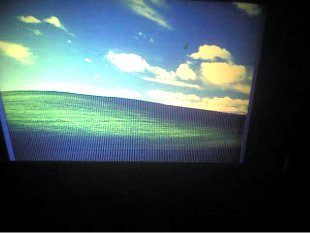

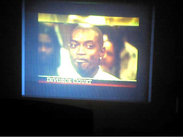

Hi, I took some pictures and I hope someone has an idea of what is wrong, if I can fix it or should just rob this ****** for parts.
The next few photos will hopefully help anyone to help me.
these are examples of the problem, verticle lines from the blue lcd panel.

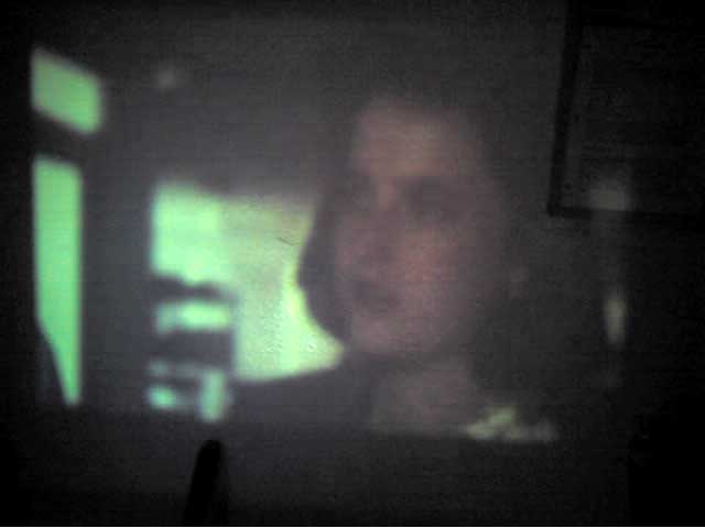

Blurry picture
In looking for any obvious problem I mis-aligned the prism/lcd block, just have to get in there and fix it I did it once already. With it like this it doesn't show the lines but what's the point in that? Contrary to my first post on this, the ribbon was just not connecting properly, once I got the connection correct all three panels were running.

Vertical lines
Hi thanks for looking.
The problem is that there are vertical lines when it is focused properly. Take a glance at the first 2 shots and you can see what I mean. I don't know enough to fix it without help from someone with more knowledge about electronics or lcds.

I've done some more testing swapped the connections around so the lcds were being run from different colors. It seems that there is either damage to the blue lcd or the part of the main board that controlls it. There's nothing I can do about these kinds of problems so I'm just going to set it aside untill I get the rest of the parts to build my own. I may put some of the parts up for sale after I'm sure of what I need.

Hi, the problem with my projector was that one of the LCDs was defective. I isolated all of them and moved them around to different control/video connections and found that the one that was being used for the blue was damaged. If it were larger I might have tried to find a fault but knew that it was beyond me.
There was nothing wrong with the prisms. The way the final one is fixed in place is flakey; it just uses some kind of soft glue (I think) and pressure from the housing around it so a sharp jar can misalign it from the objective lens making a blurred projection.
If you can run the pj with the case open try disconnecting 2 of the LCDs from any input and blocking the light that would pass through the path they use with a small piece of cardboard or something like that. I used business cards. By having only one LCD getting input and light you should be able to see if just one of them has the lines. If you can move them to other inputs you can then see if it's the LCD or the control/video going to it that is messed up. You will have to clean everything in the light path after doing this because of all the dust and such that will accumulate.
