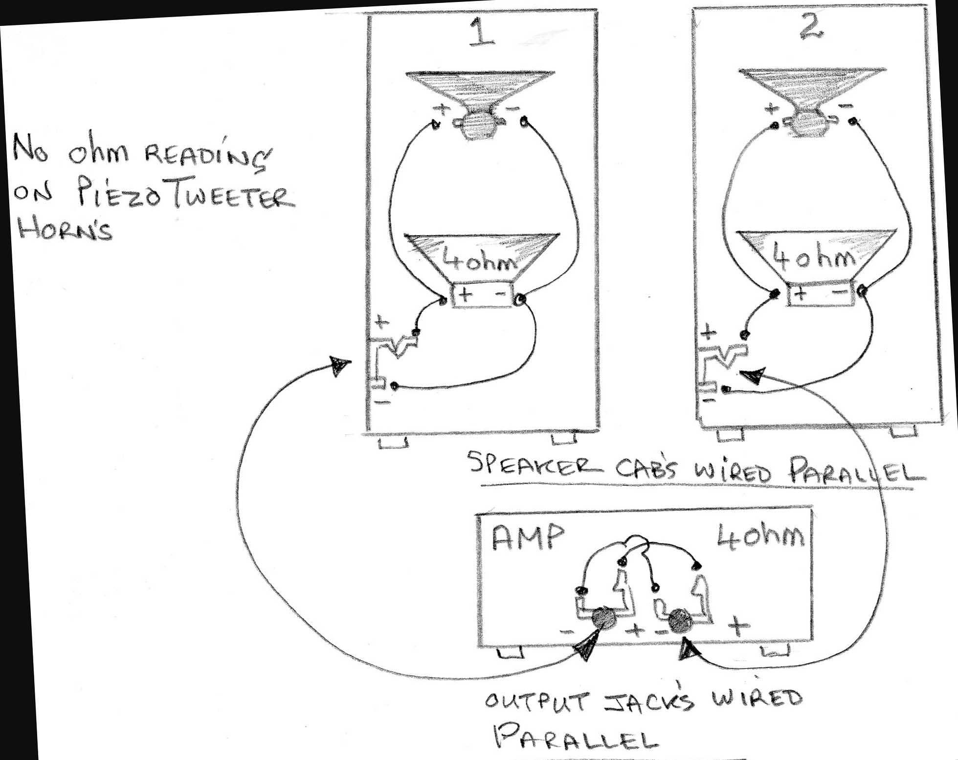

Amplifier is a solid state mixer pa amp, 4 ohms,150 watt.with 1/4 inch jack sockets,say.s on amp sockets wired parallel,
Speakers are no name one eight inch 4 ohm speaker and one piezo tweeter horn that i get no ohms reading from wired parallel.
I need to know if wired as drawing shows,would the overall ohms of speaker cabs be 4 ohms,or lower.?
If the amplifier sockets are wired in parallel internally (so its a mono amp with parallel speaker outlets) then your two 4 ohm speakers will appear as a 2 ohm load to the amplifier.
So you need to be sure the amplifier can handle that low impedance.

if the output 1/4's are parallel then connecting your speakers will result in a 2 ohm load (question is will the amp tolerate it!)

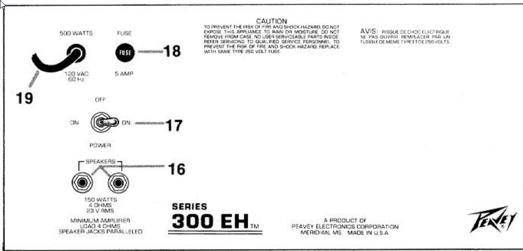

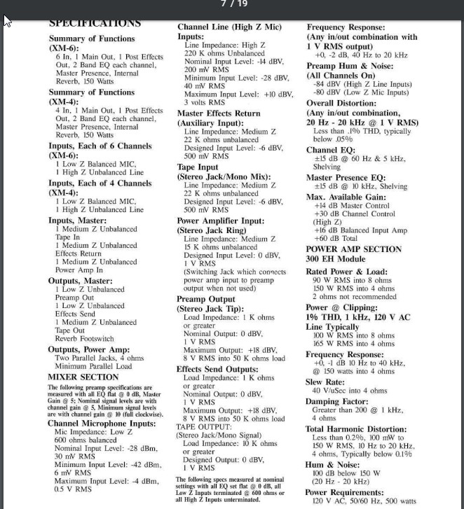

Back of amp clearly states that the minimum load is 4 ohms.
If using both output jacks, your speaker cabs must therefore each be 8 ohms.
If the speakers in your original pencil diagram were 8 ohm speakers, then plugging one cabinet into each amplifier output jack would give a safe load of 4 ohm.
If you mean wiring the two 4 ohm cabs in series, then the total load would be 8 ohm. This is possible, but requires non-standard wiring.

Let me ask this pertinent question - have you actually built two separate cabinets yet?
I ask this because it is easier to wire the two drivers together in series inside the ONE cabinet as shown in my diagram.
I have 2 ready made cabs with a driver and piezo horn in each,wired in parallel,these cabs have 40 watt 8 ohm drivers in them,I want to change these for 100 drivers 4 ohm.
well you have two 4 ohm speakers with some piezzos (and they don't count in terms of load because they're more like a capacitor)

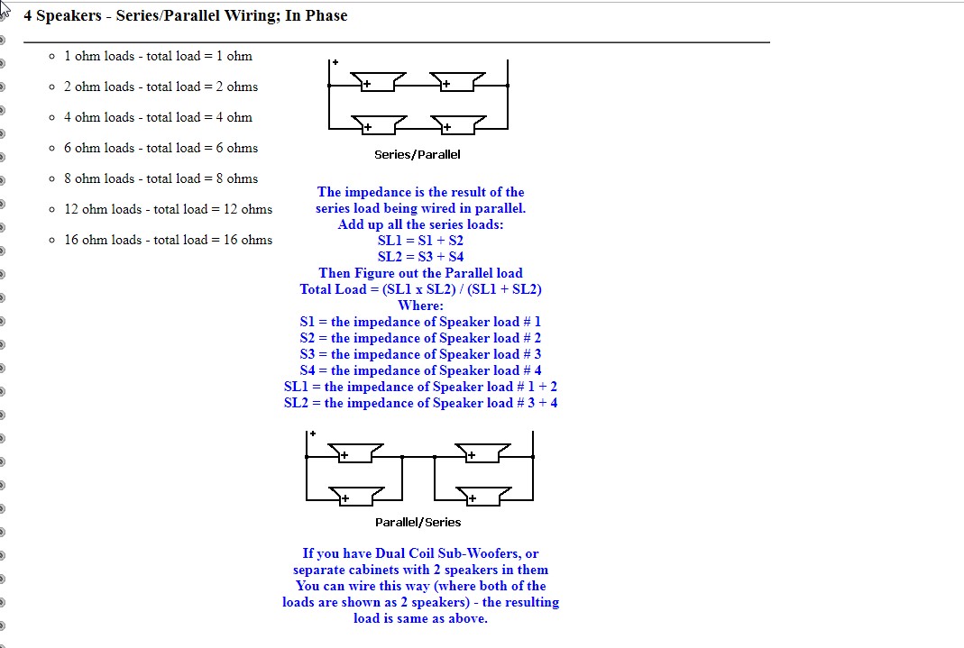

so your left with two choices 2 ohm(two 4 ohm speakers in parallel) or 8 ohm (two 4 ohm speakers in series) short of adding resistance (and resistors don't make sound they convert sound to heat) there's no easy work around...
