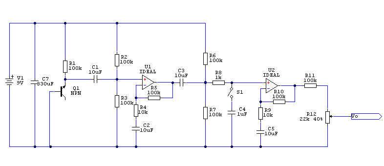

Hi, I have built the circuit shown below to help me test a peice of equipment, it is supposed to pruduce white noise when SW1 is open, and aproximate pink noise when SW1 is closed. It seems to run fine when I want it to produce white noise, giivng a good output level for me to use. However, when I close SW1 the output level drops off dramaticaly (by about 30dB), although, the noise spectrum is shaped in the way I want it.
So, can anyone point out why the signal is being so strongley attenuated when I switch in the capacitor, and give any possible solutions for me to try to solve this problem.

I think the drop is to be expected. The conversion of white to pink means that the power per bandwidth unit drops by 20dB/decade. I assume you measure the RMS power (but also when you listen to it) the level necessarily is much lower. Look at it this way, you put in an attenuator by loading the source with the cap.
One solution would be to gang S1 and switch the gain of the output amp. But be carefull, with higher gain in the white setting your LF level may overload whatever you are testing.
BTW, you can delete C3, R6, R7 without problems. Save a bit of power.

Hm, that is what I though I might end up doing, as the switch I am using has a spare pole, so I could wire in something to boost the gain of the second op am to cancel out the power loss from the filter. I was hoping to avoid this, but never mind.
That filter isn't close to being pink. 6dB/Oct above 143Hz.
It is pretty-pink from say 50 to 500, though the error isn't trivial.
Real pinkers have several caps:
If you like the shape, fine. I use an odd pinkish-noise with less power in the top octave so as not to burn tweeters.
Passive White-To-Pink filters always do that. Usually you stick a resistive network into the White signal path so the White mid-band level is similar to the Pink level. Switching C4 from a 1uFd cap to a 50 ohm resistor would be a quick fix.

i should have explained what I was using this for a little better I guess. This will be being used to simulate the noise from a burst water mains to try and demonstrate a product the company I'm working for this summer sell, which picks up sound in the range fo arround 100 - 5000 Hz. So, the fact that this only needs to work to 5000Hz somewhat justifies my poor choice of filter, but I should know by the end of the day if this thing works or not. If not, I might give the filters in that first link (thanks PRR) a go and see if that helps out at all.
bigparsnip said:Hm, that is what I though I might end up doing, as the switch I am using has a spare pole, so I could wire in something to boost the gain of the second op am to cancel out the power loss from the filter. I was hoping to avoid this, but never mind.
Shorting the 100k series R at the output in pink mode immediately gives you a 5x gain.
