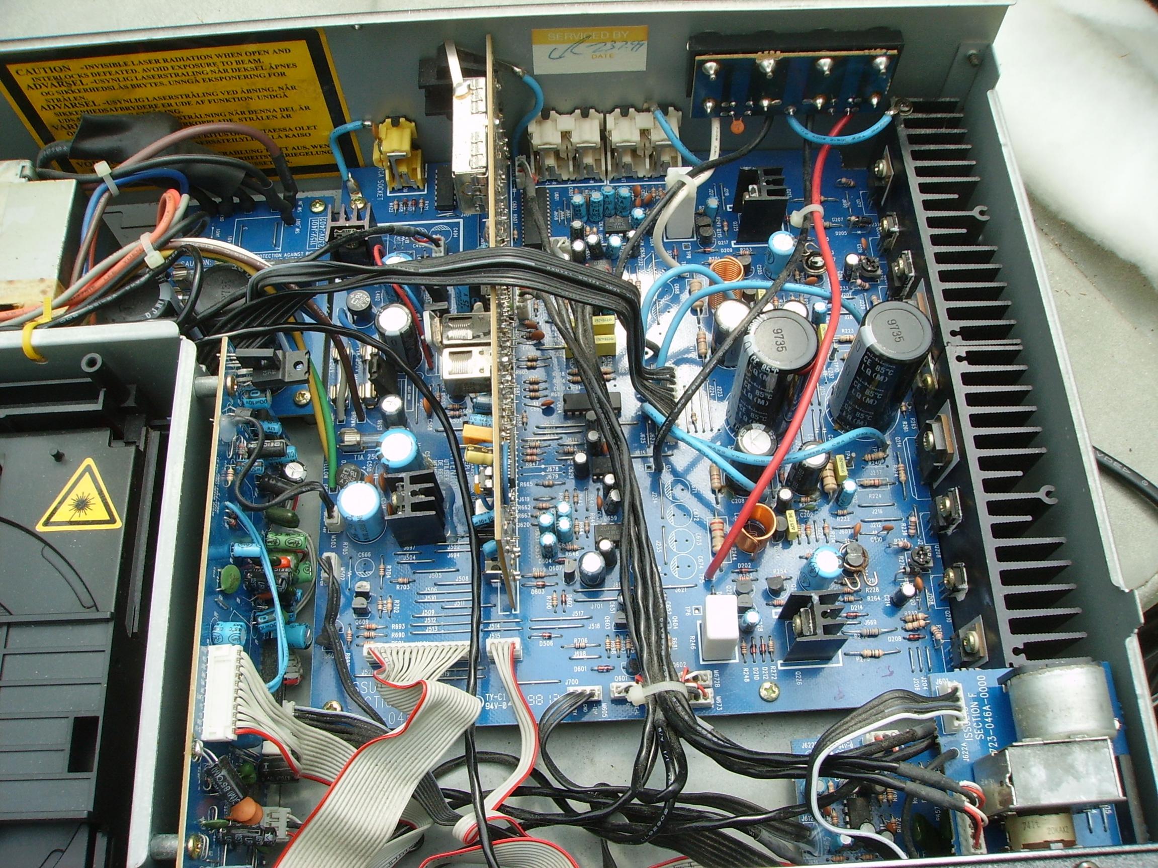

Hi, I have a NAD L40 CD receiver which has stopped working on the right channel regardless of the input (tuner, CD, etc)
So I swapped the speakers around but no change so it isn't the speakers.
I opened it up and swaped the fuses around, no change either & no blown fuses.
I can't see any obvious burn marks or bad capacitors etc and both channels work fine through my headphones.
The only thing I did notice was that a transistor for the working left channel on the main board ( Q225) got fairly hot to touch but the right ( non working) side remained cold (Q226) so I presume it is faulty or something feeding it is faulty. I have attached a picture of the main board, Q226 is in a black heatsink on the bottom right.
If anyone has had a similar problem or got any ideas what is wrong I'd be much obliged for your help.
This NAD has a dedicated pre-amp out rather than jumpers so would it be OK just to use it as a tuner / CD pre-amp connected to another power amp even though it is still wired to its own internal power amp? This might be the cheaper option for me rather than an expensive repair.
Thanks for your help

About 95% of amplifier problems are due to output stage failures, including the very circuits designed to protect them. With one channel cold, the first thing to check is fuses M204, 205 but if they are OK as you say, the power has to be traced right to the amplifier and the relevant points in it. Here's a link to the service manual. Searching and posting one is a good way to make it easier for others to look at your problem: NAD L40 Manual - Compact Disc Receiver - HiFi Engine
This is one of NAD's weird asymmetric design output stages with Mosfet + Transistor output devices. The amplifier is AC coupled (4,700uF capacitor) so the overload protection relay only cuts the power to both channels. What you need to do is check DC voltages in the circuit to find where it went wrong. Some key DC potentials are already marked on the schematic (main board L+R ) Others can be compared with the good channel, so there is no lack of information regarding what is likely OK and what's not.
The question is, do you have the basic tools for soldering electronic circuits, small hand tools like screwdrivers, pliers etc, a DMM for accurate measurements and some grasp on the fundamentals electronics? Obviously, if parts are needed to repair the amplifier then it will cost a little money, perhaps more if trying to source obsolete parts like that BUK55 Mosfet, should it have failed. Otherwise, components are not inherently expensive, depending on where you buy and whether you wind up with fake parts which is what happens when you buy too cheap from unauthorized suppliers.
If you aren't confident or don't want to repair it, it's certainly possible to run your amp. as a preamplifier without the power amplifiers. Just remove fuses M204, 205 which removes the single +55V rail voltage supplies to each power amplifier and you still have the pre-out, as you say.

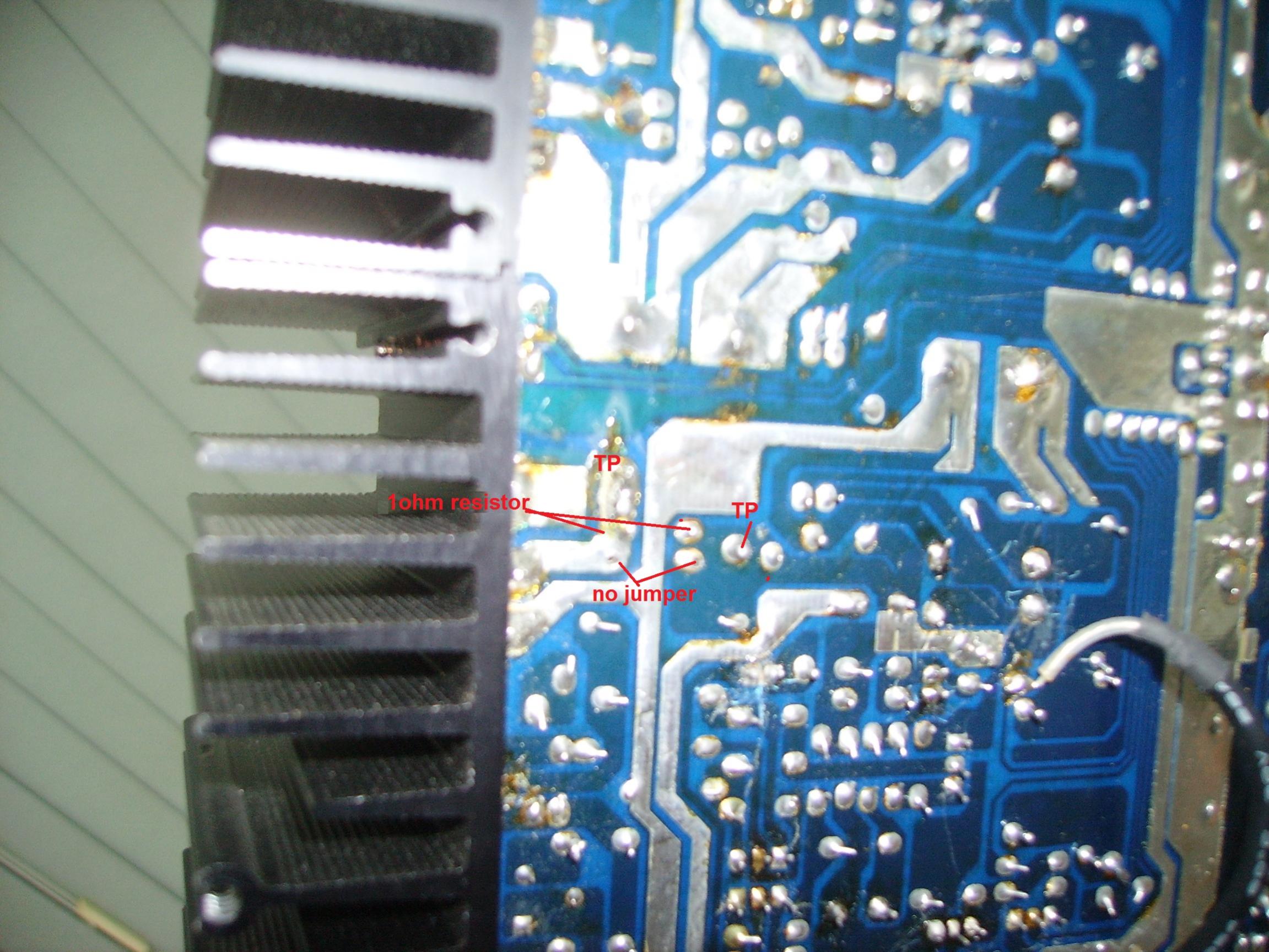

Hi Ian,
Attached are the transistor readings but disaster has struck.😡 On my very last reading I shorted out a pin on the right hand mosfet, bit of a spark & now the amp is is protect mode. I assume the mosfet is fried and needs a new one. I gather they aren't available so do you know an equivalent? ( I found IRLZ34 or IRLZ34N through Google) Should I change both channels?
I have taken out the fuses & the unit works through the pre amp & the headphones.
Anyway before my slip up I got three odd readings:-
Q203 (LH) and Q204 ( RH) voltages started at about 0.78v but rose slowly to well over 0.8v but never stabilizing at a steady figure As they are both doing the same this can I assume this is normal?
Q220 (RH) read either infinity or -0.43 when I swapped the probes around whereas Q219 (LH) read 0.86 This got my hopes up a bit thinking I had found the culprit, then the probe slipped on Q212.

Oh dear, and we were off to a good start there.
Search at the page header for BUK555 under 'view posts' and get a feel for what and why most "equivalents" are not. This transistor has an unusually low (logic level) threshold voltage and without that feature, wannabe equivalents just won't be. There is another feature with a high Rds(on) that is considered best for audio applications and again, this just doesn't match.
The direct part is available as BUK555 60B and I would normally advise not to buy from Ebay but this guy has bailed me out of very difficult situations a few times already. The risk of cash is not much but it is still yours if there are problems: 5pcs BUK555 60B Manu PHI Encapsulation TO 220 Powermos Transistor Logic Level | eBay
Alternatives (only a few) are posted in the thread search results.
Having given you the go-to guy, we don't actually know if you have toasted anything yet. With the bulb limiter in place, only milliamps can flow so a shorted or blown device is unlikely but I guess shorting the gate would cause other problems too. The diodes (measure the voltages across these) should also be checked because they are low current devices and blow easily.
The idea was also to compare voltages between channels so that you know what to look for but this is your only reference, don't slip, get some new probes or spin them against a fine grinding wheel to grind a nice, sharp point, around 60 degrees included angle on them! (I've been known to use the knife sharpener on an electric can opener for this!) Now you see the true DIY approach 😀
As a further precaution, heatshrink tubing on the probes with just the tips showing is good or just slip on some PVC sleeving from power flex or thin, craft plastic tubing if possible, maybe adhered with a smidgen of glue.
Let's compare voltages at the BUK555 pins and see what has happened, rechecking previous measurements at other transistors and compare the measurements with the other channel. I'm a bit concerned that you read different voltages with reversed probes though. Is the battery in your meter OK, resistance reading near zero? (about 0.3 ohms usually due to lead resistance). Grab a small battery and give that a voltage test both ways, to be certain. 😉

Hi Ian,
I took your advice & changed the battery in my meter & also opened up the L40 case a bit more to provide better access because those mosfets are really awkward to get at. I then took the readings again (and again!) and attach them to this post. Probably best to ignore the first lot. Now they are all pretty close to each other and near your original estimate. The Mosfet I sparked is still reading too and virtually the same as the working left channel.
The only anomaly is Q220 which now reads 16.5v. I checked & rechecked this so I am confident of the reading. If Q220 is part of the protection circuit & is bad maybe changing it will sort things out?
I had a look on Ebay and took a punt on two 2SC2240 for £1.68 ( 3 dollars?)
So they should be here Monday/Tuesday I hope. I know there are counterfeit components out there ( I cant get my head around that, is there a big market for obsolete semi-conductors?) but it is cheap enough for me to take a chance.
Turning it off/on with/without the bulb limiter makes no difference, the front display says 'Protect' either way. I can hear the relay click though.
If I pull both fuses it comes out of protection & works as a cd/tuner pre-amp so I am no worse off.
Thanks for your help thus far

Hi Ian,
I have changed all the electrolytics on the right channel except the big one C224 and it has made no difference.
All the resisitors R248 250 252 & 254 are OK.
I dont know if this is significant but there were no jumpers J236 or J237 on either channel. I measured the test points anyway. The working left channel showed 3mv on my meter the non working right channel showed 5mv. I adjusted the small variable resistor until it read 3mv. ( My meter only reads down to 20 ohm on its lowest settings, perhaps I should invest in a more accurate one).
I take it the thick blue flying leads that go to pads A B D E are the ones marked on the diagram for the protection circuit? I have left them alone.
I switched everything off but on switch on the situation remains the same. The unit works without the fuses in for the power amp or with just one fuse in for the left channel. As soon as both fuses are in it goes into protection.
Should I reinstate the missing jumpers? It doesn't look like there were ever any there in the first place and the amp originally did work with out them.
I bought this unit second hand a couple of years ago as far as I know it hasn't had any work done to it.
Be careful adjusting bias. First read the power amplifier adjustment procedure carefully in the service manual - page 14. The jumpers are across TP11-TP4 in the right channel, as is the 1R R240. However, if you measure between the test points, it should read as a short due to the jumper. Note that the jumpers could also be solder links beneath the board, otherwise R240 would burn very quickly in use with even a few watts steady output as it's only a 0.25W resistor in series with the output stage current. I've no idea why both options were necessary.
As you measure a few mV across the resistors (i.e. the TPs) it tells me something is wrong and the resistors are either a lot larger than 0.25W or the solder links were not replaced. On the other hand, the meter could be in error but simply shorting the leads should amount to the same reading if the jumpers are in place as they should be.
Most meters can't even read voltages in the region of 1mV let alone with accuracy, even brand new. Specifications read like: O.1%+2 digits - which means that the error for say, 5 mV reading on a 200mV scale could be effectively +/-40%. Not good, but it's the user who has the wrong grade of instrument that is the problem. At least a 4.5 digit resolution with high accuracy is needed below 10 mV measurements and who can afford such an instrument unless it's your profession?
Let's see what's not to plan there. Check the meter by shorting its probes for a zero reading on the lowest DCV scale, what R239, 240 values are if possible and if they are just the usual tiny resistors, the status of the solder links and resolder as necessary according to the manual. Somehow though, I think this isn't the only problem
Hi Ian,
In my previous post I said my meter only read down to 20 ohms range, it does but I should have said 200mv range (which I am sure you guessed is what I meant) & you are right all the ones in my price range are the same. It seems to be working OK.
I was working to page 12 & 14 of the manual but like I said there were no jumpers in place when I opened the set up. You can see they are missing in the photo in my first post. There were no solder links either. Photo of the back of the board attached. However the set did work on both channels, I used it sparingly as a bedroom system so it was never turned up very loud.
I took out the 1 ohm resistor & measured it out of circuit at 1.5 ohm. Physically it is the same size and appearance as the majority of the others on the board, I had some new ones and they measured the same. I put a new one in and it made no difference. I have made up new jumpers & installed them again it has made no difference. The same thing happens, works as a pre-amp without the fuses, doesn't go into protection when I put in the left channel fuse but does when I then put int he right channel fuse. I have to turn it off & remove both fuses to get it out of protection.
As you probably know the 4 blue flying leads go to an earth track which runs across the main board front to back. The speaker -ives are soldered to this track too.
Idle on both channels is still 3mv on my meter.
