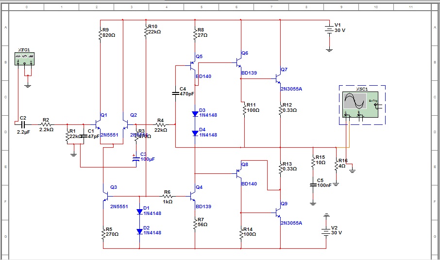

To me it doesn't look like you have any drive from the input stage to the Vas.
I think you want to connect the collector of Q1 to the base of Q5
That's the first thing I've noticed anyway.
All the best,
Joe

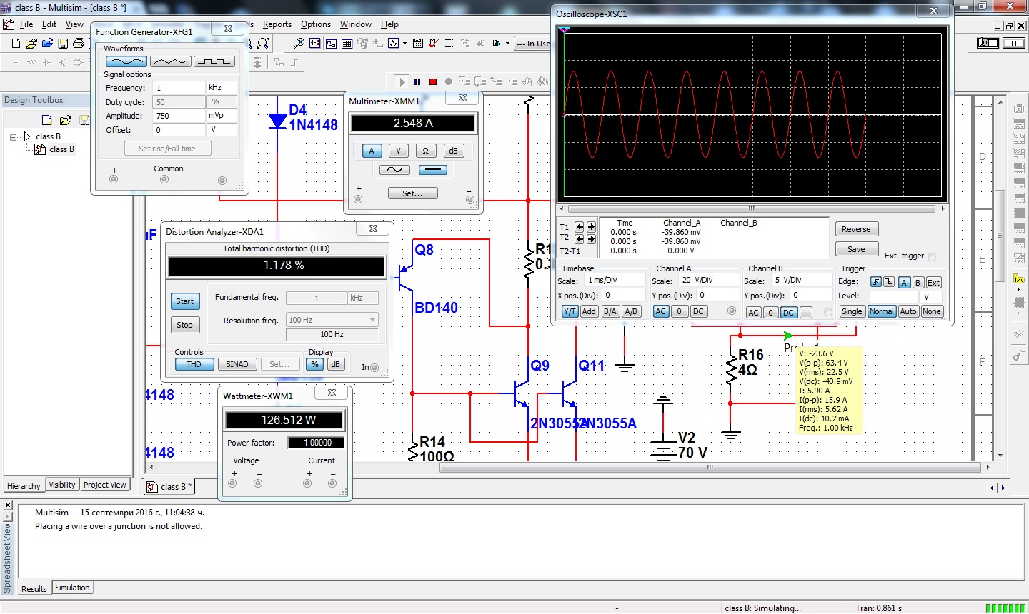

now i set supply current to +- 80V and 4 ohm speaker .
Scope in output say that the voltage is under 40V , why ?
