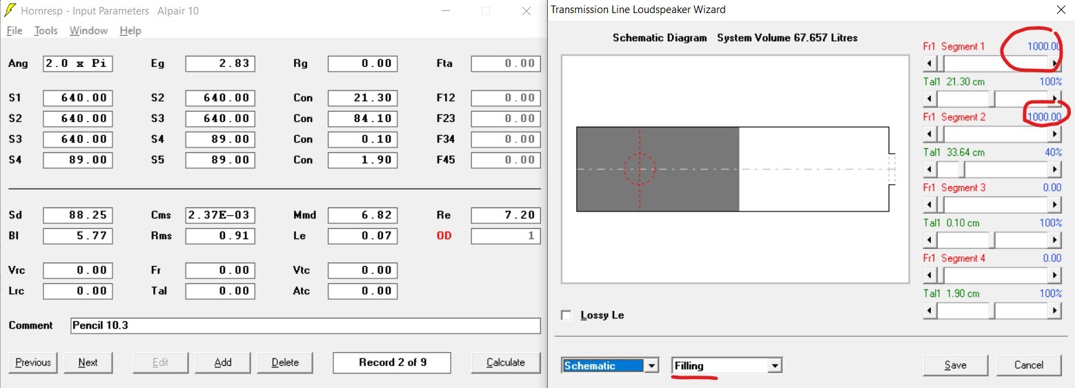

Now, I'm inspired by the Pensils and Sebelius to design and build an MLTL tower using Alpair 10.2's. To fit in my space, I'd like the cabinets to be a bit smaller than the Pensil. The first diagram gives the general dimensions. I did a bunch of modeling using Hornresp. The pictures show the model parameters I came up with. The modeled response looks pretty good to me, with a bump ~42hz. Mouth velocity is a little high near the driver x-max. Otherwise, I would have make a narrower shallower port. Did I model this correctly?

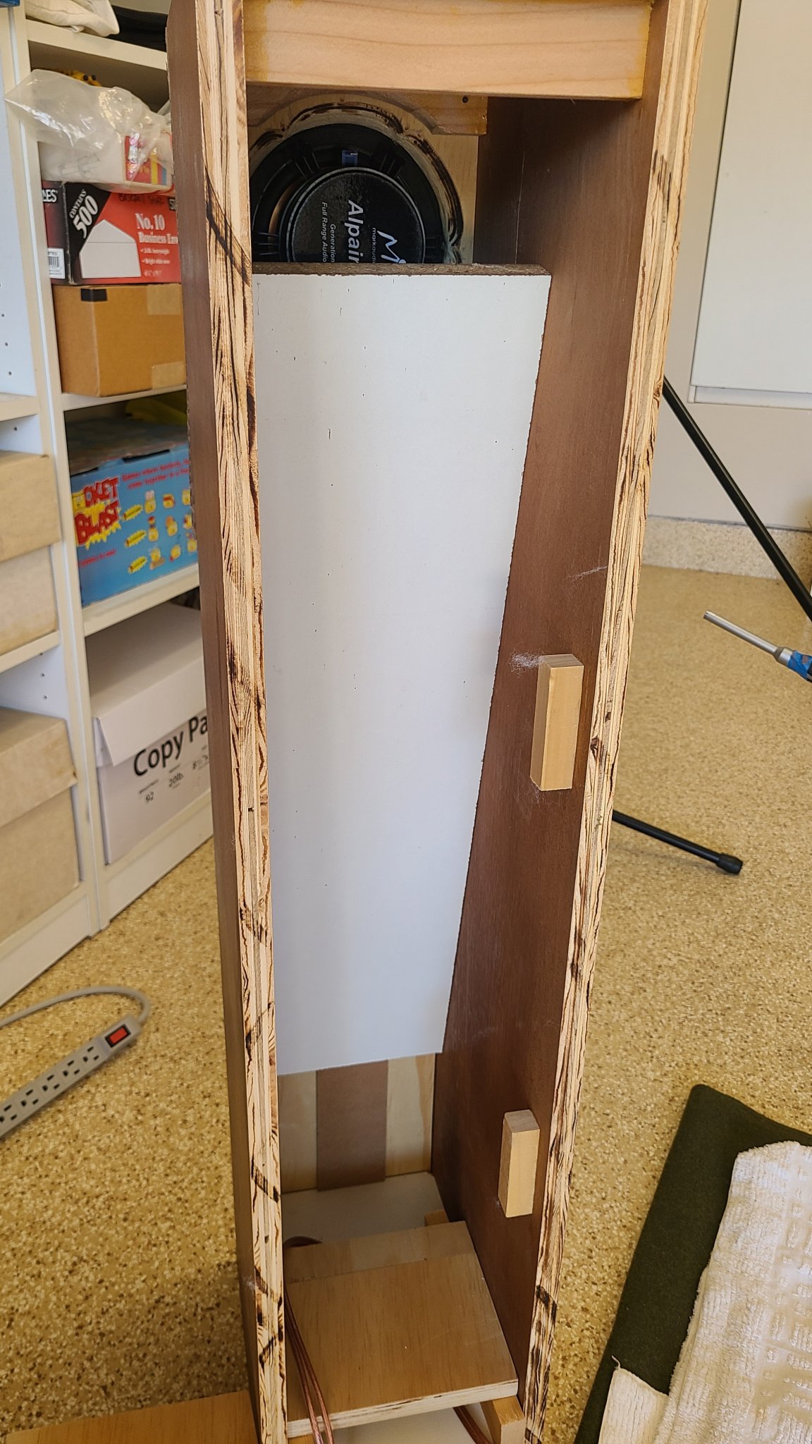

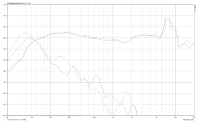

I built a test box and measured it. The test box is slightly larger than the model to allow for some adjustments. But, it's pretty close. The driver has ~150 hours of break-in time. The near field measurement look pretty good. And it sounds pretty good! The bass is extraordinary for such a small driver.

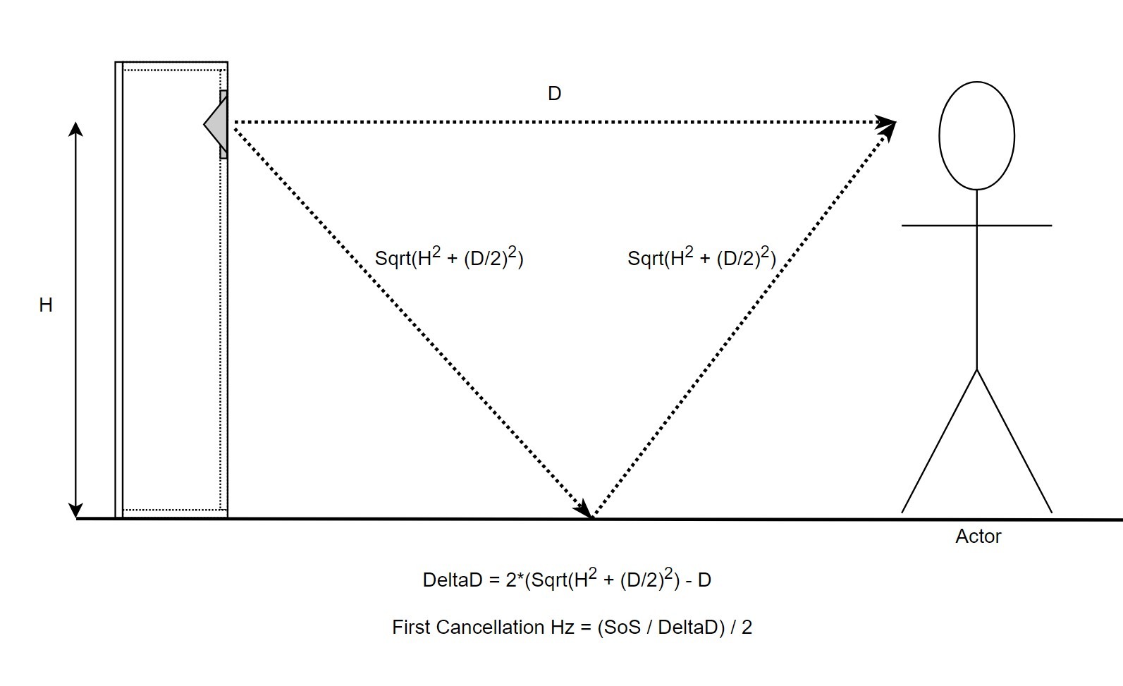

My first question is about the FR chart dips in the 100hz-200hz range. Some were measured at 3', others were measured at the listening position of 10'. Is this floor bounce (carpeted room)? Rear wall bounce? A gated measurement problem? Poor cab construction? Interference due to distance between the driver and port? Should I do anything about this?
My second question is about baffle step compensation. I find that the speaker sounds more natural with a ~2db baffle step shelf starting at ~1khz. Have any of you found the same? Do you think building a full-size Pensil would increase the low end and midrange enought to avoid the need for baffle step compensation?

Here's the Hornresp .dat file. I contains a few records that attempt to model similar designs. The "Test Build" records are the ones I'm working on:
  • Test Build #1 - 42" tall
  • Test Build #2 - 39" tall
  • Test Build #3 - 38" tall, 0.5" narrower - same as the 1st diagram above
The dimension above are exterior. The Hornresp dat file assumes 3/4" material.
So which design are you trying to copy, because they are different?
I had both in mind designs at the start and modeled them both in Hornresp. Those in the .dat file I posted. I'm fairly new to Hornresp, so I may not have done it right. I modeled Sebelius as an expanding TL with moderately deep port. I modelled the Pensil 10.3 as an MLTL with a 1.5cm deep port. With the same exterior dimensions, I didn't see the advantge of the expanding TL, so I went with a constant area (no divider). I also threw a diagonal divider in my test box and measured it. I didn't seem to help. See the red line on the FR chart.

Also in pic #8 you've got a lot of tightly wadded stuffing. What's the deal with that?
That's me now knowing how tight or loose to pack it. I'm trying follow the guideline of stuffing in the top half. Way too tight?

Thank you Dave! I've updated my Hornresp model to have a 19mm terminus depth. BTW, does anyone know what kind of value should I use for the filling density and what that equates to in oz/cuft? I put 1000 - 1500 in the modelbecuase it seemed to damp out the most of the harmonics without killing the low end. But I'm really just guessing.

Re floor bounce, you tell us. 😉
Reflections (eigenmodes) are 1/2 WL, so you'll have to measure any other reflections, then Hz = (SoS/distance)/2.

you tell us.
Using the sketch below with 37" driver height of the current box, I get:
  • 146hz if measured at 36"
  • 216hz if measured at 72"
  • 321hz if measured at 120" (aprox listening distance
This is close to what I'm seeing. And there is also ceiling bounce in some of the measurements.
