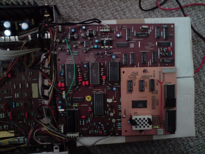

Hi everybody
Felling better now ( thanks to my immunosuppressive medication this is the 3rd time since Christmas that flu it me ).

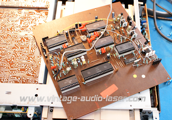

Question about the CD73: How many versions of it do exist ?
I know of 2 different decoder boards one with the SAA7000/10/20/30 and the one I have with only the SAA7030 a piggy board with Sony chips and loads of 74 series TTL chips.
Witch one is the early version ?
Does someone has the service manual for the one with the Sony chips that can send it to me ?
Ric

PS: here are pictures of the 2 different versions of the decoder board
