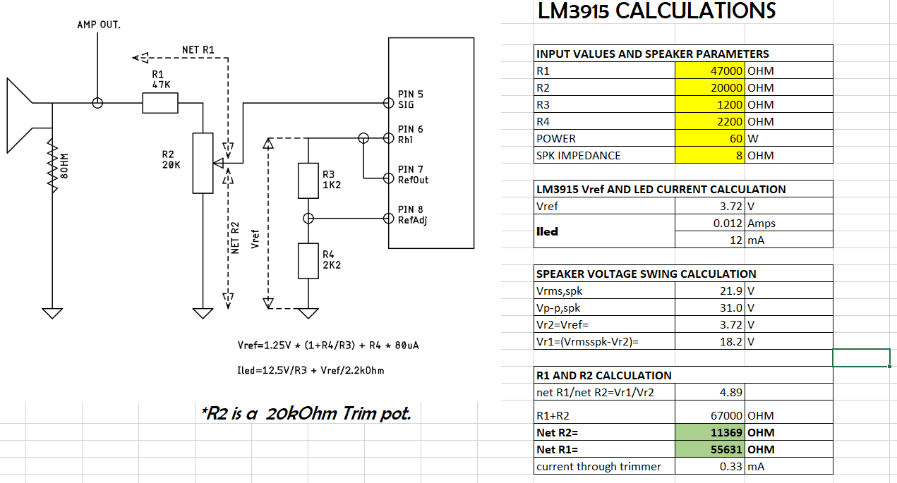

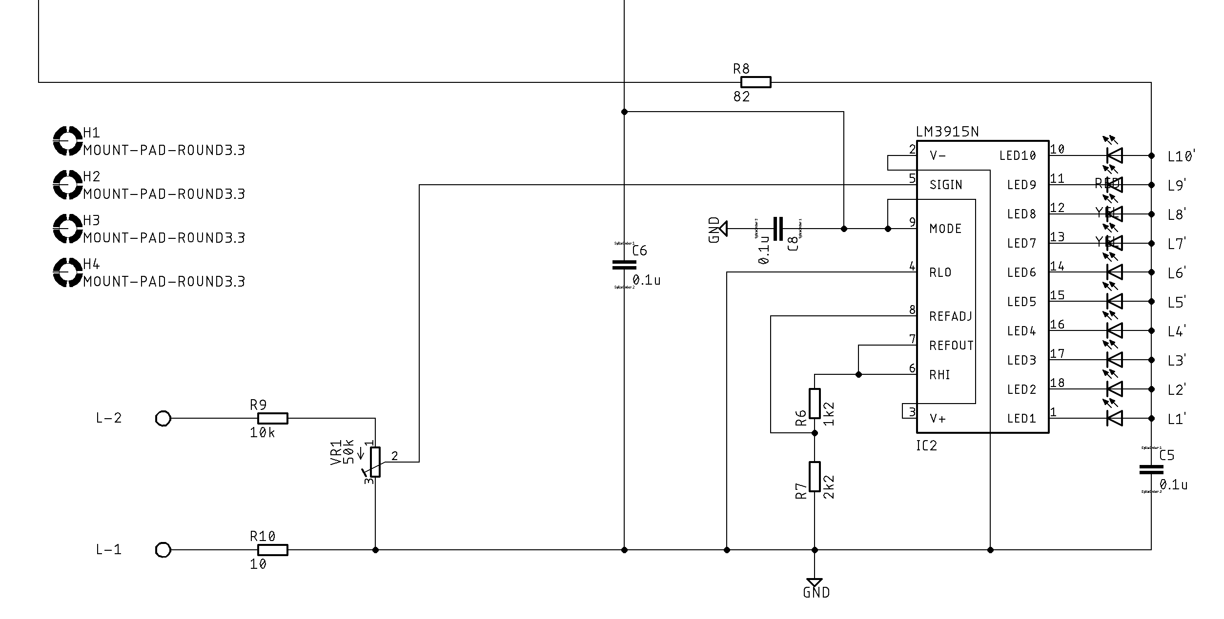

I am trying to set up the esp lm3915 as a power indicator for my amp. amp is about 60W 8ohm.
I am trying to understand the calculation for input dropping resistor to be used (R9 and VR1 setting in attached schematic).
The R6 /R7 as per the sch give a full scale sensitivity of ~ 4V for the LM3915 .
I would like to find out what values of R9 and VR1 to be used so that pin 5 sees 4V.
can someone help?

If Your trimmer is at max position and You can't adjust input, lower R9, but be careful since pin 5 is current limited to 3mA. For 25V (78W@8) this would be 8.3K. I think the pot value is too high also. Use say 10K. This way you will have more precision adjusting and 10K also doesn't load the amp.
Or... apply an AC signal similar to Your amp's max output and then adjust values until You get 5V on pin 5.
