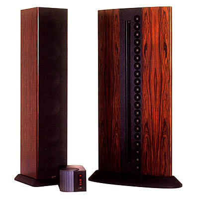

Genesis Technology make/make a speaker system with seperate bass enclosures and mid/high panels.
The system comprises a dedicated amplifier box with inbuilt <120 Hz filter and 12 channels each about 350w rms - ie 4000W total from 16 Hz through 120 Hz, and two enclosures 7+ feet high each fitted with 6 x 12" carbon fibre cone woofers.
There are 12 x 4 wire speakon cables connecting to the amplifier.
You supply your own mid/high amplifiers.
These 12 woofers are servo driven (4 wire connection) and together provide the biggest strongest cleanest bass that you have ever imagined, let alone heard.
This is an extreme example of course (USD$135,000 !!!), but illistrates that there is very much to be gained by running 6 bass drivers per bass cabinet.
12 x 10" or 8" drivers in tall narrow/deep cabinets tuned correctly ought to provide all the Doof you, your DJ friends or your neighbours could ever want.
You will need more drivers and amplifier channels than you have budgeted for, but the costs are not too extreme.

Yes, I knew Genisis did it along with a few others like Infinity. I have not found any smaller drivers that can get down very low for a small cost and still produce high SPL. I want to keep total cost of the drivers and amps at about what I could sell my old sub for, $500-$600. Thats my way of justifying such a monster sub setup,😉 .I have modeled quit a few over the past few days and so but the 295-490 12" dayton DVC sub seen to look the best. Modeling four per tower the responce is quit flat with an F3 of about 32Hz. Only bad thing is the enclosures would have to be quit large. I want to know what you think this will sound like in a room. Again I have been out of the home side of DIY audio so I am not quit sure if this will go low enough.
