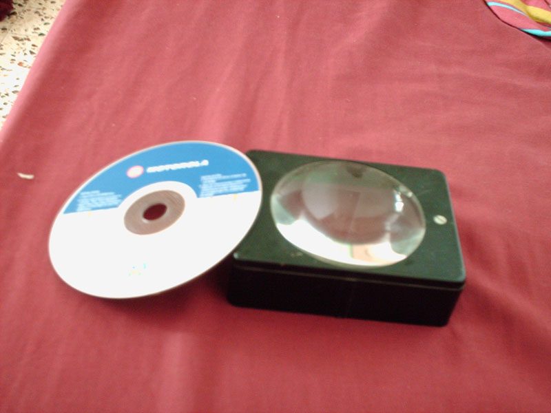

As far as fresnels go, see if you can find a "page magnifier" from an office supply store or something similar closer to where you live. It may be cheaper than ordering one from 3dlens after shipping. The 3dlens one is only 0.4mm thick and might be difficult to keep upright and flat in your projector.
A fresnel between the LCD and the projection lens may not be absolutely necessary, but it sure can help the brightness of the image. It is used to direct the light from the LCD into the projection lens. I recommend using one.

tgreenwood,
im not going to use the light assembly from the durst PJ.
Iv'e been searching around for a frensal and i can find in israel, i also found out that office depot here stoped importing them a year ago, so im going to have to order the fresnal from 3dlens.com i will fine a way to keep it upright..
now for the lcd part, is the vga hack diffrent on the pal lcd?
and is there s video input on it besides the composite and vga?
as for a light im going to use a 250-450 watt halogen light bulb, and i have enough fans to keep the temp's down on the light and lcd.
