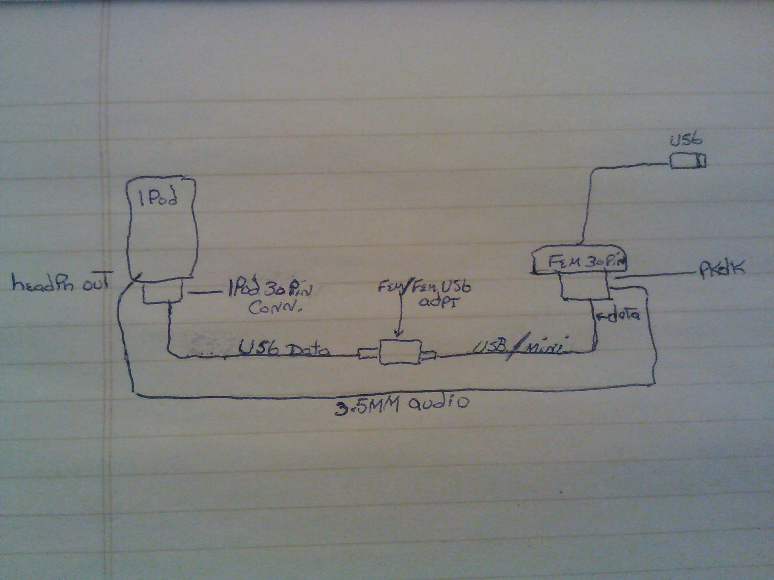

Hi sofa'
Here's a basic diagram that I drew using only one "PocketDock", but should work none the less. Hope you can make out the labeled items in the circuit. I realized that it could be done with just 1 PD but with adapters in it's place. These are the parts on order. If I still need a line level boost, then I'll get a pre-amp. Here's a link to that:

And here, once again, is what a "PocketDock" looks like; may help with understanding/visualizing the schematic diagram.

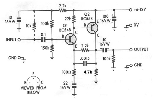

I've found this circuit on the web that may suit for the duty
And also looking for 'preamplifier schematic fet' I found this page (that circuit needs higher Vs , which isn't a bad thing as it allows to be battery operated...like three little 12 V batteries in series) Cascode amplifier. Theory and working. Cascode amplifier using FET, BJT, Miller effect
Note that each schematic is mono 😛
Once done and tested, it needs to be wired between the ipod and the HU input (aux). AFAIK the ipod makes line out L&R available only on that pin strip, being the HP output amplified. So you need to find the wires carrying the signals and put the preamp in there...just some surgical operation 😱

IMO
You have to find the colors inside the multi-stranded wire that correspond to those pins.
If noone finds any faults in that circuit, you may give it a try.
A printed circuit board is more practical...
A 9 V battery housed inside the box with a switch and a led, so you won't need extra cables. Preamplifiers absorb pretty little current so it can last long.
I don't think that it easy to find PCBs or kits for something like that - it's another era !
A little perforated board for experimenting and also for the final arrangement would work too.
