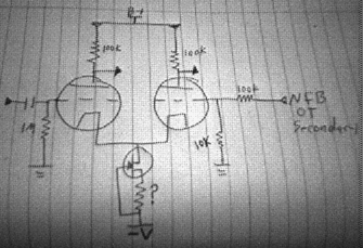

I am working on a P-P 7189 amp, class A (probably around 275v/10k load... haven't decided yet) and I want to rig up a simple-as-possible CCS phase inverter. Since the drive requirements for the 7189's are so low, a 12ax7 LTP should be fine to drive them from a line level input, so I don't have a driver stage to return feedback to. I drew up this inverter and wanted someone to check it out. I returned the feedback to the non-inverting grid. Simulations looked OK, but I want some opinions/ other options options before I breadboard.

Yes, apart from one thing - the CCS needs a bit of headroom. You need either to povide a negative rail (say -35v) for the CCS or to bias the LTP above ground.
The second method can be achieved by connecting the grounded grid to a potential divider from B+ to ground, with a cap of ~0.33uF from that grid to ground, in series with your feedback resistor (which can be smaller than you have shown here - say 1k). You need a 1Meg resistor between the grids, instead of from grid of the left half of the LTP to ground.
It can also be achieved by dierect coupling from the previous stage (if there is one). You will still need the bypass cap and feedback resistor on the grounded grid and the 1Meg resistor between the grids.

So the -12v that I have it referenced it to is low? I can up that to -30v or more if I have to. The fet I had is only rated at 25v, but that's no biggie. How do I calculate for that required headroom there?
I have used that method too... I am just trying to keep this PI as simple as possible, going for a minimalistic thing.
No previous stage, so that doesn't work out.

That looks pretty simple. What is the theory behind biasing the transistor to the junction of the 1M resistors? Do I need to generate a negative rail there as well?

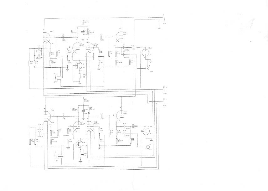

Nafty said:See if that one is usefull to you:
simple.
This diff pair can work with only one input.
The 1M resistors are error detector and at same time they pull the transistor on wich provide current to the diff pair. See that if any ac in the midle of the two resistors, is considered error and compensated on the cathode current.
You may use NFb or just ground the second grid.
NO -V requiered.

OBS: 3.6, are Kilos.

Thank you. I'll give it a try. Any suggestions on transistors?

I think that you should try it.
Transistor....any BC639 or so.
It works just fine on mine.

Cool. I don't have any BC639 on hand, so I'll give it a try with a MPSA06 or maybe even a MPS3904 just to see if I like the circuit.
tried out the FET circuit that I posted at the top, using a -25v negative rail on the source and it worked pretty well, so I am interested to try it against this circuit.

It works and it is very taff and very stable. However, I've done lots of variations out of it. With time I'll draw it for you.

Well, with this one you dont need to use the long loop NFb at all.
You may go only with local all along.
I'll tell you how. Mine, goes perfectly whith no 2cnd harmonic cancelation.

I tried out the circuit with an MPSA06, and it worked very well. I imagine that I could improve it a bit more with a better BJT. I also tried a similar circuit but with a cascoded CCS, and that worked well too... a little bit more in the highs it seemed, but maybe I was imagining it.
I readjusted for a 12ax7, and a 12AT7 and tried it again... YUCK! There was a staggering loss of high end. A little NFB improved it, but the 12au7 had the best extension of any of them in this context, and just enough gain to drive the output tubes.

If we combine both schematics, we may achive one great phase inverter. How about If we replace the Jfet by the error compensation type of circuit......???
Aletheian, have you any report for the audience?

Yes, I liked it. Thanx. It did the job, was simple to build, was sonically transparent and It worked well wth a 12au7. With a 12ax7... less so, but I didn't expect the 'ax7 version to sound all that good. I couldn't get enough drive to get the EL84's up to full blast if I applied NFB, but it was fine with no feedback.
I also tried a few more CCS topologies just for comparison, and I am heating up the iron right now to try another... actually, it is a hybrid of your scheme in cascode with a PNP transistor. After that, I'll try LED's in place of resistors ans listen again.

Offhand suggestion- drop the values of the feedback resistors by a factor of 100, then plug the 12AT7 back in.
edit: 1k or so of grid stopper on each side of the diff amp wouldn't hurt and might help.
