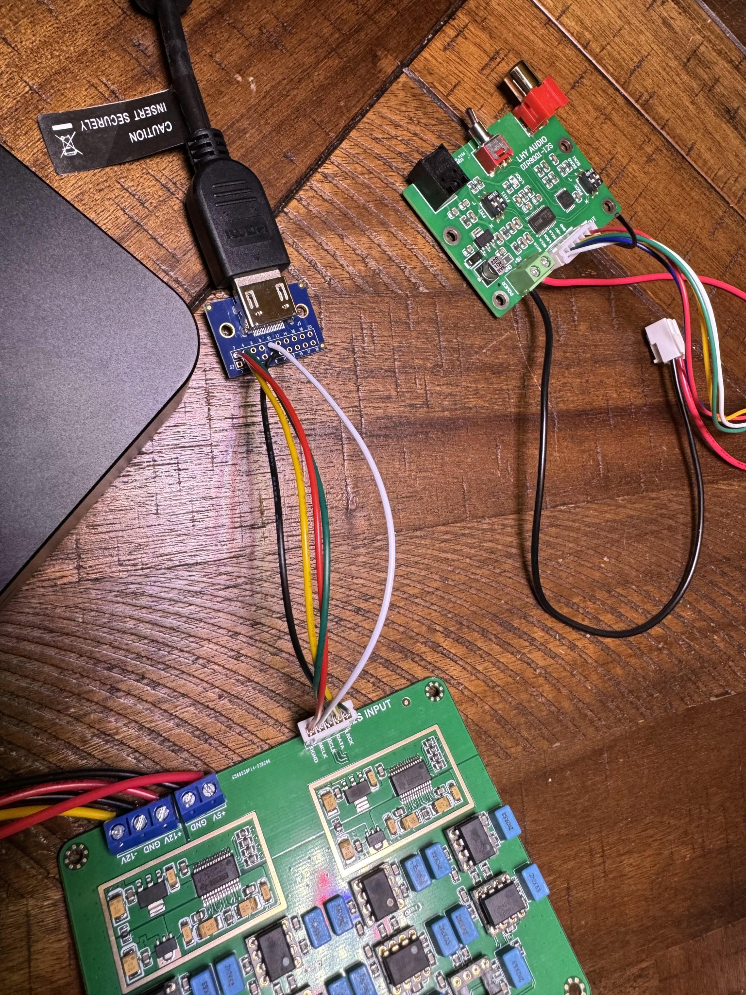

Hello,
I purchased a PCM1794 DAC from Aliexpress, and when using their bundled LHY AUDIO Coax-to-i2s converter board, it sounds wonderful
However, I'd like to feed it i2s directly via hdmi cable from my DDC/Reclocker - but when I try feeding it i2s directly, I get mostly static. The static goes away when I grab and hold the i2s lines, so I know they are hooked up correctly.

1. why does it work perfectly when I use the i2s output of the LHY AUDIO board? (the wires are the same length)
2. can I just solder in some 10 or 35 ohm resistors on the destination end (DAC side) of the wires? (I know that everyone says to put the resistors on the SOURCE side, but in my case the source is a DDC/Reclocker that sends out i2s over HDMI so I cannot do that)
Also I've read that people say you should alternate ground wires in-between your i2s lines, but how can I do that in this case, since the inputs are jumpers on the DAC board?

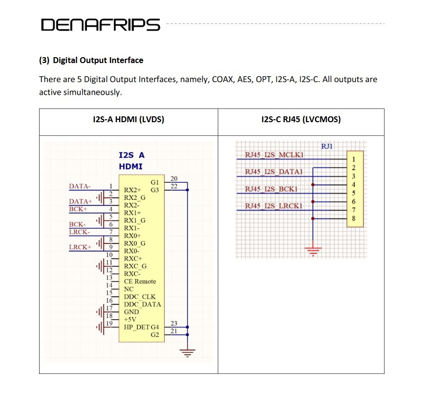

Are you sure there is no LVDS to CMOS converter missing? As far as I know, I2S signals are usually sent over HDMI cables as LVDS signals, while the DAC input probably expects 3.3 V CMOS levels.

I think we need to take a step back here. I was ignorant to what a "DDS/Reclocker" is and ran with Marcel's comment about LVDS.
Now I see what a DDS is, I think OP is just using an HDMI cable to carry I2S signals, not recover I2S from an HDMI LVDS output? Possibly with another simple HDMI breakout board at the other end? I think he should elaborate.
EDIT: I guess there are DDCs with HDMI LVDS outputs, like the Denafrips Iris. So what is the whole point of a fancy reclocker if converting from LVDS to CMOS level will just introduce more jitter?

The X-SPDIF 3 only has LVDS out for I2S so you cannot avoid a LVDS chip without modifying the box.I was planning on getting one of those Ian Canada boards, but there are so many to choose from that it looks like it will take quite a bit of research to figure it all out
