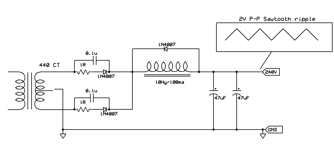

I am doing my best to fis up a friend's octal Aikido. The power supply needed some tlc, so I built a new one. It runs fine, but with an objectionable amount of 120Hz hum.
Put the scope on the power supply and I see a solid, waveform-perfect 2V sawtooth at the B+ point.
Here's the map - any ideas?

What does the sim in PSUDII predict? If it's much less than 2V, I would strongly suspect your grounding. Can you diagram how that was done?
PSUDII predicts a 2V P-P sawtooth on the C following the choke (fancy that!)
The question is, how do I get rid of it from the Aikido's output?
Signal grounding is star at the input jacks. Power grounding is on the chassis.

Well, you could put a regulator after the raw supply (that's what I did for the two Aikidos I built). You can also try nulling the noise- the voltage divider values for the nulling circuit that John suggests aren't exact and the adjustment to get a decent null is pretty sharp. So you can change one of them out for a resistor that's, say, 20% smaller than nominal in series with a trimmer that's, say, 40% of nominal, then have at it.
You clearly need smoothing capacitors on both sides of the choke.
Well, something 'more' , I'd think. One choke and one cap (94uF) isn't much filtering, especially for a preamp. Even old table radios and guitar amps had more filtering than that.

Excuse my ignorance, but what is supposed to be the purpose of the diode across the choke? This will bypass the choke on the downward swings of the AC, so destroying the whole point of a 'choke input' supply, by killing the choke current.

If you short out the choke you will get a 300V supply with similar ripple. Then RC smoothing can drop and smooth it, but it would have high DC impedance.
If you remove the extra diode you will get a 200V supply with less ripple, and probably a lower output impedance. You could boost the voltage a little by adding a small capacitor before the choke.

I'm still puzzled by the extra diode. Could someone tell me what they think it is supposed to do? As far as I can see, it gives the disadvantages of both a choke input and capacitor input supply at the same time. Each half cycle the choke starts from zero current, so you get a high output impedance. In what sense is this a good thing?

If I were to guess (and honestly, I didn't even notice it until you pointed it out), someone saw anti-kickback diodes used somewhere and decided that this would be a dandy way to protect his circuit from the evils of kickback.

You could be right! The operation of a choke input supply is a bit counter-intuitive, as it involves the current and voltage across the choke being in opposite directions for part of the cycle. Maybe someone read about the diode often needed across a relay coil and though that all inductors need one.

First off, cap before the choke - 47-100uF, then choke (with/without diode, I'd say take it out to try at least), then another cap. You could also try a RC after that again.
The other thing that you haven't mentioned at all is the heaters. If you are using AC heaters without a centre tap, then do wire in a pot (270-500R) with the in and out wired to heater +/- on the PCB and with the wiper tied to 1/4 to 1/3 of the B+. Adjust the pot to get lowest hum. Made a big difference on my octal aikido, which still hums a bit btw.

With a decent size reservoir cap before the choke it becomes a cap input PSU. Then the choke is merely a smoothing element with a voltage drop due to its resistance, so a reverse diode across it will do precisely nothing.
