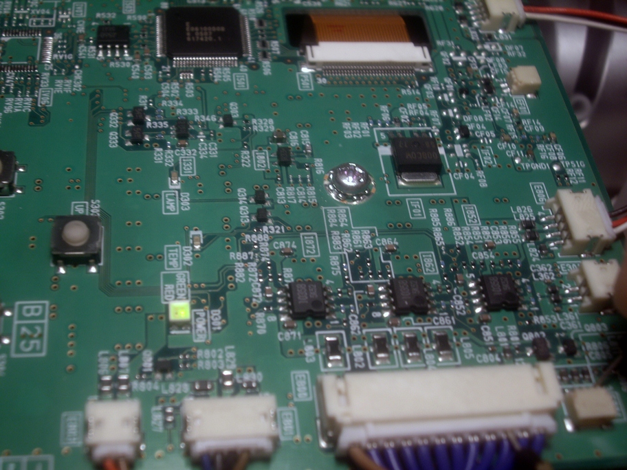

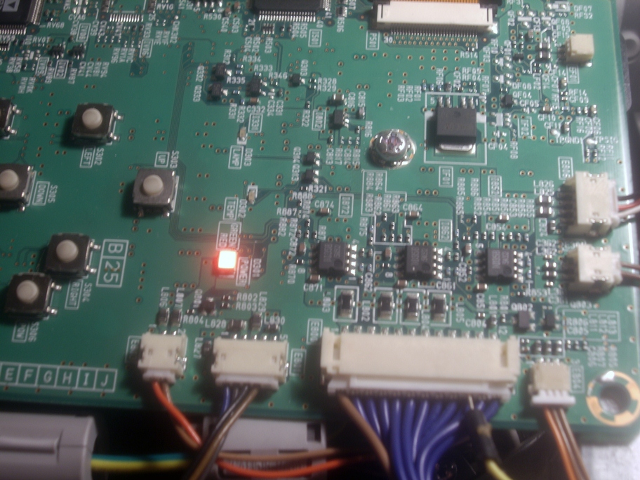

I have an old Hitachi CP-440 (hitachi-cpx440)but lamp blown up. So I was thinking about replace it with leds or whatever cheaper.

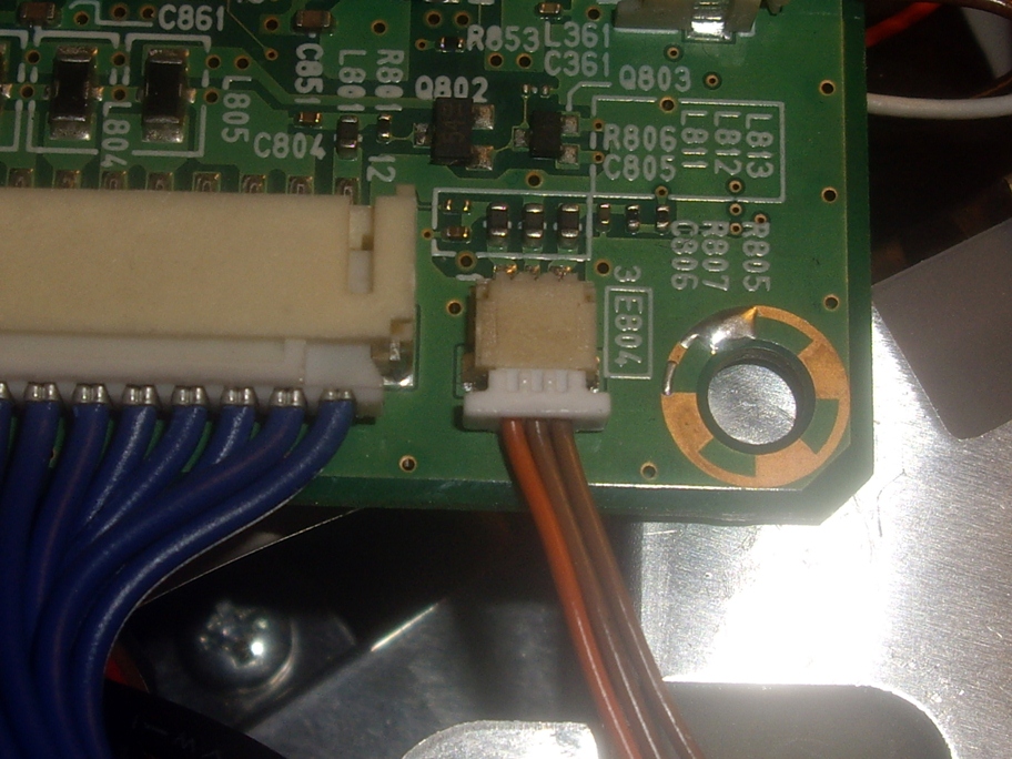

I have reading guides like Commercial Projector Ballast Bypass Guide and many others and I have located the group of wires that come from the ballast to the main board. (IMGP4711)
When I set rear power switch to "1" power led get red (standby), thats normal. Then, in order to measure the voltages, I power on the projector. Then:
Pin 1 (P ON/OFF/CNT) goes 15V (2 seconds) 0V (2 seconds) 15V...
Pin 2 (GND) 0V
Pin 3 (LAMP MISS) +-2V
As I understand this, Pin 1 send signal to power on the lamp, and should be a return in lamp miss saying lamp is on and is not missing or something like that, and this I guess means 0V.

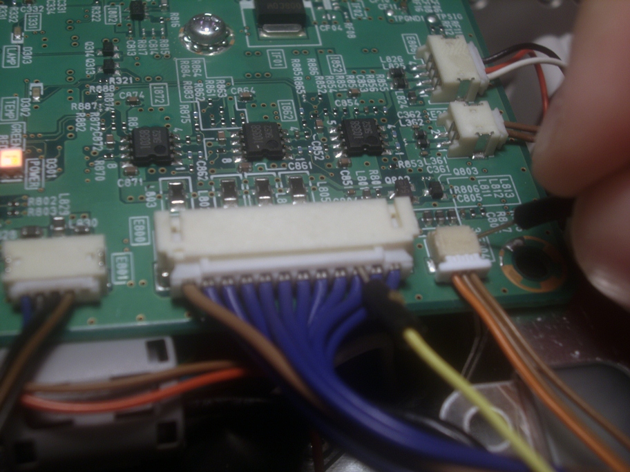

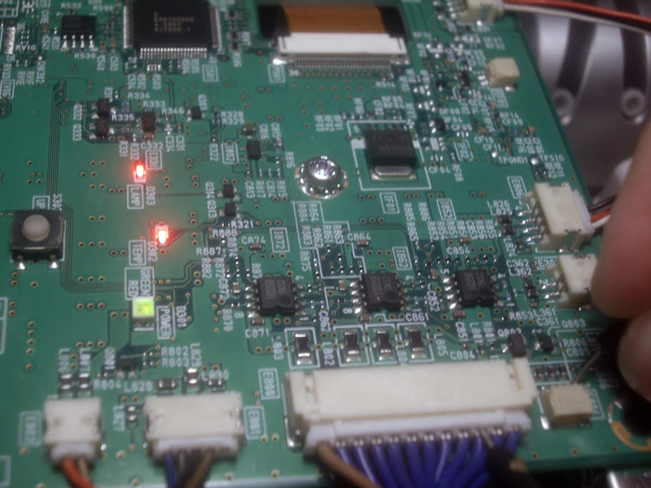

So as I read in some post, I disconnect thouse wires and connect Pin 3 to GND. When I do this in standby (without pressing power on button) fans start running( IMGP4716). After connect Pin3 to GND i press power on button in the main board and power led blinks green and then steady green, fine until now ( IMGP4717 - IMGP4718) But after some seconds Lamp and Temp led start blinking red (IMGP4719), which supposedly means:
"It is time to clean the air fi lter.
Please immediately turn the power OFF, and clean or change the air fi lter by referring to the section “Air Filter”. After cleaning or change the air fi lter, please be sure to reset the fi lter timer. After the treatment, resent the power to ON."
But air filter is clean and fans are running...

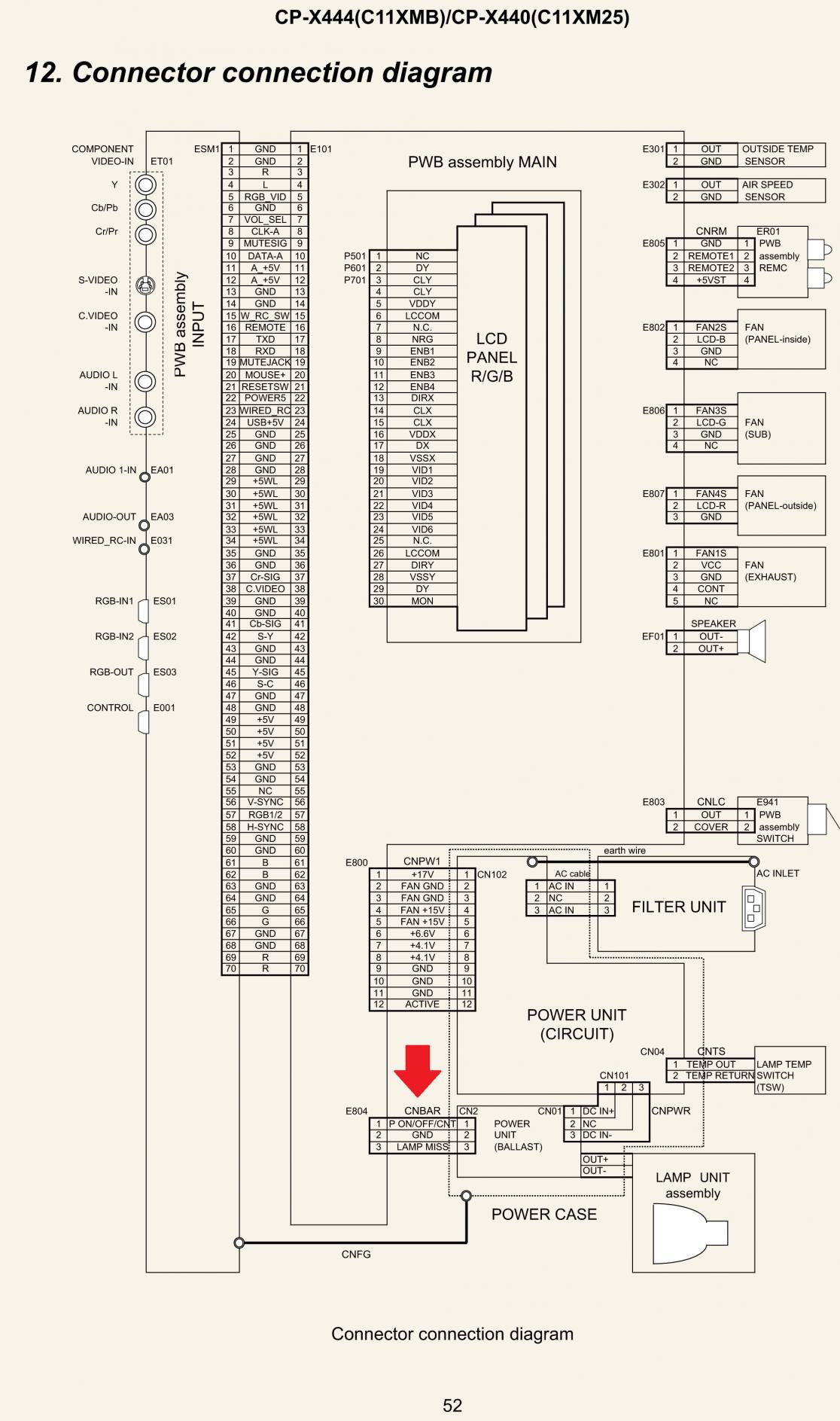

I have the service manual with all the schematics but unfortunately ballast one is illegible (Páginas-desdeCP-X444-(sm) )
Thank you!
