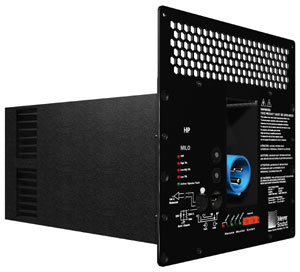

Quote from Meyer Sound site.
"MILO’s circuitry for the driver and output stages provides pure Class A operation. Four pairs of high-current, complementary V-FET transistors in each output channel provide 10 watts of pure Class A and 200 watts of Class A/B; the amplifier will only enter Class H operation during extremely loud musical passages. V-FETS are high-speed (72 ns Rise Time) and low on resistance compared to lateral FETS commonly used in audio amplifiers. "
Maybe they are using cheap modern ones ?.
Eric.
