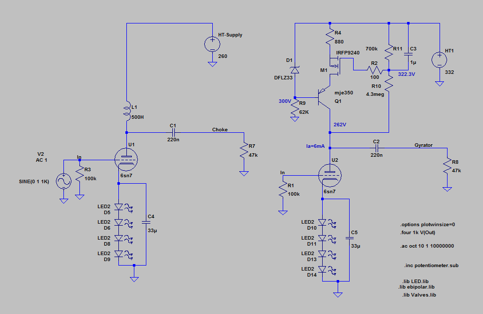

Hi all,
I'm in the process of optimising my 6J5 driver which currently has a CCS load.
Based on Wavebourn's circuit, I calculated the version to set the 6J5 at Va=260V and similar frequency response equivalent to a 150H ideal choke.
When I breadboarded the circuit, couldn't make it work. Although at some point I burned the LED array and got it biased properly by sheer luck. When I replaced back the LEDs, still couldn't make it work.
The PMOS is actually an FQP3P50, but couldn't find an LTSPICE model for it. I guess will have an impact on AC due to different capacitance, but should respond similar in DC? Haven't compared characteristics though....
The values I measured are in blue. Not sure about the value of the gate voltage as it's difficult to measure it with a voltmeter. When probe is connected it affects the impedance and then LEDs turn off until probe is removed - is this ok?
R11 is actually two 1M in parallel plus a 220K preset. R10 is two 22Meg in parallel.
The MJE350 emitter voltage should be at 324V, not the value highlighted.
Any suggestions where the problem could be?

Hi Ale,
The circuit (as drawn) can't work, I fear.
The LEDs will make the MJE circuit into a CCS only if the MJE350 can force about 324.6V on its emitter. With 316V on the emitter, the MJE350 will be degraded or destroyed, so you'll need a new one, sadly. See the specification for Veb(max), usually 6.0V.
Please post the Wavebourne original - I think the FET should be the other side of the MJE350 - to set the cascode voltage according to the stabilised voltage at the anode.
The most important omission is a resistor between the P-FET source, and the +ve supply. This sets the current for the triode's anode circuit.
The value is found from the voltage across R11 minus the Vgs of the P-FET, divided by the current you want to see in the anode. The voltage across R11 should be 10 - 20V for stable operation.
Next the cascode voltage needs to increase. This should be roughly (voltage across R11 + 10V), or 25 - 30V as a starting point. This will make sure the P-FET has enough headroom to stabilise the current.
If you omit the source resistor, the programmed current will be unstable, and always much larger than the triode can handle.
Concrete example:
If you adjust R11 to have 10V across it, and we assume the FET Vgs is 4V, then the source resistor must be 600 ohms to get 10mA, 300 Ohm for 20mA .. all the way up to 2000mA for 3 ohms! This will be independent of supply voltage. You can see that a source resistor of zero is not possible.
However, you will not get any current at all unless the MJE base is lower voltage than the FET gate - probably 10V lower, for stable results.
The simulation must work correctly even if the supply voltage is changed by 30V in either direction. If it does not, the circuit will not be stable in practice.

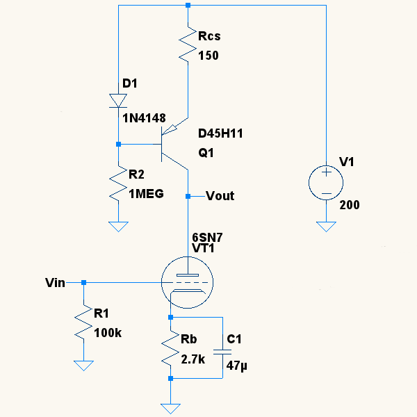

Not that great. Any uncompensated semiconductor CCS is going to drift all over with temp 🙁
Try a setup like the one I attached. Rcs sets the current through the tube, while Rb sets the bias, and hence the quiescent voltage across the tube. D1 compensates against temp changes, thus keeping the current relatively stable over temp. Do NOT use the D45H11 - I just picked it for an example. It doesnt have the voltage rating for this circuit. Pick a transistor with Vce equivalent to your supply voltage and with an hfe as high as possible (but NOT a darlington!).
You notice that I used a resistor in the cathode circuit rather than LED's. The reason is that diodes are essentially a fixed bias, which will make the circuit sensitive to the characteristics of the tube. This is a Bad Thing™. You want the circuit to be as insensitive as possible to variations between individual tubes (and semiconductors). That is why a resistor is used to set the bias, as well as in the emitter circuit of Q1 to set the current (rather than using a divider in the base circuit). Also, depending on the characteristics of the diode and transistor there may not be enough voltage across D1 to forward bias Q1. If that happens, add some resistance between D1 and the base of Q1 . Do not add another diode or a transistor with the base tied to the emitter of Q1 like you see in a lot of SS circuits as it will screw up the temp balance. You can replace D1 with another transistor identical to Q2 with it's base tied to it's collector. In that case the emitter goes to B+ and the collector to the junction of Q1's base and R2. Provided both transistors come from the same wafer lot it will give you the best thermal tracking.

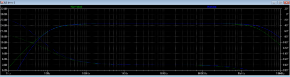

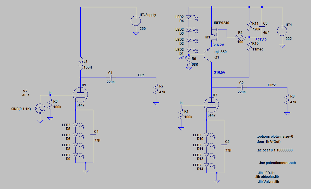

Hi Rod,
Thanks for the help. Attached is an updated simulation. Have changed the LED array for a simple 33V zener to get the cascode voltage down to 300V - if I got it right from your suggestion above. Added the source resistor to set divider voltage as recommended and get the quiescent current to around 6mA. What it puzzles me now is that I need to reduce significantly the capacitor to 22nF to achieve the LP corner at 15Hz equivalent to the 150H inductor. From what I was reading in the thread mentioned before, the value should be higher that 1u at least.
What is driving the low frequency response then?
Thanks again for the help, I'm learning a lot with all this!

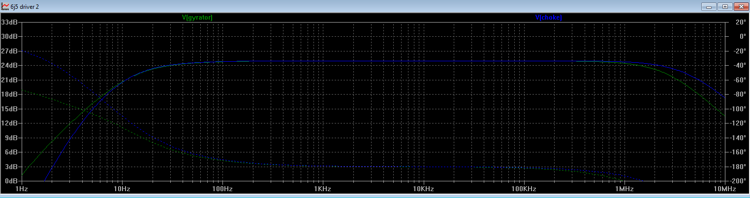

Very interesting comments. The gyrator in theory tackles the variation of valves and aging by setting a fixed voltage, not like the CCS which sets a fixed current.
I think that the 1uF is a good idea. The LF pole is formed from the M-ohm level gate resistors against the cap.
The 1uF is useful:
1. because the LF response can be lower, minimizing the risk of phase changes accumulating across all the stages in your system. This can be an advantage over the choke.
2. The 11M resistor is potentially too high. I know it simulates OK, but the gate leakage from a MOSFET can be as high as 1uA.... probably won't be but the high impedance can be a problem for other reasons. Anatolij used 4,3M elsewhere, and that seems safer to me.
Makes sense then to reduce it. See simulation attached. I guess that you would prefer a MOSFET with lower input capacitance as this will be in parallel with the capacitor and influence the frequency response?
With a 4.7Meg resistor and 1uF capacitor the response is nearly equivalent to a 500H choke! Nice...

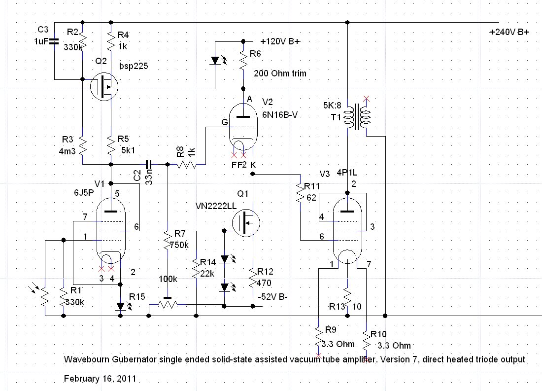

Maybe Anatolij (Wavebourn) is on holiday - I am surprised he has not appeared, and explained (and defended) his circuit.
It's pretty neat, actually. I hope he won't mind if I try to explain.
I think it is easier to understand its workings if we look at his Губернатор-7 (Gubernator-7) design. This is a robust design for Russian tubes 6Ж5П - 4П1Л (6J5 to 4P1L) SE power amp. It tolerates very well the wide variation between samples of the 6Ж5П - a useful feature for any amp.
The 6Ж5П stage uses the Gyrator circuit to automatically find an operating point. The anode voltage programmes the gyrator current (dc-only) through R2-R3. Meanwhile the cathode circuit is fixed-bias (~1,5V) - but this does not prevent the circuit from self-stabilising. You could pull out the 6Ж5П and use another one (with VERY different Ia-Vg1 characteristics) and the Gyrator will find a suitable operating point. The same process compensates for aging in the 6Ж5П - say for instance the anode current falls over time - the gyrator will increase the dc anode voltage to compensate.
At the same time, the fixed bias in the cathode eliminates the cathode capacitor - a well-known weakness in any design.
This is a very well designed circuit that gives EXCELLENT performance, perfectly stable dc operating conditions, high stage gain - and yet all the components are dirt cheap.
The version of Gyrator you are working with is cascoded, too, which may increase the performance (and power supply rejection) even further.
