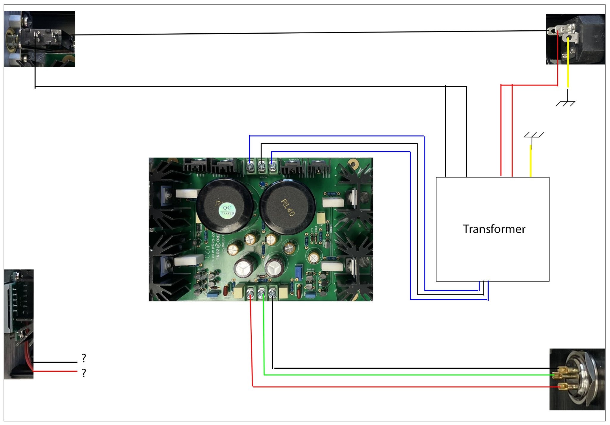

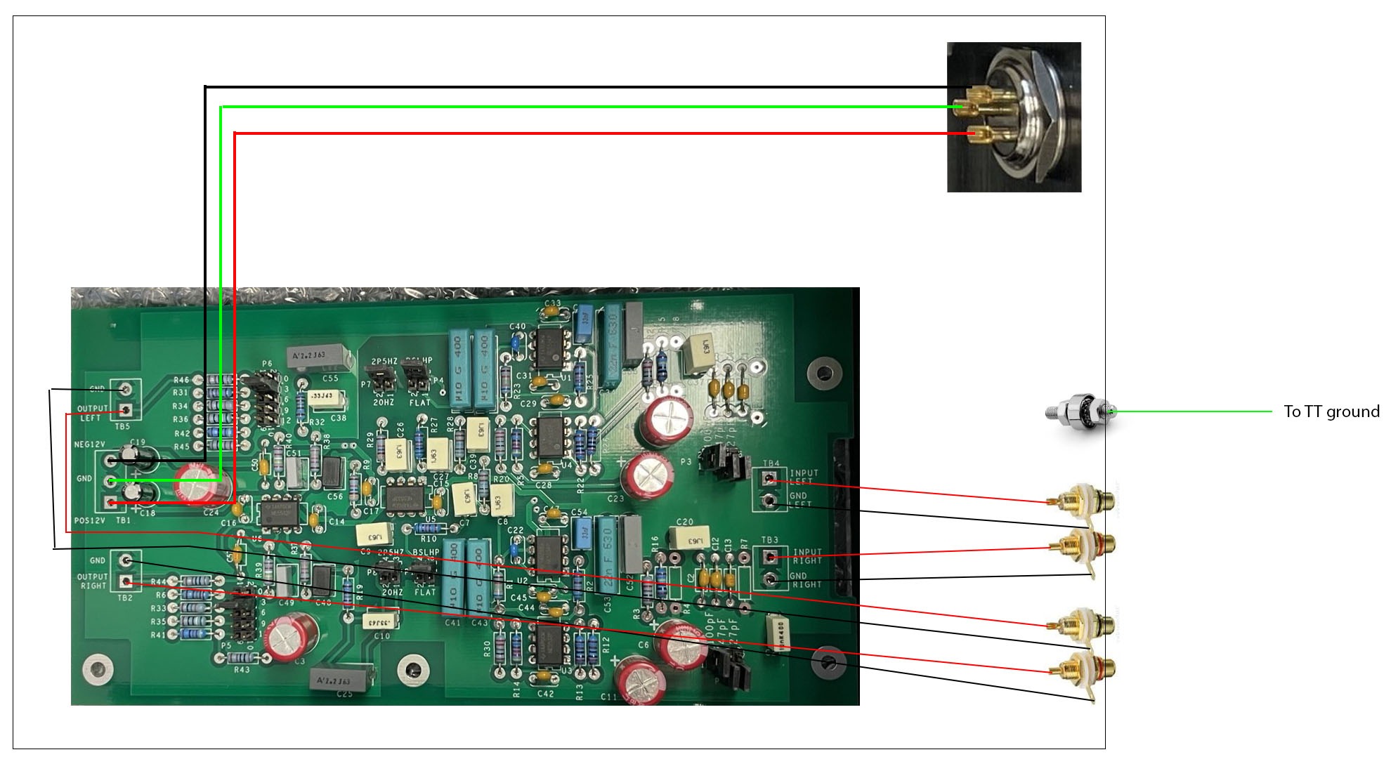

Alright everybody, finally was able to whip up some schematics. I have the PSU wiring/grounding all sorted (as far as I can tell, obviously please, as always, point out any errors of my ways), and I have the bulk of the preamp wiring sorted/figured out, I'm just still having quite a bit of trouble wrapping my head around the audio grounding aspect. Again, this is down to my incomplete knowledge of electrical engineering, and the use of confusingly similar terminology therein. I'll post the schematics below then discuss the possible ways of audio grounding I feel like are being described, and hopefully someone can point out which one is correct/mostly correct:
PSU:
Preamp:
Some notes first:
-Preamp audio inputs will either be directly attached to the board with a short bit of snipped resistor lead (per Akitika instruction) and mounted directly to the chassis (with nylon washers for isolation) or will use a short bit of shielded wire
-Preamp audio outputs will also be mounted to chassis with isolation and use shielded wire
-3 prong DC female jacks that are located on both PSU and preamp chassis have metal exterior and will be mounted directly to chassis without isolation, and their male plug counterparts are also metal on the outside, however obviously the 3-stranded, shielded wire I'll be running between them will not be conductive (though this could be used as a grounding connection between the chassis if I run a wire outside that touches from both male connectors' metal housing, if that's what is determined is something that is needed)
-The ??'s in the PSU are the red/black wires coming off the little LCD voltage readout screen, and I'm just wondering if those should go to the PSU board's red/black DC out posts, or its red/green DC out posts (assuming the former, but I didn't even know there was such a thing as 3-wire DC until I started looking into this so just goes to show you how much I know)
Now, onto the audio grounding:
I know I'll need something more than is what's here, but I'm not sure how "audio ground" differs (if at all) from "signal ground" as it seems like I'm being told to use the RCA grounds (either on the input or the output) to ground to the preamp chassis (with impedance), and that the preamp chassis should separately be grounded to the PSU chassis. Is this correct or wildly off?
If the above is correct, can I also put another grounding lug on the back of the PSU chassis and connect the lug on the preamp (that is also connected to the TT grounding wire) to it?
Based on the connections I see available, that's about the only possibility I can imagine, come to think of it, but it just seems wrong given the (what seems like) conflicting requirements to ground audio to chassis but also not ground signal to chassis.

PSU:
Preamp:
Some notes first:
Anyway, apologies again for my relative incompetence, and my sincere gratitude to anyone and everyone helping out with this. Thanks as always for your time.
This is quite a useful essay on grounding:
http://www.diyaudioprojects.com/Technical/Grounding-Shielding/
The mains ground goes to the metal chassis on all boxes.
Signal ground is kept isolated from the chassis, except at one convenient point (PSU connections on the PCBs?) where it can be 'loosely tied' via a parallel combo of:
120 Ohm
X2 capacitor 0.1uF-0.22F
I suspect the values themselves are non-critical, but the X2 designation is, as a mains ground fault remains isolated from the signal ground.
The 120 Ohm stops any ground loops having an effect, and also isolates from dirty mains grounds, I think.
120 Ohm
