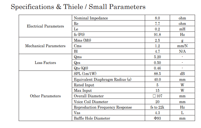

Good afternoon everyone. So this is the second set of drivers in this series that Fostex doesn’t really give a lot of info on the Thiele / Small perimeters for this driver. Am missing the following information?
1. Sd
2. RMS
3. Z
4. No %
5. RE
6. XMAX
So what can I buy to get this missing info I need? Here’s a picture from Fostex’s website. Thanks Jeff
1. Sd
2. RMS
3. Z
4. No %
5. RE
6. XMAX
.......or do the math and learn in the process 😉:
T/S Explained
T/S Equations and how each one affects the others
T/S Explained
Oops I missed that Re 🤦🏼. Oooo geezz. Thanks for seeing that for me.Re = 7.7 ohms. There's enough info to auto calculate Sd (WinISD for example). Xmax is probably .5mm. 🙂
